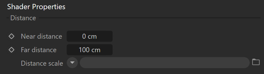

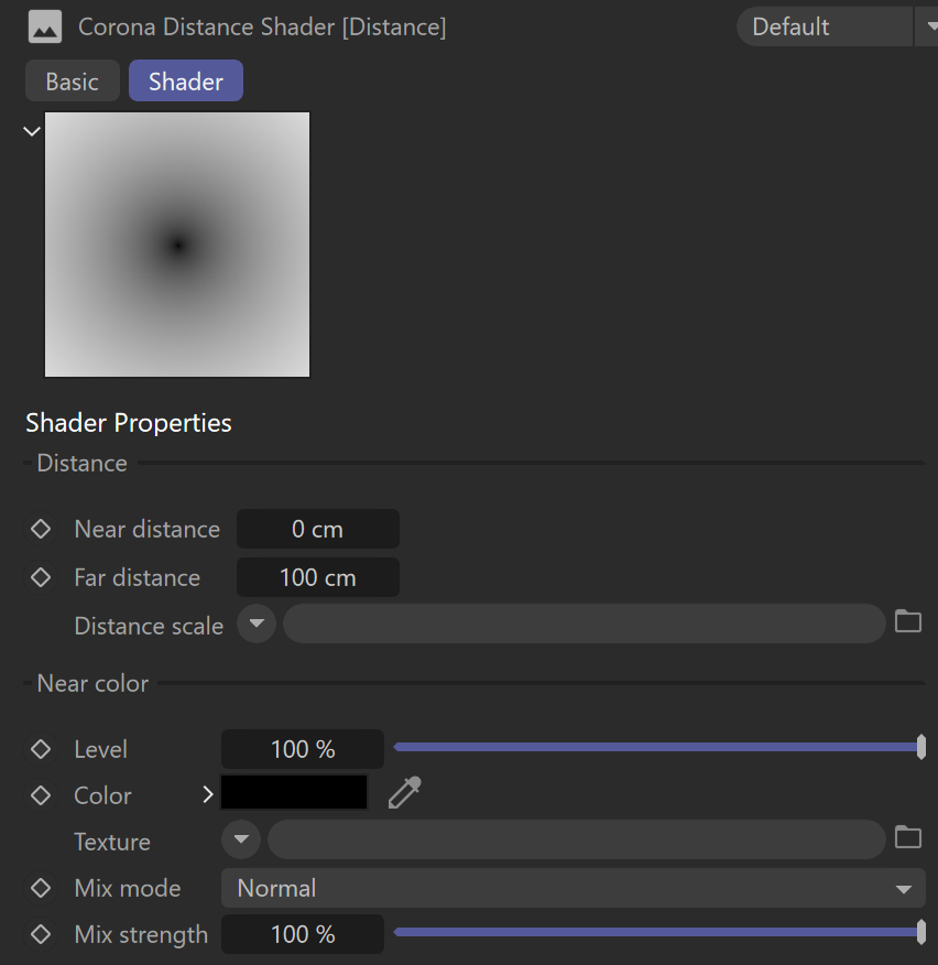

Distance
Near distance – When a surface of any objects included in the "Distance from" list is closer than the distance set here, a defined color or texture map is used. For distances between near and far, a blend between the near and far colors or texture maps is used.
Far distance – When all surfaces of any objects included in the "Distance from" list are farther than the distance set here, a defined color or texture map is used. For distances between near and far, a blend between the near and far colors or texture maps is used.
Distance scale – When used, both near and far distances are multiplied by the color values of the texture map or shader defined here. A value of 1 (white) means near and far distances are unchanged, while lower values reduce both near and far distances. Use this to add noise or variation to the distance calculations.

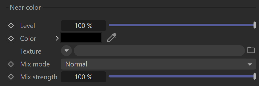

Near color
Level – This is the intensity (also considered as the visibility) of the color.
Color – This parameter defines the color used for the near-surface from the objects defined in the "Distance from" list.
Texture – Defines the texture map or shader that will be used for the near color.
Mix mode – Controls the blending mode of the texture map or shader.
Mix strength – Controls the intensity of the texture map or shader that is being used.

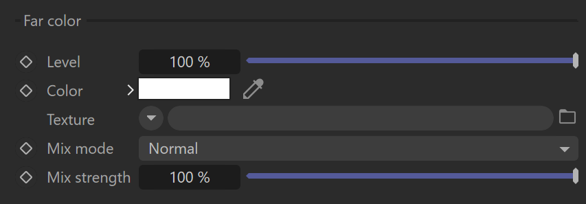

Far color
Color – This parameter defines the color used for the far-away surfaces from the objects defined in the "Distance from" list.
Texture – Defines the texture map or shader that is used for the far color.

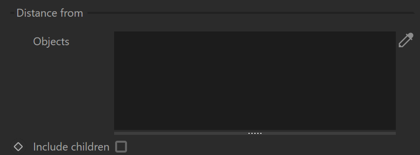

Distance from
Objects –  This object's list defines the objects from which the distance is being calculated.
Include children – When enabled, if the objects from the above list include nested objects, they'll also be considered as if they were already defined in the list.

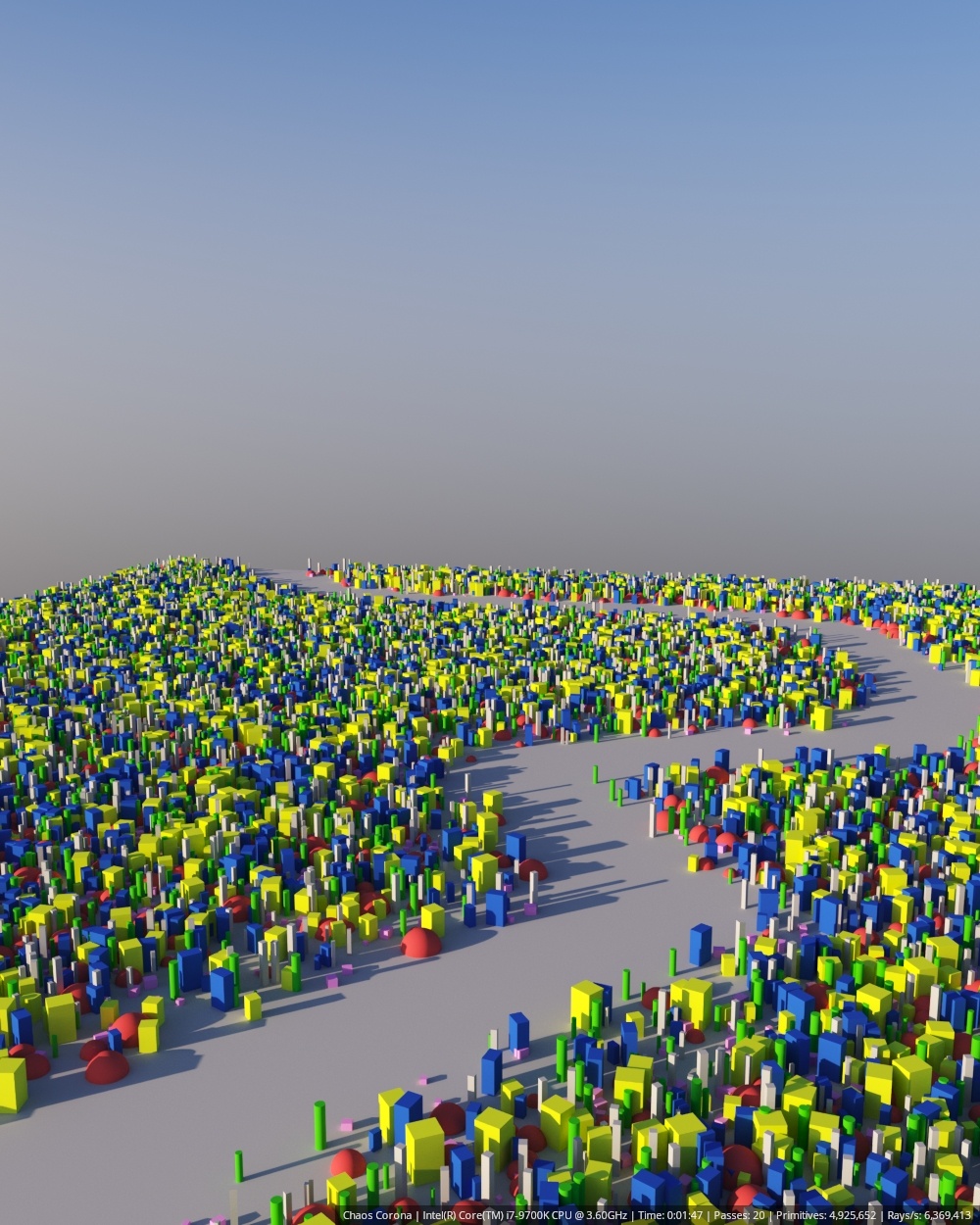

Differences between the Corona AO shader and the Corona Distance shader
There are some major differences between these two shaders:
  • The Corona Distance shader cannot be used within a single object
    The Corona AO shader can be used to colorize different parts of a single object or multiple objects based on their distance from each other (convex or concave areas). The Corona Distance shader can only be used based on the distance between two or more different objects
  • The Corona AO shader is raytraced, so it is computed only during the actual rendering process.
    This means that the Corona AO shader cannot be used, for example, as a distribution map to scatter instances using a Cloner or Scatter object, as a displacement map, or as a bump map. The Corona Distance shader can be used in such cases, and it will update in real time, even in the viewport
  • The quality of the Corona AO shader will improve progressively during rendering, so it first appears noisy and then gradually becomes noise-free with each subsequent render pass. The Corona Distance shader is computed in one go and immediately renders noise-free

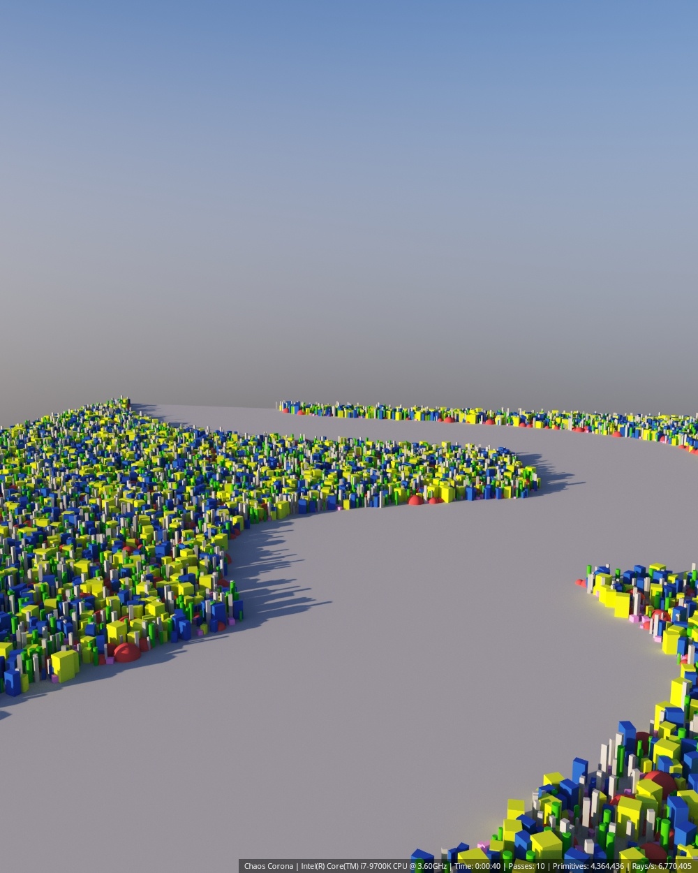

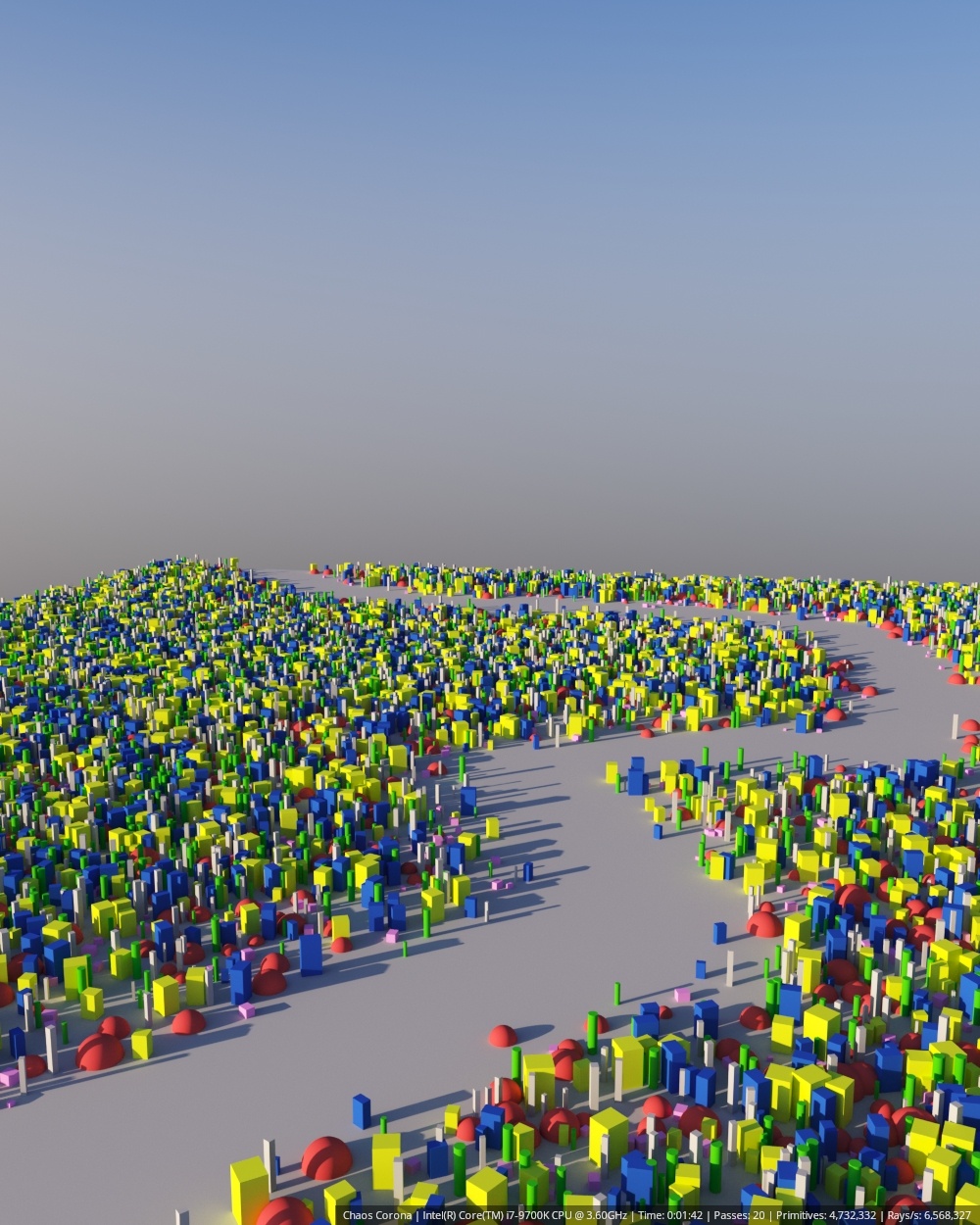

Distance Near
Distance Near: 0 (default value)
Distance Near: 250
Distance Near: 500
Distance Near: 1000
Distance Near: 2000
Distance Near: 4000

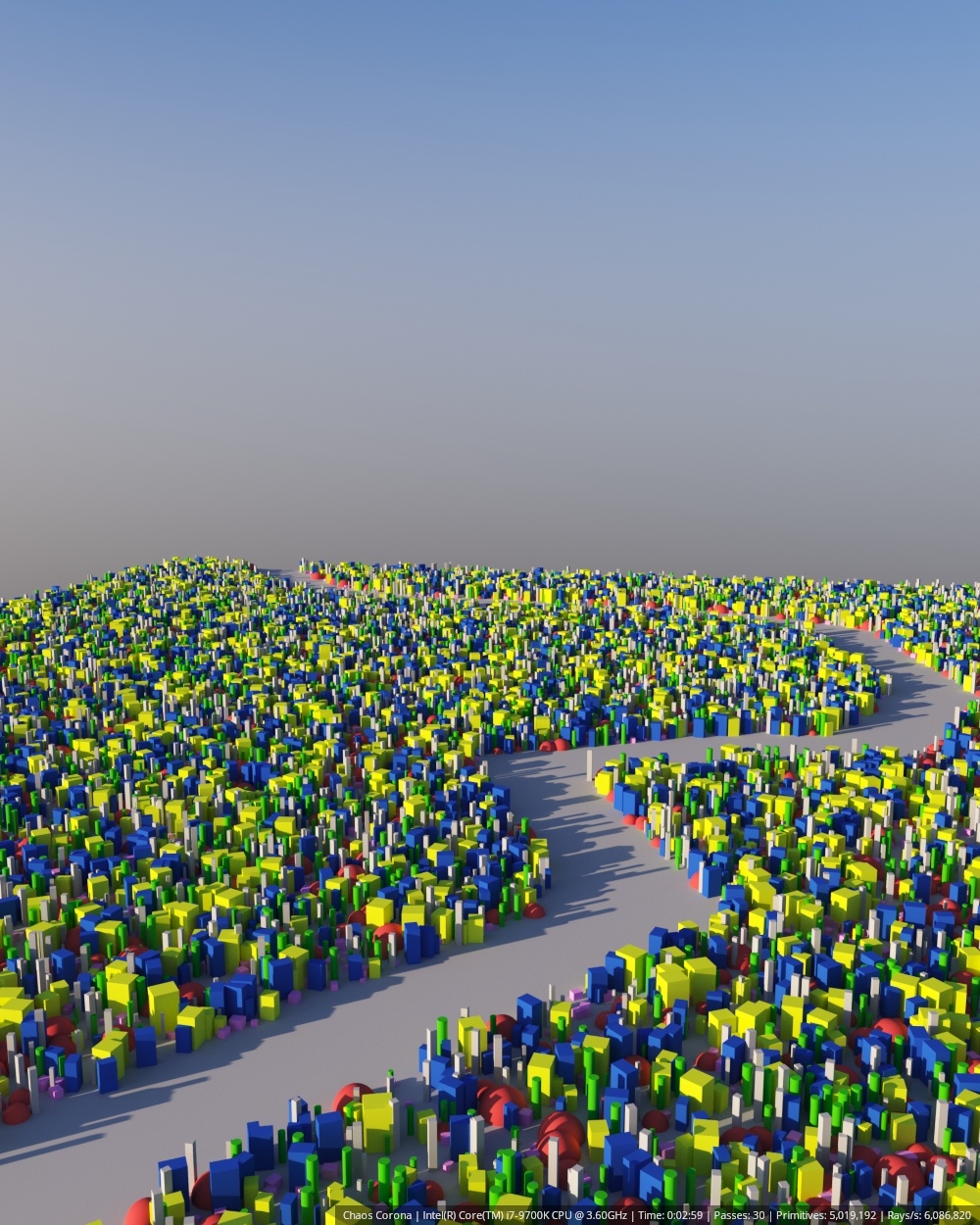

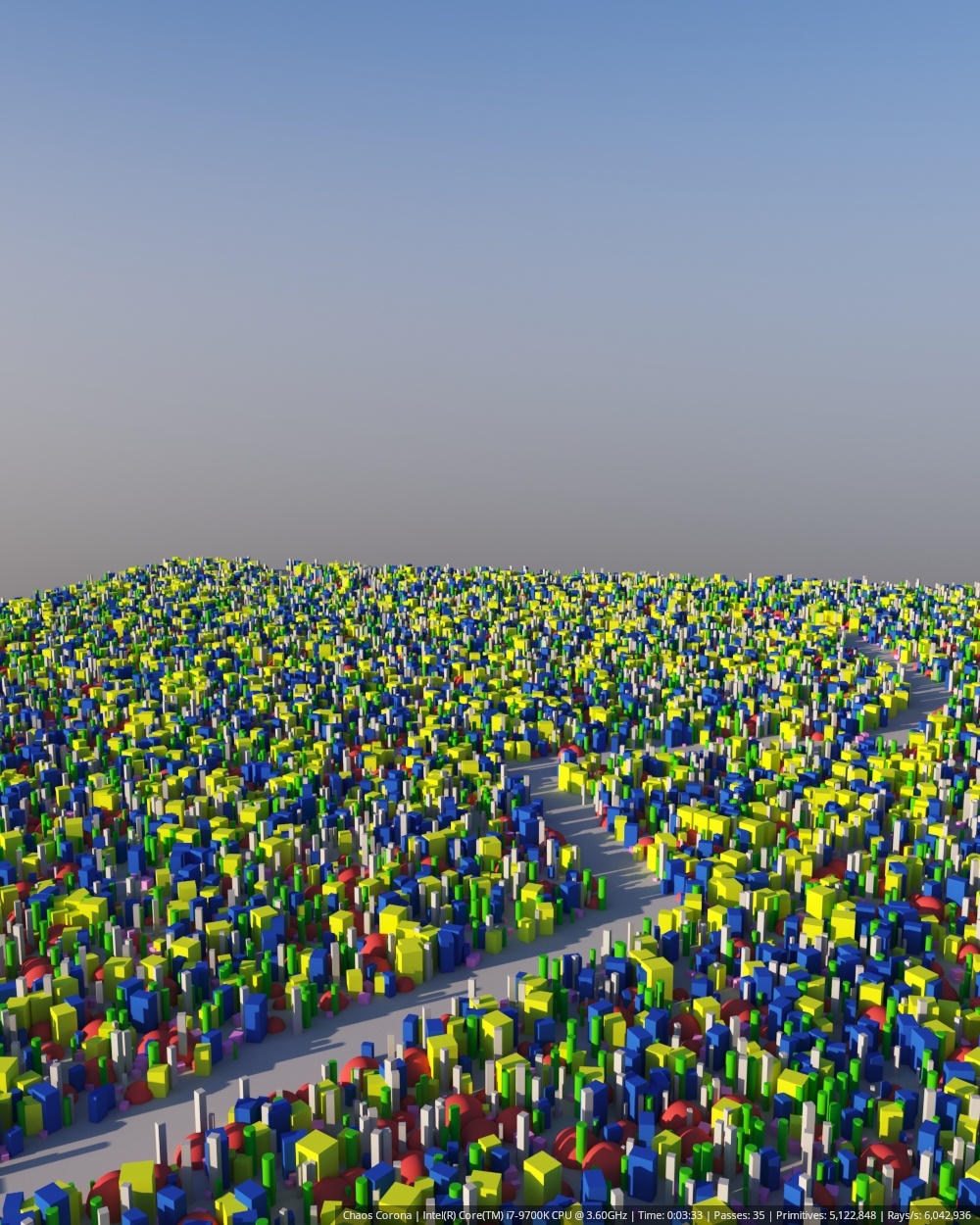

Distance Far
Distance Far: 0
Distance Far: 500
Distance Far: 1000
Distance Far: 2000
Distance Far: 4000
Distance Far: 8000
