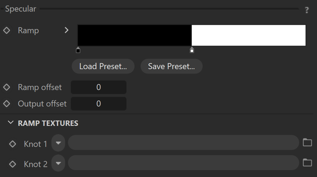

Specular Ramp
Ramp – Allows you to specify the knots and colors in the ramp.
Ramp Offset – Shifts the ramp input, as if the ramp keys are moved left.
Output Offset – Shifts the ramp output, as if the ramp keys are brighter colors.
Ramp Textures – Specify the texture maps for each knot created.

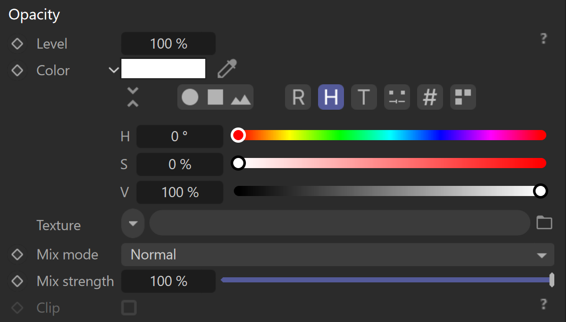

Opacity
Level – Both the constant color and the texture map are multiplied by this value. Setting this parameter to 0.5 or using a white color is equal to using 50% gray color, or using a texture map with output level of 0.5.
Color – Specifies opacity color, where white is opaque, and black is transparent.
Texture – Defines the texture map that is used for the material's opacity.
Mix mode – Controls the blending mode of the texture map or shader over the color.
Mix strength – Controls the intensity of the texture map or shader that is being used.
Clip – When enabled, Clip applies a threshold to the opacity map, so that everything below 50% gray is completely transparent, and everything above 50% gray is completely opaque. This option can speed up rendering significantly.
