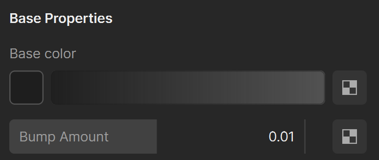

Base Properties
Base color – Specifies the base color of the material. Use a color or a texture, or use the slider to blend between the two. See the Base Color example below.
Bump Amount – Bump allows for adding map-based relief to the material surface. Add a Bump texture and use the Bump Amount slider to control the amount of bump. Larger values make the bump effect more visible, whereas a value of 0 hides it completely.

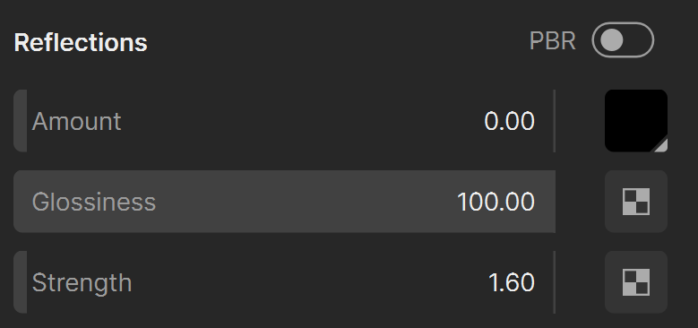

Reflections
PBR – Toggles the Physically Based Rendering (PBR) mode. When enabled, you control the material's reflection appearance using roughness and metalness parameters. When disabled – using glossiness and strength.
PBR mode disabled:
Amount – Controls the amount of reflectivity of the material. Set the amount using the slider, or via a color or a texture. A value of 0 or black means no reflectivity. A value of 100 or white means maximum reflectivity.
Glossiness – Controls the sharpness of reflections. A value of 1.0 means perfect mirror-like reflection; lower values produce blurry or glossy reflections. See the Glossiness example below.
Strength – Allows finer control over the strength of the reflections. Higher values produce more intense metallic-like reflections. When Glass is toggled off, the Strength parameter corresponds to IOR. When Glass is toggled on, the Strength parameter adjust the strength of the reflections independently from the IOR.

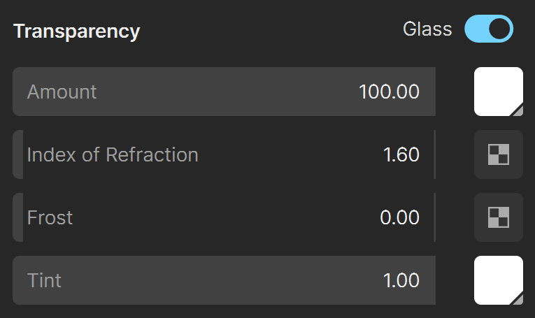

Transparency
Glass – Instantly makes the material glass.
Amount –Controls the refraction amount of the material, affecting its transparency. A value of 0.0 means that the material is fully opaque. A value of 100.0 means that the material is fully transparent. When using a color or texture, black color indicates no transparency, white means full transparency.
Index of Refraction – Defines how the material refracts light and how reflective it is. Typical values are 1.52 for glass and 1.33 for water. A value of 1 means that the light doesn't change direction.
Frost – Defines the glossiness of the material's refraction. Higher values produce a frosted glass look.
Tint – A combined color/texture slot that defines the color tint for the material's refraction. The slider controls the tint strength. Larger values increase the tint strength, making the material more opaque.

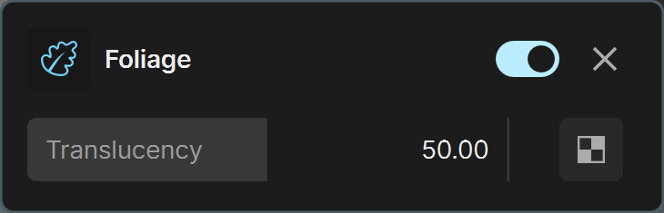

Foliage – Allows seeing the light on the backside of the objects. This enhancement is recommended for thin translucent surfaces such as foliages, but also paper, cloth curtains etc.
Translucency – Controls the translucency of the material. Higher slider values increase the translucency. If a texture is used, black color means no translucency, whereas white color means maximum translucency.

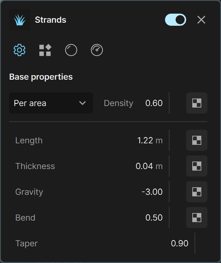

Strands
Strands – Adds strands to the material surface. See the Strands Enhancement example below.
Distribution – Specifies how the density of strands is determined when they are spread over the source object.
Per face – The number of strands is calculated per triangular face of the source object. Every triangle generates the specified number of strands. Smaller faces have fewer strands, larger faces have more strands. Every face has at least one strand.
Per area – The number of strands is calculated per squared scene unit.
Density – A multiplier for the strand density. A texture map can be used here. See the Strands Density example below.
Length Specifies the length of the strands. A texture map can be used here. See the Strands Enhancement example below.
Thickness Specifies the thickness of the strands. A texture map can be used here.
Gravity Controls the force that pulls strands down along the scene up-vector. Works together with the Bend parameter. A texture map can be used here. See the Strands Gravity example below.
Bend – Controls the elasticity of the strands. When set to 0.0, the strands are stiff and created as perfectly straight lines. Greater values cause the strands to bend (e.g. under the influence of gravity). A texture map can be used here.
Taper – Controls the taper of the individual strands. Increasing this value makes the tips thinner and the root wider.

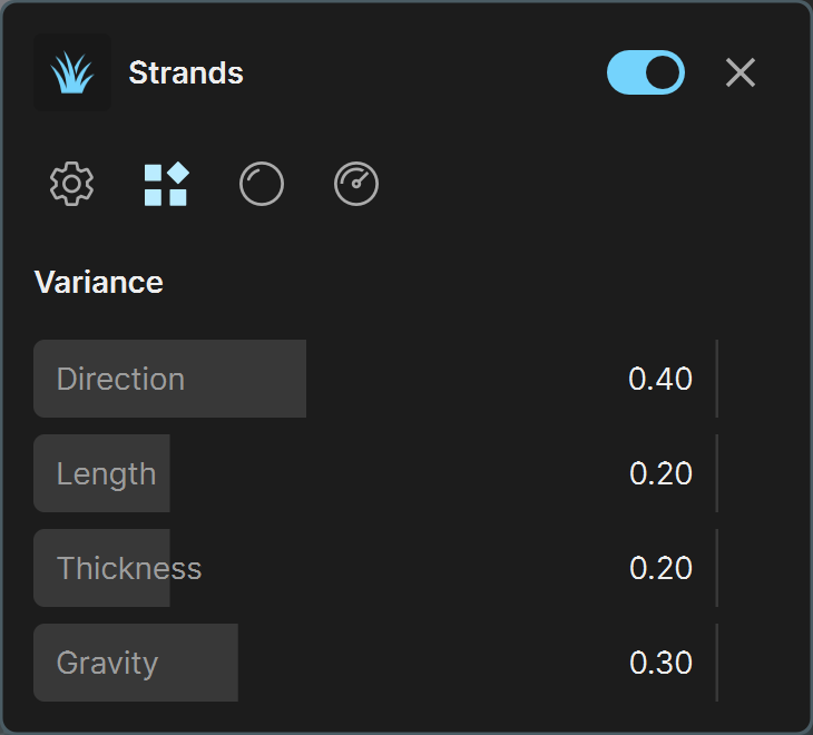

Variance
The settings in this tab allow adding variation to the corresponding strands parameters. Values range from 0.0 (no variation) to 1.0 (maximum variation).
Direction – Adds variation to the Direction parameter. Values range from 0.0 (no variation) to 1.0.
Length Adds variation to the Length parameter. Values range from 0.0 (no variation) to 1.0.
Thickness Adds variation to the Thickness parameter. Values range from 0.0 (no variation) to 1.0.
Gravity Adds variation to the Gravity parameter. Values range from 0.0 (no variation) to 1.0.

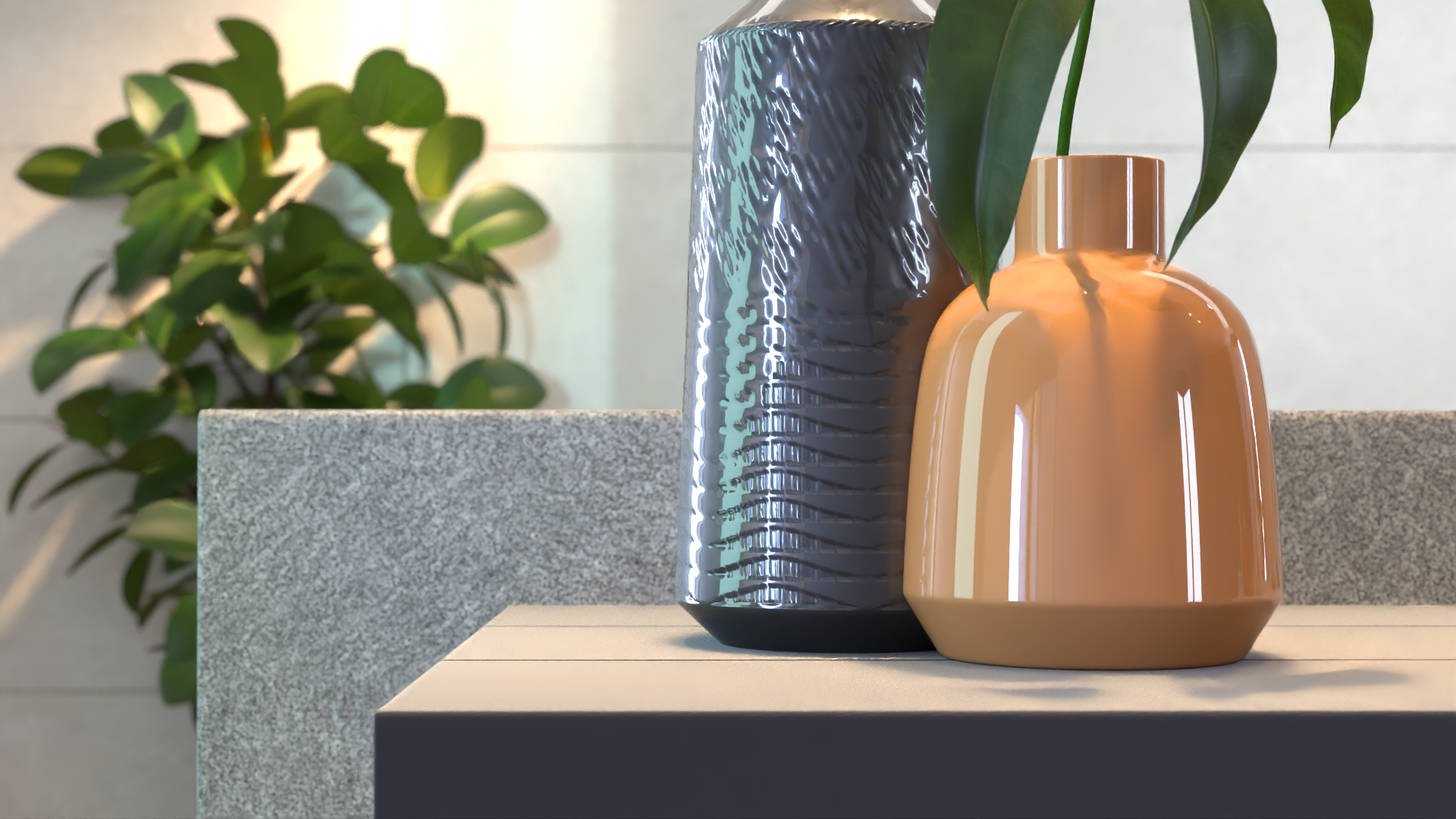

Example: Coat Enhancement
This example shows the effect of the Coat enhancement.

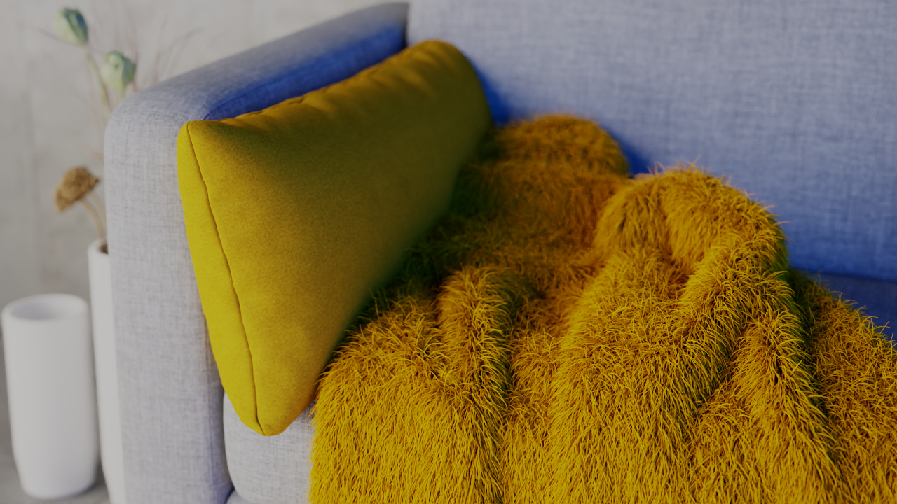

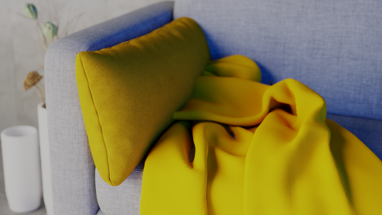

Example: Strands Enhancement
This example shows the effect of the Strands enhancement.
Coat is disabled
Coat is enabled, Coat Color is white
Coat is enabled, Coat Color is red

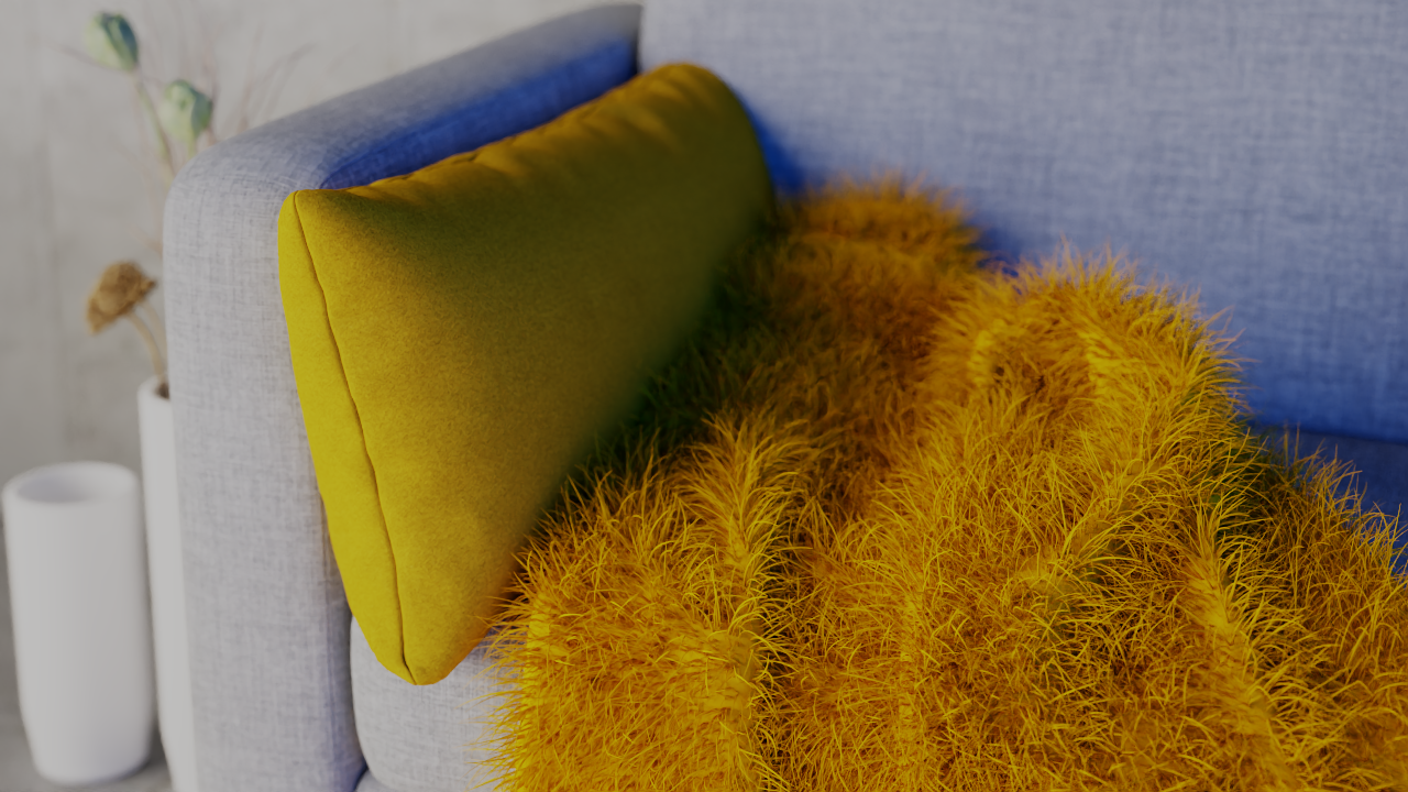

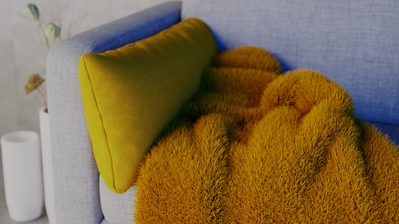

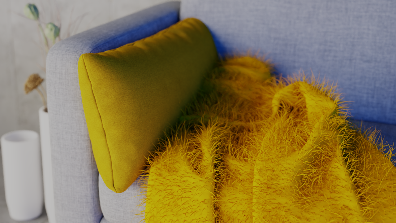

Strands is disabled
Strands is enabled, Length = 0.05
Strands is enabled, Length = 0.5
Strands is enabled, Length = 1
