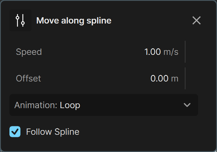

Move Along Spline
Speed – Specifies the speed of the file while moving along the spline.
Offset – Specifies the file's forward offset from the starting point of the spline, measured in scene units. Useful e.g. for making the animation start from the middle of the spline.
Animation – Specifies the behavior of the animation after being played. It can loop, stop, hide, or extrapolate.
Follow Spline – When enabled, the file aligns with the centerline of the spline, automatically following its path and maintaining the same direction as the spline.
