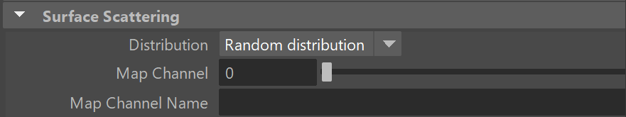

Surface Scattering
Column
width55%
The options in this rollout are active when the scattering mode is set to 2D - On Surfaces.
Distribution – Specifies the distribution mode of the objects.
Random distribution – This mode scatters instances randomly on all mesh objects. It is enabled by default.
UV Map – This mode uses UVW mapping to scatter instances in regular patterns.
Map Channel – Determines which UV map channel is used for the scattering when UV Map Distribution mode is selected.
Map Channel Name – Specifies the UV Map Channel name.

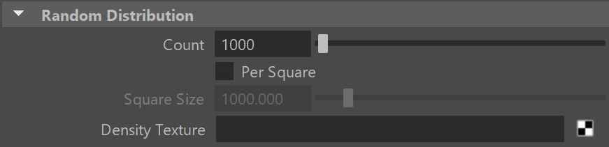

Random Distribution
Column
width55%
Count – Defines an exact number of instances to scatter - either overall, or per area in the case of scattering defined by density (Per Square option). The number is always limited by the Instance Count Limit option.
Per Square – When enabled, the number of instances to scatter is defined by density (Count per square having the given edge length). The number of instances is always limited by the Instance Count Limit option.
Square Size – The specified value is the edge length of a square defining an area for computing the scatter density. The length is measured in world units.
Density Texture 1 – Allows a black and white texture map to be assigned. The map determines how the instances are scattered on the surface.

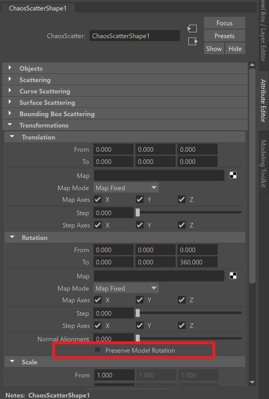

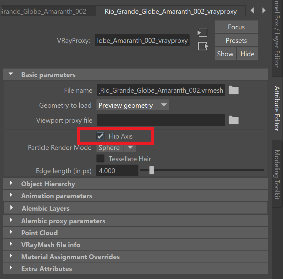

Edge Trimming V-Ray Proxy Files
V-Ray Proxy files are often created in other software, not Maya. This may result in their axes having a different orientation than the native Maya one. Having axes with a different orientation obstructs Chaos Scatter from trimming the instances properly. This is the case for all Chaos Cosmos assets and proxies created in V-Ray for 3ds Max. You need to adjust their axes if you want to scatter such proxy files and use Edge Trimming. To do so:
Fancy Bullets
typecircle
  • Go to the proxy object's attributes, and in the Basic Parameters rollout, enable the Flip Axis option.
  • In the Scatter Object's attributes, go to the Transformations rollout > Rotation and disable the Preserve Model Rotation option.

Enable the Proxy's Basic Parameters > Flip Axis

Disable the Scatter object's Translations > Rotation > Preserve Model Rotation option

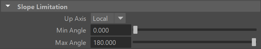

Slope Limitation
Column
width55%
Slope Limitation limits scattering only to 'slopes' at certain angles. It can be used to create realistic spread of trees on curved surfaces, for instance. The lower the Angle range is set, the smaller the angle at which scattering stops.
Up Axis – The angles are measured either between the Local Up Axis and the surface normal, or the World Up Axis and the surface normal. You can select which up normal to use:
Local – When enabled, the Slope Limitation is measured according to the up vector of each individual Targets object.
World – When enabled, the Slope Limitation is measured according to the world Y-axis up vector for all Targets objects in the scene.
Min Angle/Max Angle – Defines a range of angles to which the scattering is limited. Instances outside of this range get filtered out.
UI Text Box
typetip
When using the Local Up Axis, freeze the scale of the model.

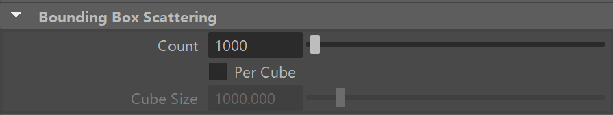

Bounding Box Scattering
Column
width55%
The options in this rollout are active when the scattering mode is set to 3D - In bounding box.
Count – Defines an exact number of instances to scatter - either overall, or per a volume in the case of scattering defined by density (Per Cube). The number is always limited by the Instance Count Limit option.
Per Cube – When enabled, the number of instances to scatter is defined by density (Count per cube having the given edge length). The number of instances is always limited by the Instance Count Limit.
Cube Size – Specifies the edge length of the cube defining a volume for computing scattering density (Count, Per Cube). The length is measured in world units.
