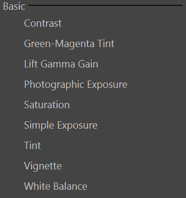

Contrast – The – The difference in brightness between light and dark areas of the image. Values greater than 1 increase the image contrast, and values below 1 decrease it. Value range: from 0 to 99.
UI Text Box
typenote
Applying this operator results in nonlinear output. When composing render elements together, this operator has to be disabled to get correct results; for example, when using multi-passes that split the output to reflection/refraction, only linear operations should be used before combining those elements back together.
Green-Magenta Tint – Applies green-magenta tint - the complement of temperature in white balance. Setting a negative value results in a magenta-looking picture, while a positive value leads to a greenish picture. The default value of 0.0 has no effect. Value range: from -1 to 1.
Lift Gamma Gain – Applies a Lift, Gamma, and/or Gain correction.
Lift – Makes the darkest parts of the image brighter or darker.
Gamma – Applies gamma correction to the whole image.
Gain – Makes the brightest parts of the image brighter or darker.
UI Text Box
typenote
Adjusting the Lift and/or Gamma values results in nonlinear output. When composing render elements together, this operator has to be set to the default value of 1.0 to get correct results; for example, when using multi-passes that split the output to reflection/refraction, only linear operations should be used before combining those elements back together.
Adjusting only the Gain value maintains the linear workflow.
Photographic Exposure – Changes the overall exposure of the image based on the settings of the currently used camera.
Saturation – Controls the overall image saturation. Positive values increase image saturation; negative values decrease it. Value range: from -1 to 1.
UI Text Box
typenote
Simple ExposureChanges the overall exposure of the image. Value range: from -20 to 20.
Tint – Sets the overall color tint of the scene. The entire image is multiplied by this color. This can be used both to add and remove color tint from the image. To add a tint, just select the color of the tint directly. To remove tint from any rendered object, pick its color using the "pick inverse" eyedropper in Corona Improved Color Picker.
Vignette - Simulates real-world camera vignette by darkening the edges of the image. Value range: from 0 to 10
White BalanceSets the white balance point using Kelvin temperature, often used in photography. Lower temperature leads to a bluish, cold appearance of the image, while higher temperature leads to a warm appearance. Value range: from 2000 to 99999.
UI Text Box
typeinfo
 By default, the following Tone Mapping operators are used for every Corona Camera Tag as a starting point:
Fancy Bullets
  • Simple Exposure
  • White Balance
  • Green-Magenta Tint
  • Contrast
  • Saturation
  • ACES OT
