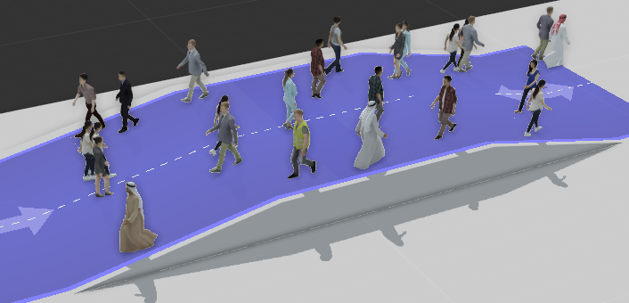

CREATE PATHS ON A SLOPE OR UNEVEN TERRAIN
  1. Add a geometry background that includes uneven terrain or ramps.
  2. To create characters on ramps of uneven terrain you would use exactly the same procedure to draw a path over them and start selecting the Crowd Path tool.
  3. Then click on the 3d viewport to define the starting point of the path and keep clicking to add additional points.
  4. For complex terrains, you may find that adding additional points might give you a more accurate projection of the walkway onto the surface.
  5. Right-click / ESC to finish the drawing.
