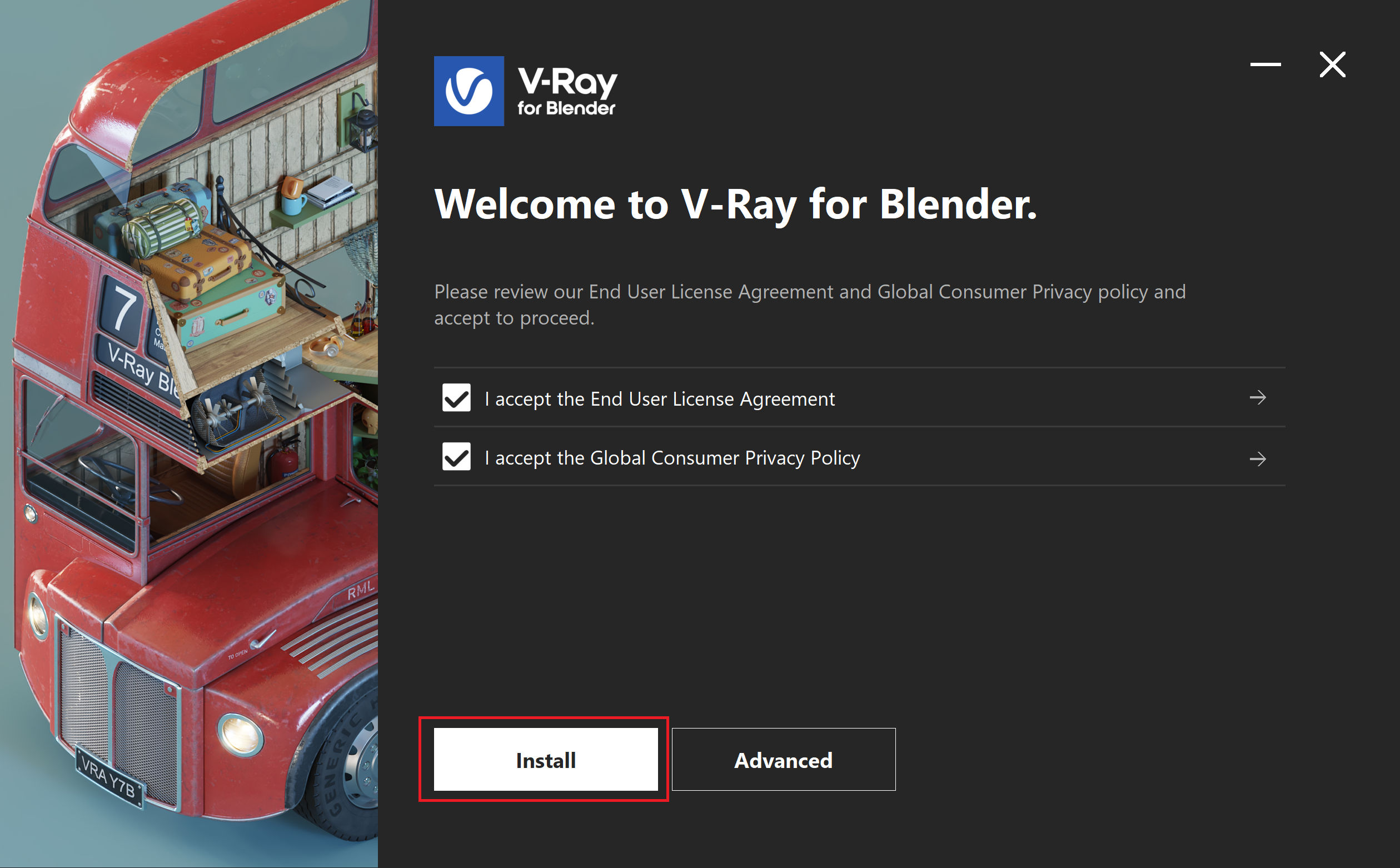

Welcome
Once you've carefully read the License Agreement and the Privacy Policy, check the boxes next to them, if you agree to the terms.
Proceed to click the Install button and wait for V-Ray to complete the process.

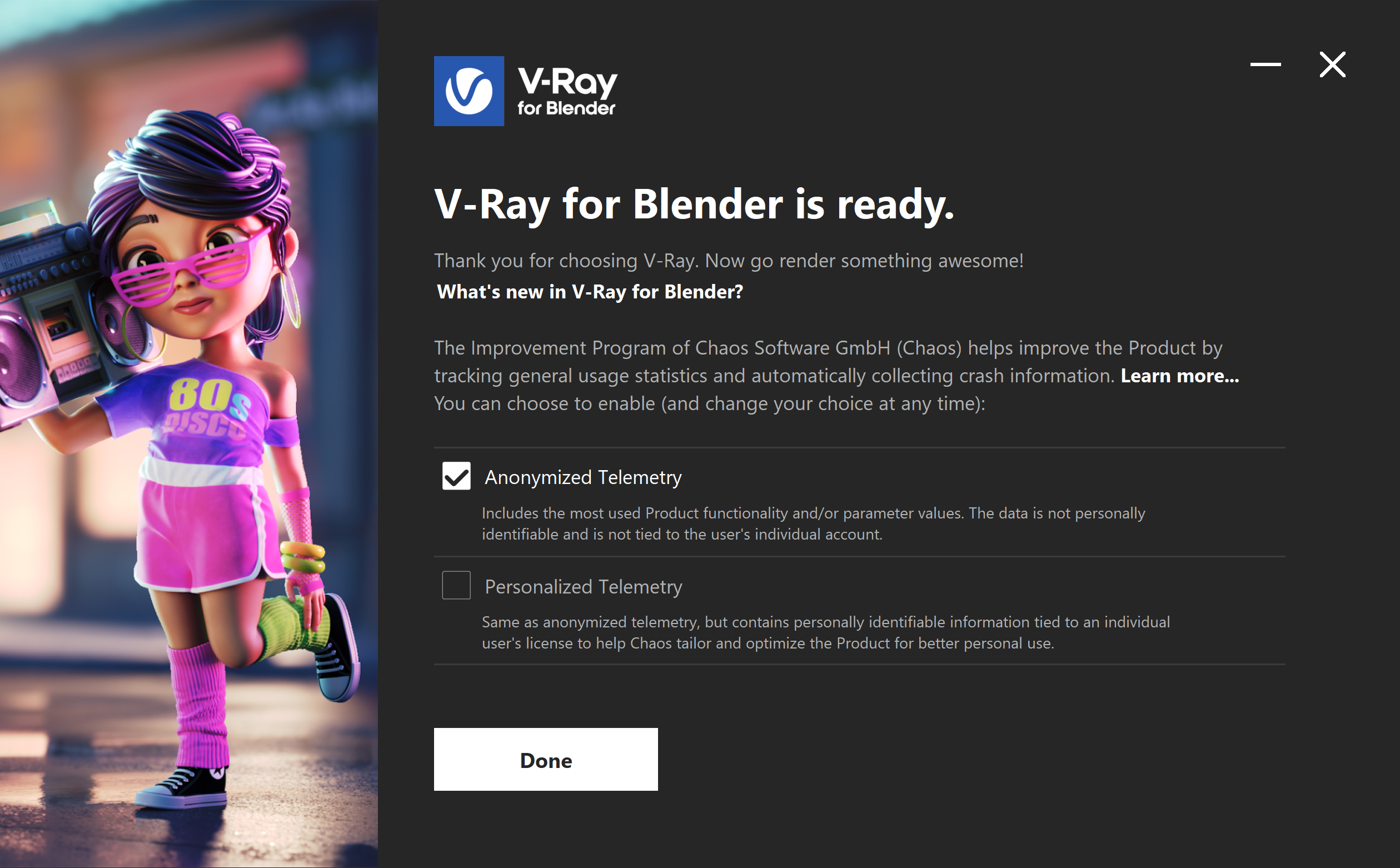

V-Ray installation is successful.
Participate in the improvement decisions for future versions of V-Ray. When agreeing to participate in the feedback program, no intelligence property is violated. Chaos does not gather scenes, assets, materials, etc. This preference can be changed anytime from within the interface. For more information, see the Chaos Telemetry page.
Anonymized Telemetry – Includes the most used product functionality and/or parameter values. The data is not personally identifiable and is not tied to the user's individual account.
Personalized Telemetry – Includes the most used product functionality and parameter values but also contains personally identifiable information tied to an individual user's license. This helps Chaos tailor and optimize the product for better personal use.

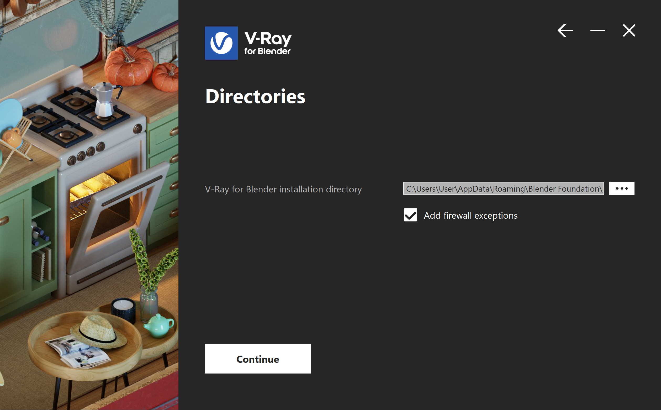

Directories
Here, you can specify the installation paths. Please check if the default folders are correct.
Add firewall exceptions – Enabling this option allows the default licensing port (TCP 30304) in the firewall. If you disable it at this step, you will need to manually add firewall exceptions later.
