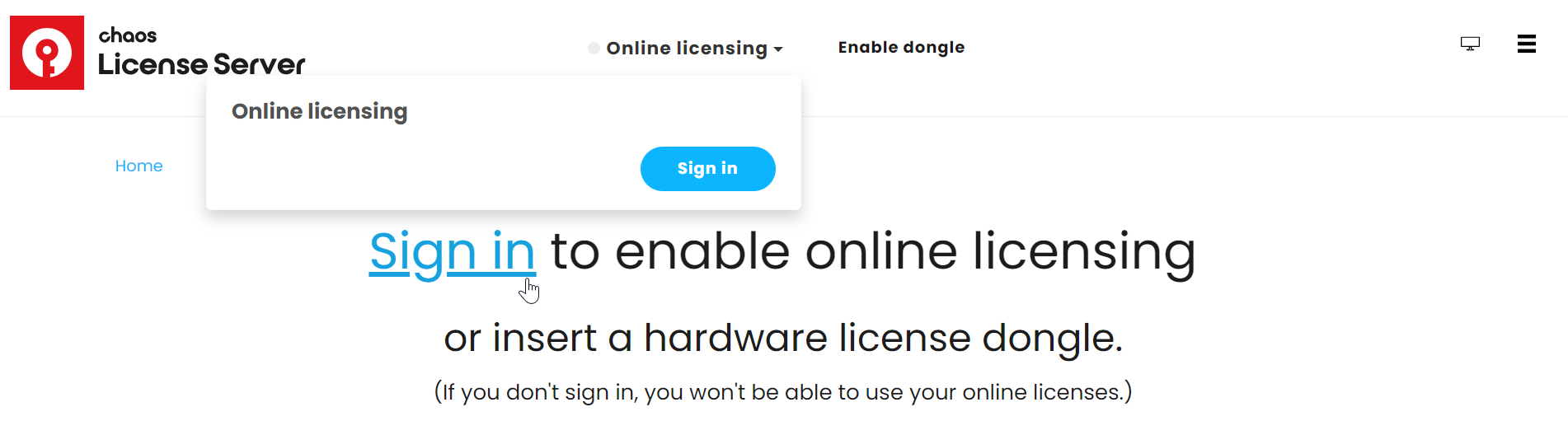

After the installation is complete, you are redirected to the Chaos License Server's Interface. If you are not signed into a Chaos account, go to the Online licensing dropdown menu and select Sign in.
Image Removed
You are then prompted to enter your username/email and password.
Once the activation is successful, you are able to see the list of your available licenses on the Chaos License Server home page.
