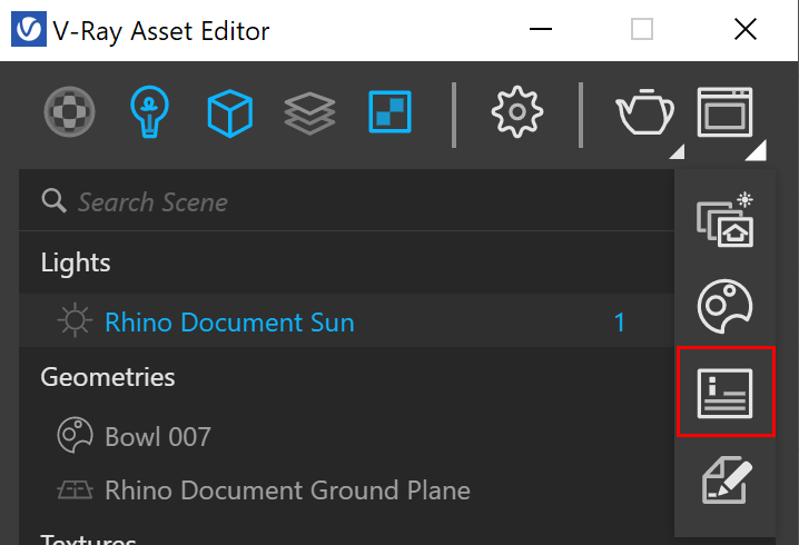

V-Ray Log Window collects and displays messages from the Asset Editor.

 ||V-Ray Asset Editor|| > Open V-Ray Frame Buffer (dropdown menu) Open V-Ray Log
Image Added

titleUI Path: Asset Editor > V-Ray Log Window button
