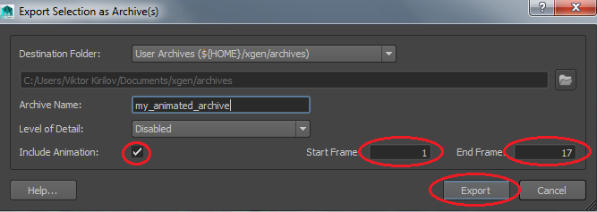

XGen can export an archive with animation within it from the export menu as shown below:
Image RemovedImage Added
As an example here is the cookie monster with its eyes animated for 26 frames:

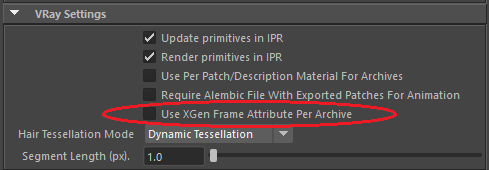

To make each archive instance be in a different frame of it's inner animation you can use
XGen Frame attribute from
the Primitives
 tab of the XGen window - you can put an expression like rand(0,10)
 or $frame.
You will also need to enable
the Use XGen Frame Attribute Per Archive
 option from
the Preview/Output
 tab of the XGen window.
