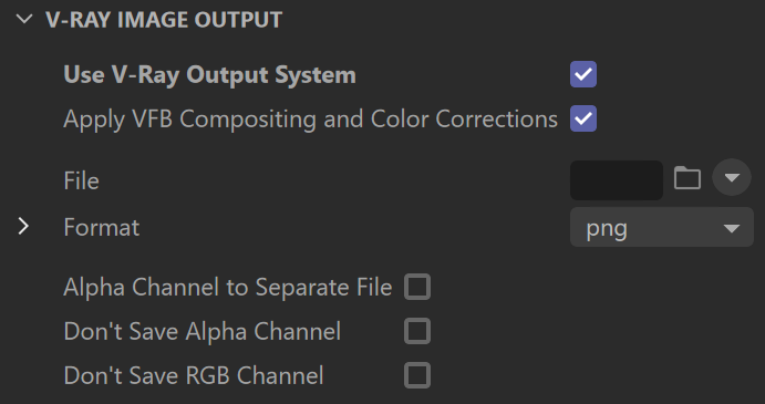

V-Ray Image Output
Section
Column
width55%
Use V-Ray Output System – When enabled, you can use V-Ray to set the output image format of the render. Unlike Cinema 4D's output options, V-Ray can output deep .exr and .vrimg files.
UI Text Box
V-Ray Output System is not compatible with Cinema 4D Team Render.
Apply VFB Compositing and Color CorrectionsEnable this option to save all applied VFB color corrections to the RGB channel of the output image. This does not apply to the sRGB, Gamma 2.2 and  and ICC display corrections. OCIO, LUT and Background Image corrections are saved if this is explicitly specified in their VFB rollouts.
File – Specifies the name of the file to be saved.
Format – Specifies the file format in which the image is saved. Expand to see more options.
Alpha Channel to Separate File – When enabled, the alpha channel of the rendered image is saved to a separate file.
Don't Save Alpha Channel – When enabled, the Alpha channels is not saved (ignored with multichannel exr and vrimg).
Don't Save RGB Channel Output When enabled, the RGB channels Determines how the color channel outputs are treated.
Output All – Outputs all color channels.
Skip RGB – The RGB channel is not saved (ignored with multichannel exr and vrimg

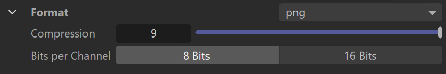

PNG
Compression – Allows you to choose compression level for the resulting file. Lower values mean less compression and larger file size. Higher values mean more compression and smaller file sizes. Note that PNG files use a lossless compression, so the resulting image quality is not affected.
Bits
Section
Column
width55%
PNG
Bits per channel – The number of bits for each of the PNG channels (red, green, blue, alpha).

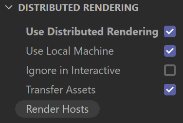

Distributed Rendering
Section
Column
width55%
For more information on distributed rendering with V-Ray, see the Distributed Rendering page.
Use Distributed Rendering – Enables additional parameters and settings needed to distribute the rendering across additional computers. Note: The distributed_render_hosts.json file stores the settings information for your DR setup. By default, it is located in C:\Users\Username\AppData\Roaming\Maxon\Maxon Cinema 4D RXX_XXXXXXXX\plugins\vray\.Use Local Machine – The client/local machine functions as a render server along with the other computers used to complete the rendering task. Disabling it means that all rendering is done on other machines apart of the DR set up.
Ignore in Interactive – When enabled, Interactive only runs on the local machine rather than the whole distributed rendering network.
Transfer Assets – Allows render servers to automatically download missing render assets from the client machine,   including textures, V-Ray proxy files, IES profiles, GI solution caches (irradiance maps, light caches), etc.
Render Hosts – Opens the V-Ray DR settings window.

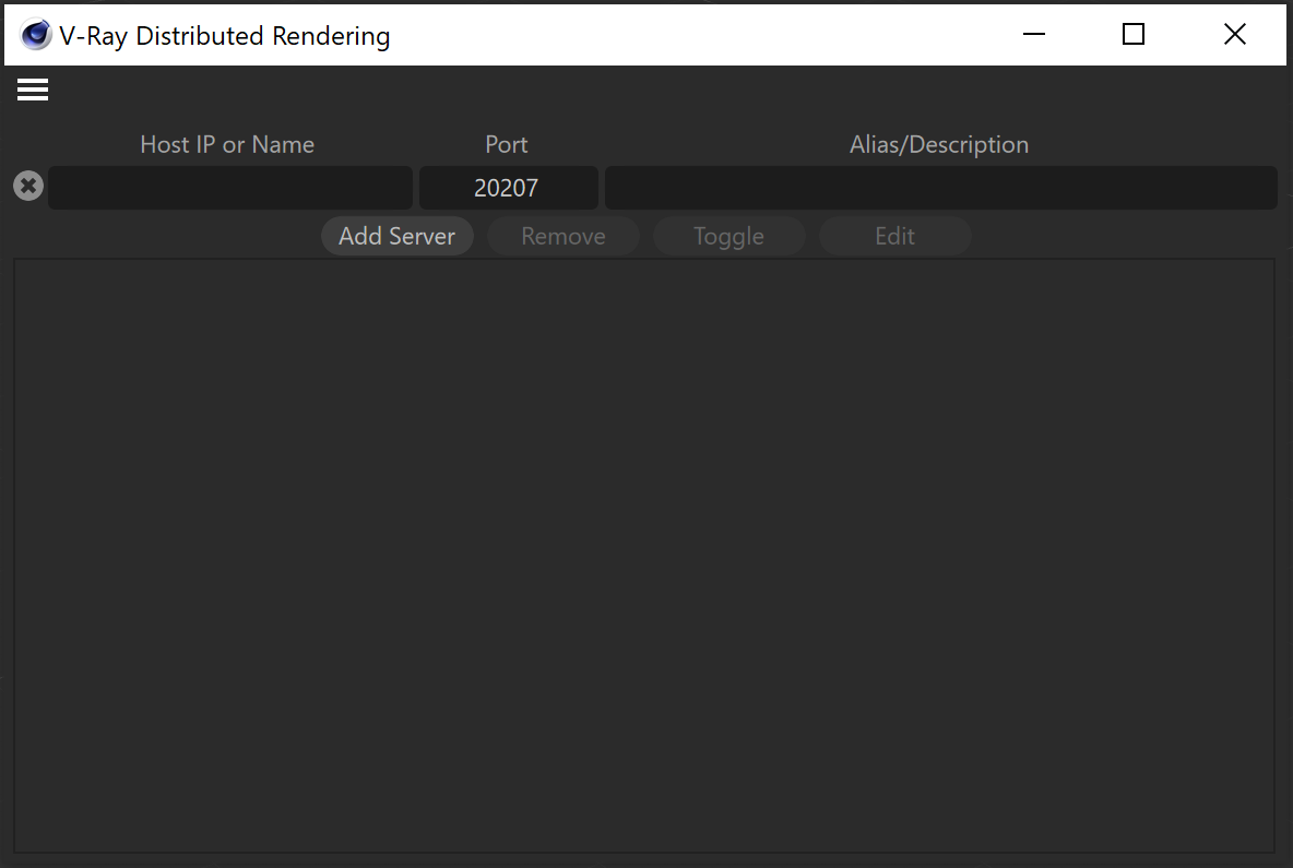

Render Hosts
Section
Column
width55%55%
These options set up the machines that V-Ray uses for Distributed Rendering.
Render on Local Machine – The client/local machine functions as a render server along with the other computers used to complete the rendering task. Disabling it means that all rendering is done on other machines apart of the DR set upThese options set up the machines that V-Ray uses for Distributed Rendering.
Host IP or Name – A text field to enter the name or IP address of the machine to use as a DR server.
Port – Specifies the port number where the DR server operates.
Alias/description – A text field to place notes about the particular DR server.
Add server – Allows a manual way to add a server by entering its IP address or network name.
Remove –Deletes the currently selected server(s) from the list.
Toggle – Toggles the state of the selected server(s) between enabled and disabled.
Edit – Modifies the information for the selected entry in the list.

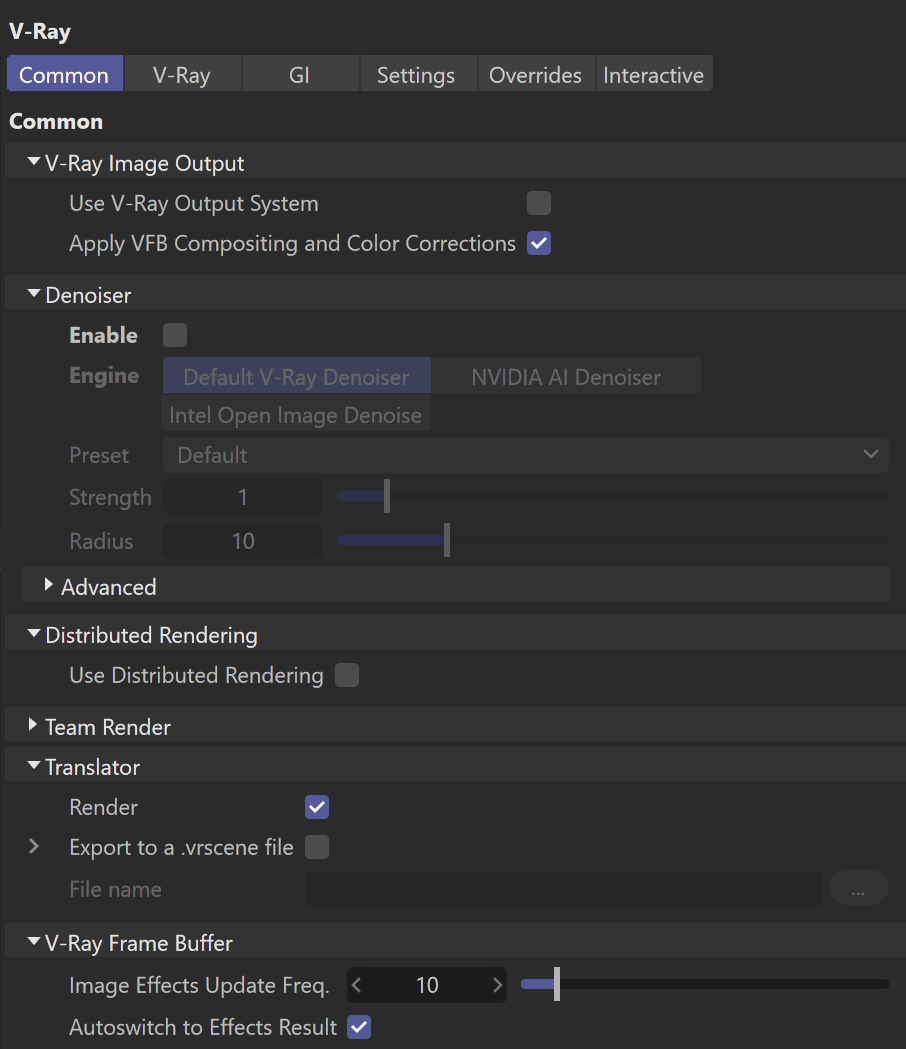

Translator
Section
Column
width55%
Render – Enables V-Ray to render the image in the Frame Buffer and then save an image file, as specified in the Common tab of the Render Settings window. This option can be used at the same time as Export to a .vrscene file.
Export to a .vrscene file –  Enables V-Ray to export the scene to a .vrscene file and expands the options in the rollout. For more information on the .vrscene export, refer to the Exporting V-Ray Scene Files page.
Separate files – When enabled, V-Ray exports separate files for different components of the scene. This also allows you to disable export for certain types of objects.
Each frame in separate file – When enabled, V-Ray makes a separate file for each rendered frame.
Strip paths – When enabled, the paths for assets (bitmap textures, proxies, GI caches loaded from file, etc.) are removed from the exported file and only the file names of the assets remain.
Write mesh data in hex format – When enabled (the default), the mesh data is written in hexadecimal format in the .vrscene file. This makes the files smaller and faster for processing, but less readable to a user. When disabled, the mesh data is written in normal decimal format.
Write transform data in hex format – When enabled (the default), transform data is written in hexadecimal format in the .vrscene file. This makes the files smaller and faster for processing, but less readable to a user. When disabled, the data is written in normal decimal format.
Compressed – When enabled, basic compression is applied to the .vrscene file. This option can only be used together with Write mesh data in hex format.
Export Lights – Enable/disable the export of lights. Available when the Separate files option is enabled.
Export Nodes – Enable/disable the export of nodes. Available when the Separate files option is enabled.
Export Geometry –  Enable/disable the export of geometry. Available when the Separate files option is enabled.
Export Materials –  Enable/disable the export of materials. Available when the Separate files option is enabled.
Export Textures –  Enable/disable the export of textures. Available when the Separate files option is enabled.
Export Bitmaps –  Enable/disable the export of bitmaps. Available when the Separate files option is enabled.
File name – Specifies the location and name for the .vrscene file.
