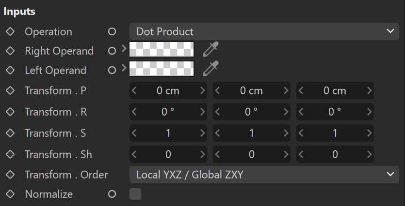

Operation – Specifies the type of operation to perform with the two vectors:
No operation – Does not perform an operation.
Dot Product – Performs a dot product operation and returns the resulting scalar.
Cross Product – Performs a cross product operation and returns the resulting vector.
Vector Matrix Product  – Performs a vector matrix product operation and returns the result.
Point Matrix Product  – Performs a point matrix product operation and returns the result.
Right/Left Operand – Determines the two vectors that perform the operation.
Transform . P – Specifies how to position the map.
Transform . R – Specifies how to rotate the map.
Transform . S – Specifies the scale of the map.
Transform . Sh – Specifies a shear for the map.
Transform . Order – Specifies the order of prioritization of the rotations.
Normalize – When enabled, the output vector is normalized. When the Operation is set to Dot Product, the input vectors are normalized before the operation.
