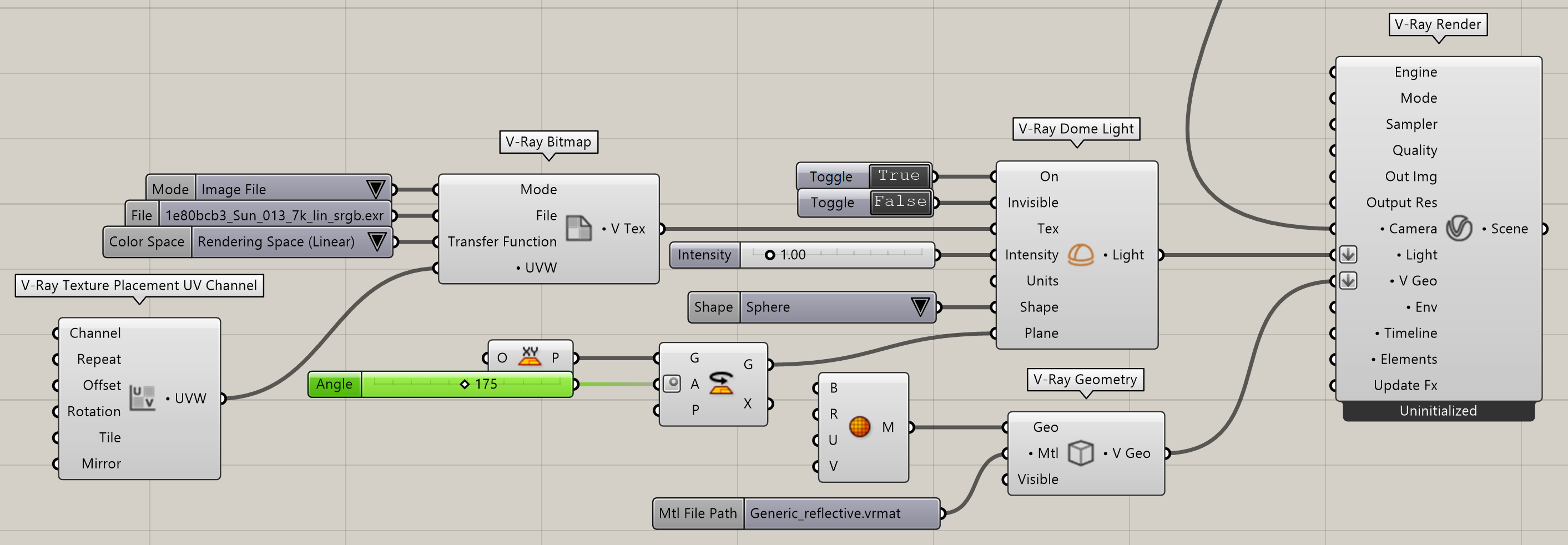

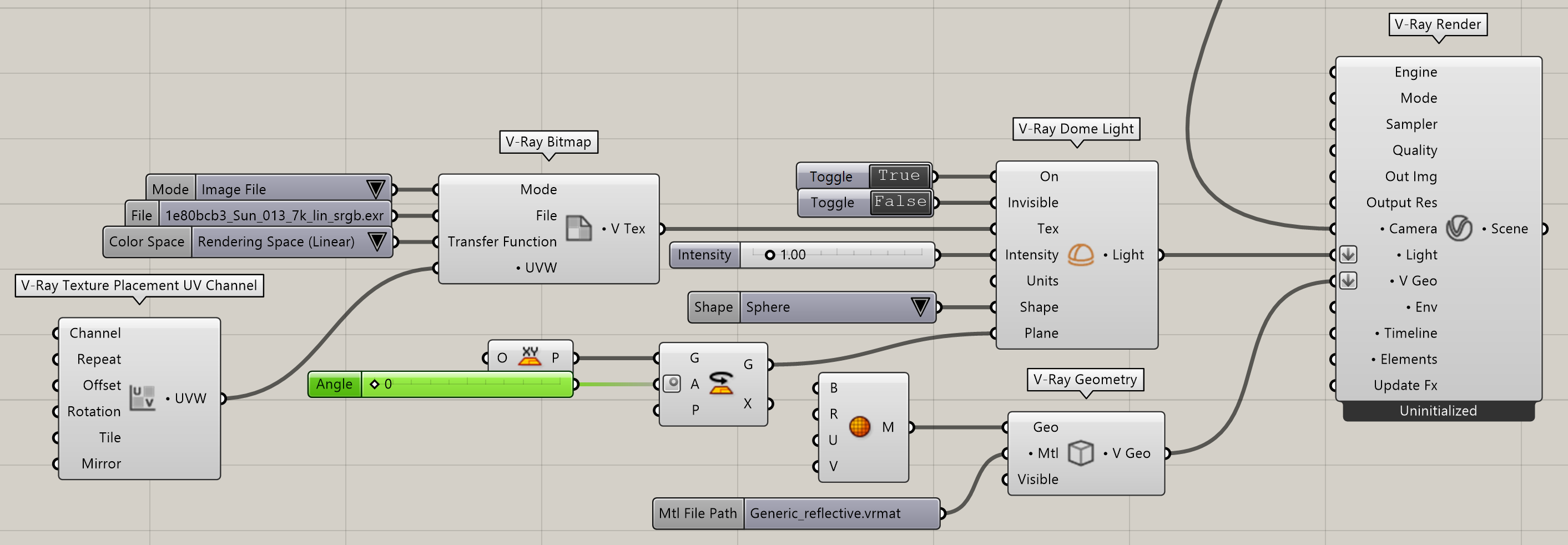

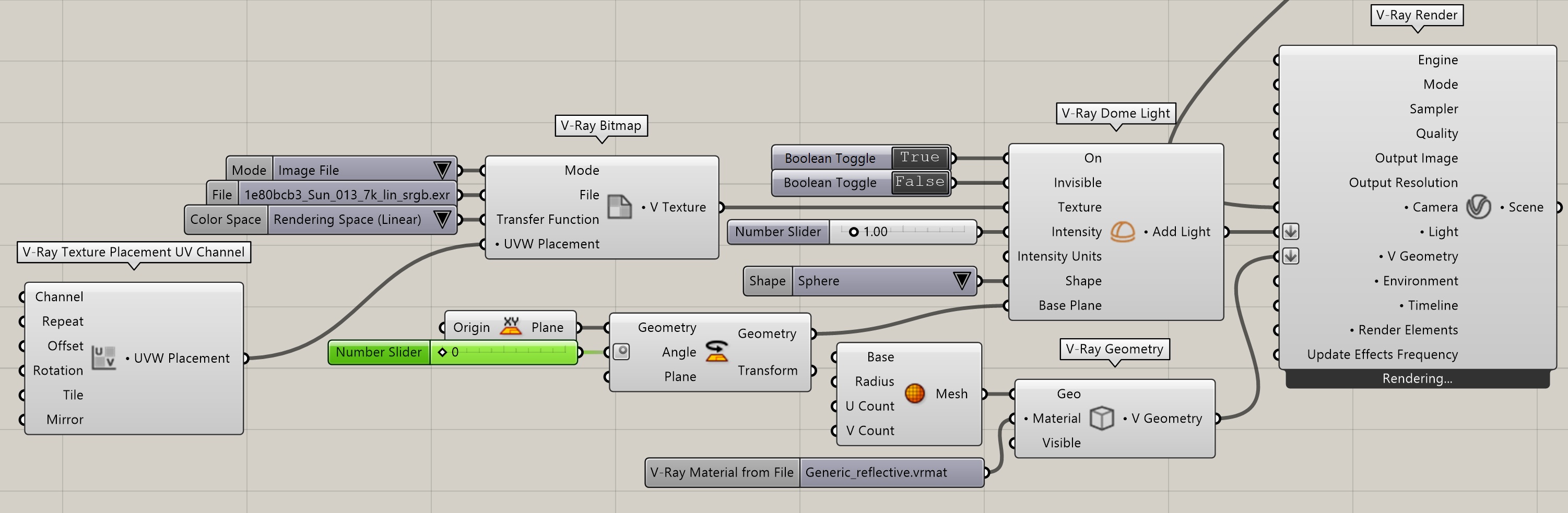

Rotation
In Grasshopper the Dome light can be rotated by rotating its Base plane component.

width70%69%
Image RemovedImage Added
Rotation = 0 Degrees

width70%69%
Rotation = 175 Degrees
