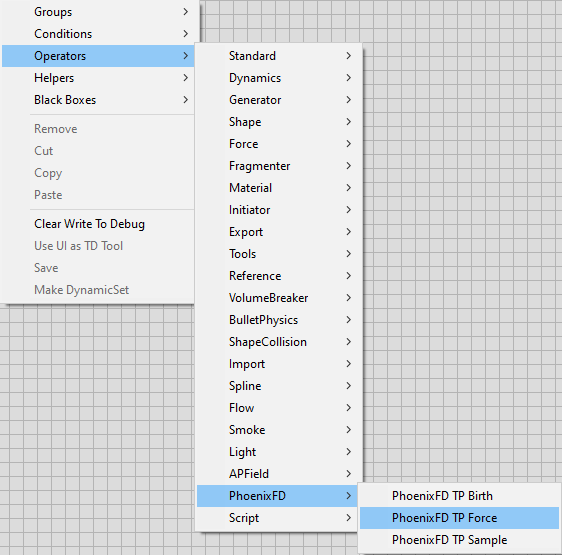

||Thinking Particles Properties window|| > Dynamic Set > Operators > Phoenix FD > PhoenixFD TP Force
