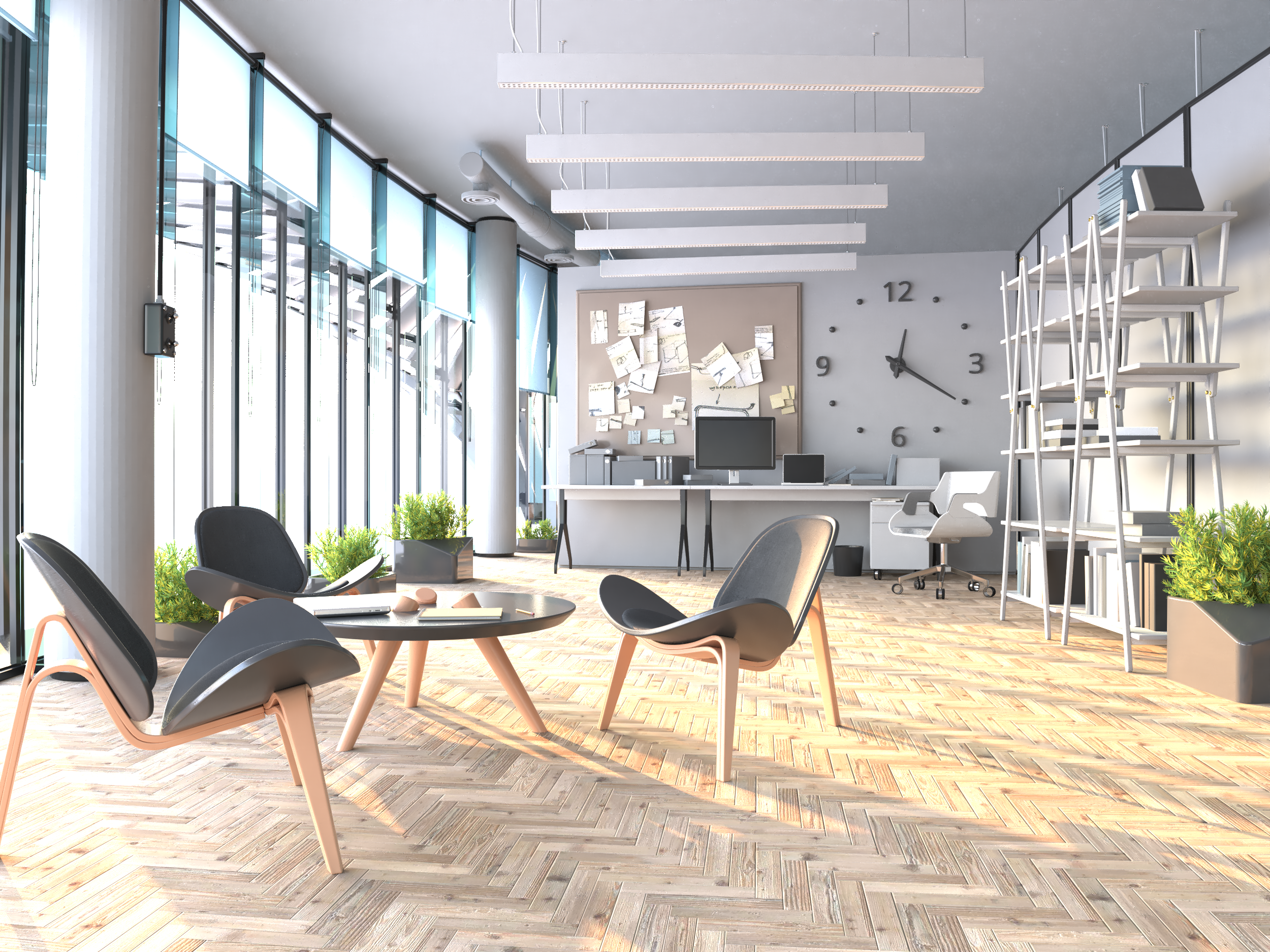

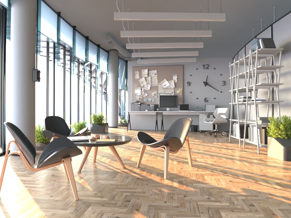

The images on the right show how the Tiling parameter changes the render. The Tiling in the first image is set to a value of 20. See how wide the wooden planks are.
In the second image, the Tiling is set to a value of 60. Thus, the size of the wooden planks is reduced and they are lined more densely.

Let's check out how the Bump map changes the floor's appearance.
The first render which we produced with Bump map multiplier of 30 is good but the surface looks too rough and the space between the individual wood planks is too pronounced. We need to reduce the fine details a little.
In the second render we use a Bump map multiplier of 8. See how the floor is slightly smoother and resembles a wooden surface. The space between the planks is smaller.
