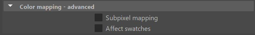

Subpixel mapping – Controls whether color mapping will be applied to the final image pixels, or to the individual sub-pixel samples.
UI Text Box
typenote
The subpixel color mapping option is incompatible with the adaptive lights and can lead to blocky artifacts due to the different sampling rate of the light sources in different cells of the light grid.
Affect swatches – Controls whether or not the color corrections will be applied to the material swatches in the Hypershade and the Attribute Editor.

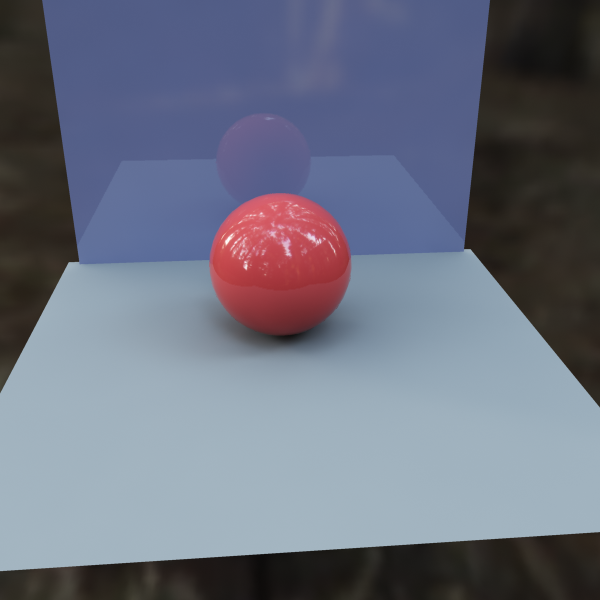

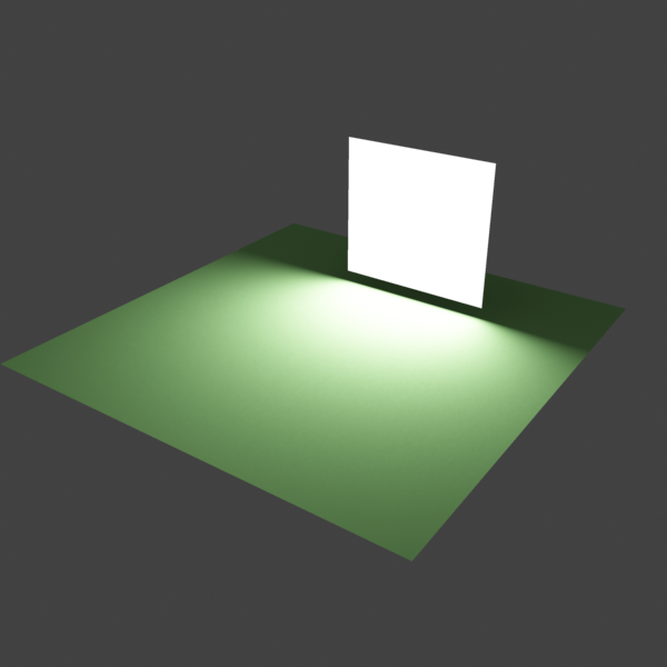

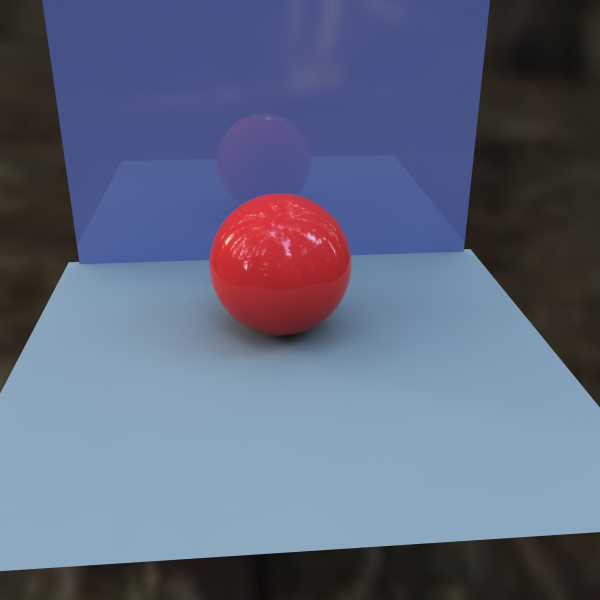

Example: Color Mapping Modes
This example demonstrates the differences between the color mapping modes:
Note: The Sibenik Cathedral model was created by Marko Dabrovic.
width5%
width30%

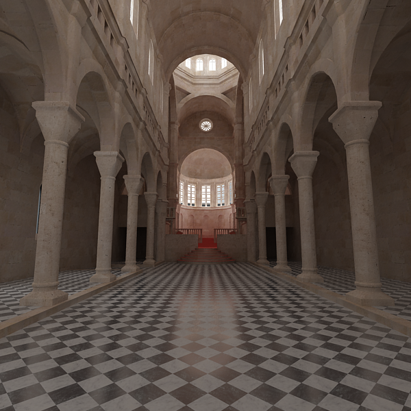

Linear color mapping
Image Removed
Image Removed
Image Removed Linear color mapping
width30%

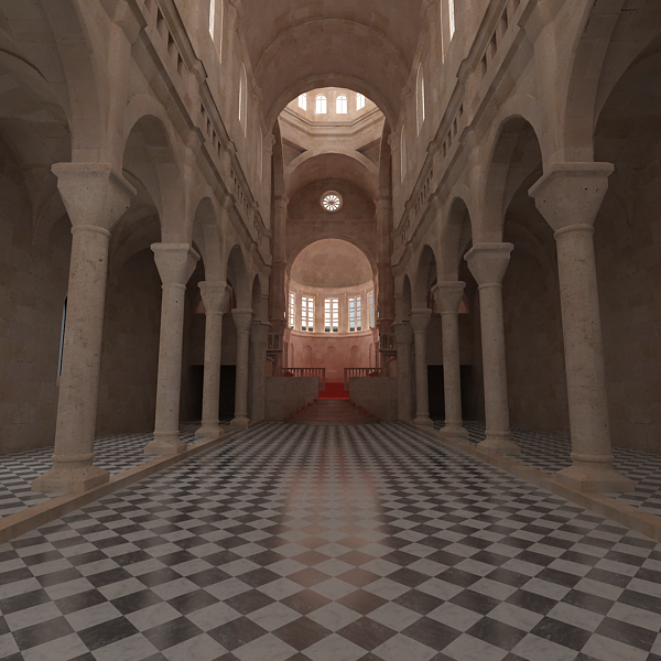

 Exponential color mapping
Image Removed
Image Removed
Image Removed Exponential color mapping
width30%
 HSV exponential color mapping
Image Removed
Image Removed
Image Removed HSV exponential color mapping
width5%
As seen in the images above, the  Linear mapping method clamps bright colors to white, causing bright parts of the image to appear "burnt out". Both the  Exponential and  HSV exponential modes avoid this problem. While  Exponential mode tends to wash out the colors and desaturate them, HSV exponential mode preserves the color's hue and saturation.

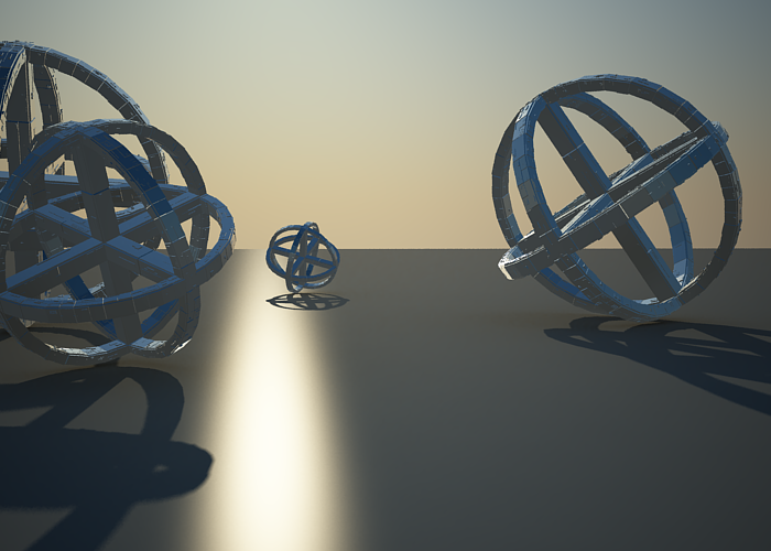

Example: Color Mapping Types with VRaySun and Sky

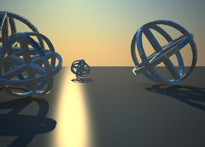

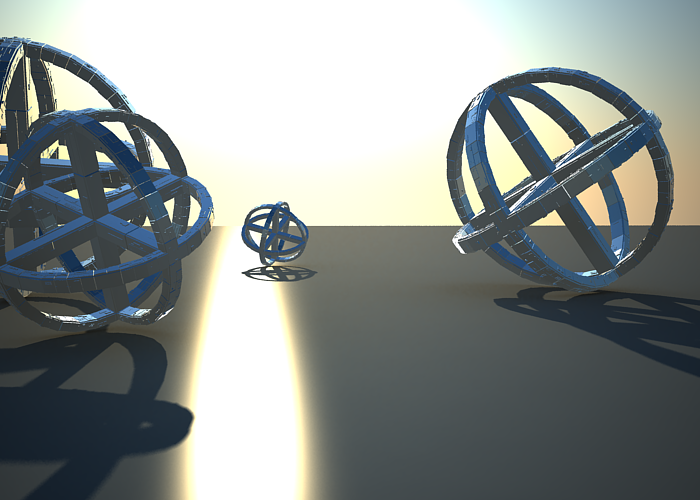

Enabled: On,  Height Y:  290,  Turbidity:  3.0,  Shadow subdivision: 8,  Intensity multiplier: 1,  Size multiplier: 1.0
width10%
width40%
Image Removed
Color mapping
: Linear
width40%
Image Removed
Color mapping
: Exponential
width10%
width10%
width40%
Image Removed
Color mapping
: HSV exponential
width40%
Image Removed
Color mapping
: Intensity exponential
