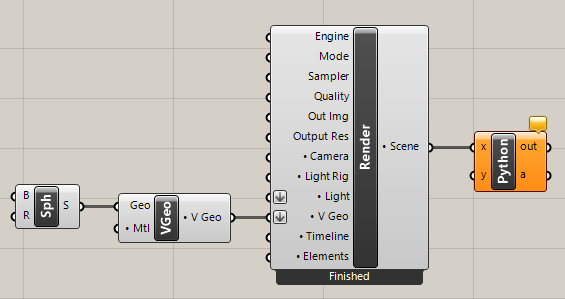

1. Create a C# Script component and plug the renderer output in one of its inputs.

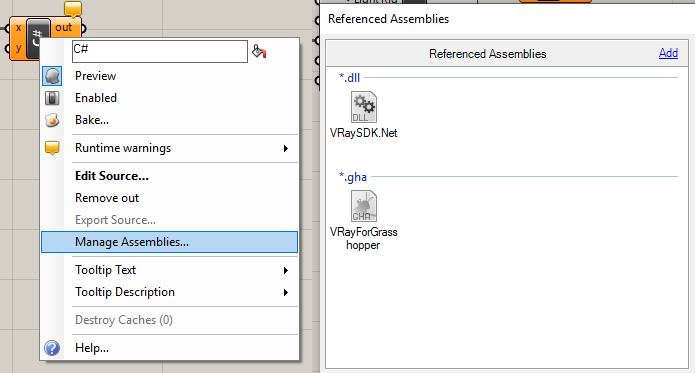

2. Add references to VRaySDK.Net.dll and VRayForGrasshopper.gha
3. In the code editor, cast the input variable to VRayForGrasshopper.Scripting.VRayRenderer.

Right-click on the C# Script component > Manage Assemblies and add references to VRaySDK.Net.dll and VRayForGrasshopper.gha.

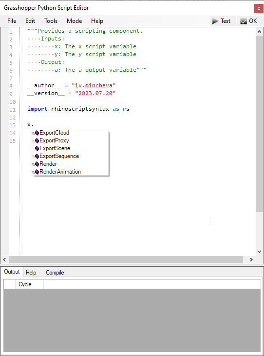

1. Create a GhPython Script component and plug the renderer output in one of its inputs.
2. In the code editor, call any of the above methods on the input variable.
