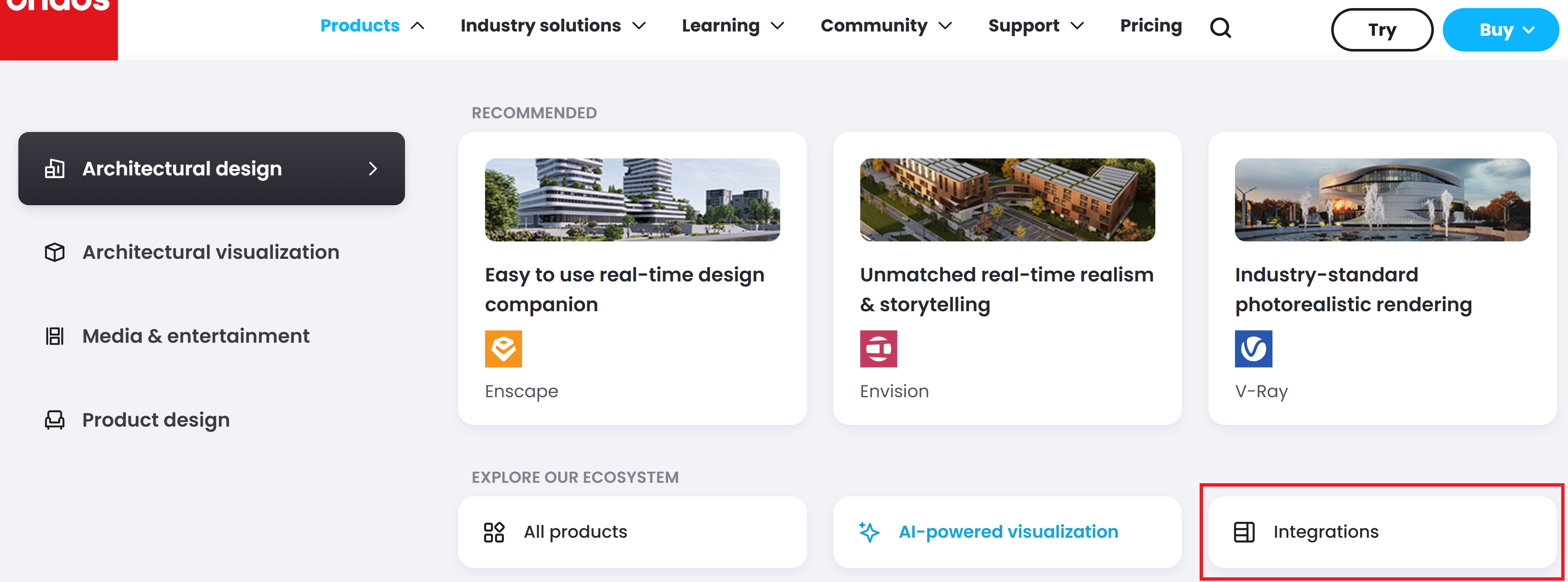

After you sign in to chaos.com, press PRODUCTS and choose Vgo to PRODUCTS and select Integration in the Explore Our Ecosystem section.

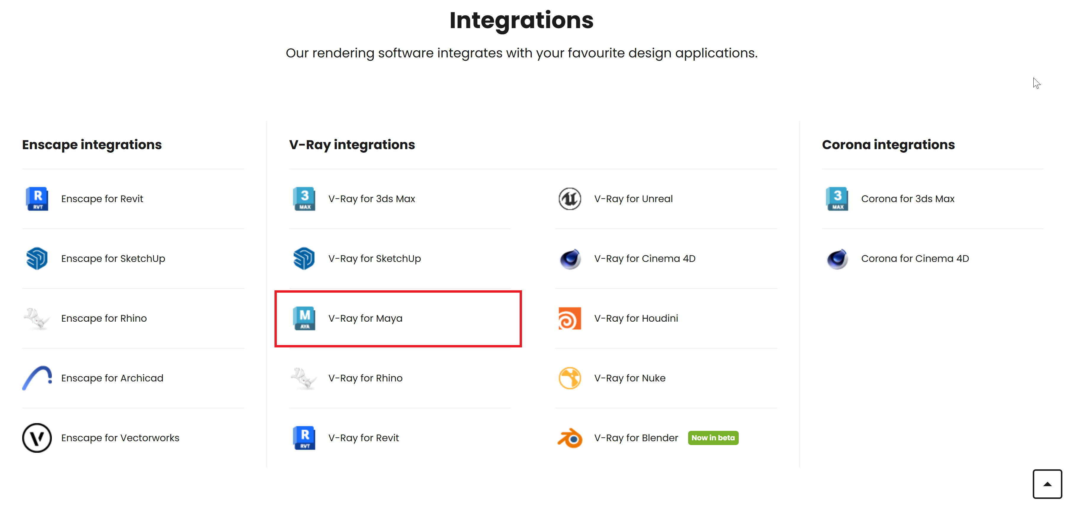

After that, select the V-Ray for Maya
 from
out of the
drop-down menu.
shown V-Ray integrations.

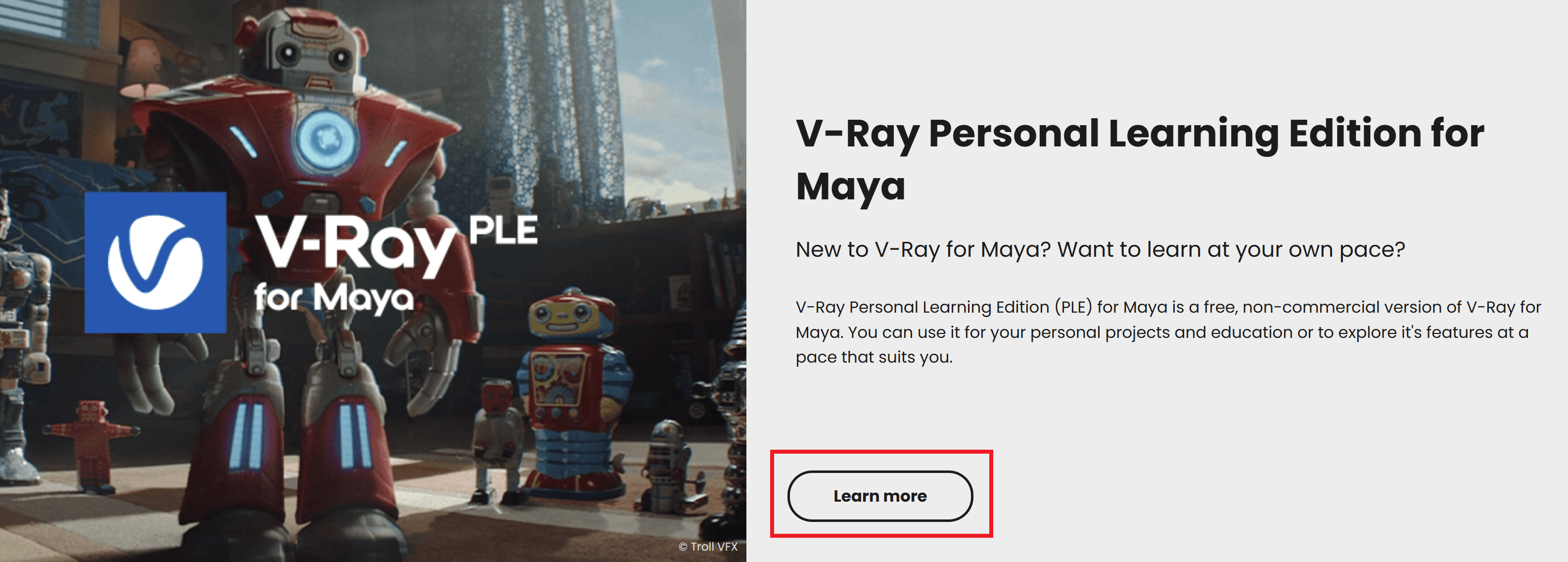

for Maya page, scroll down to the PLE section, or use the navigation bar to jump straight to that section.

Once scrolled down, click on the Learn more button to be redirected to the Maya PLE section.

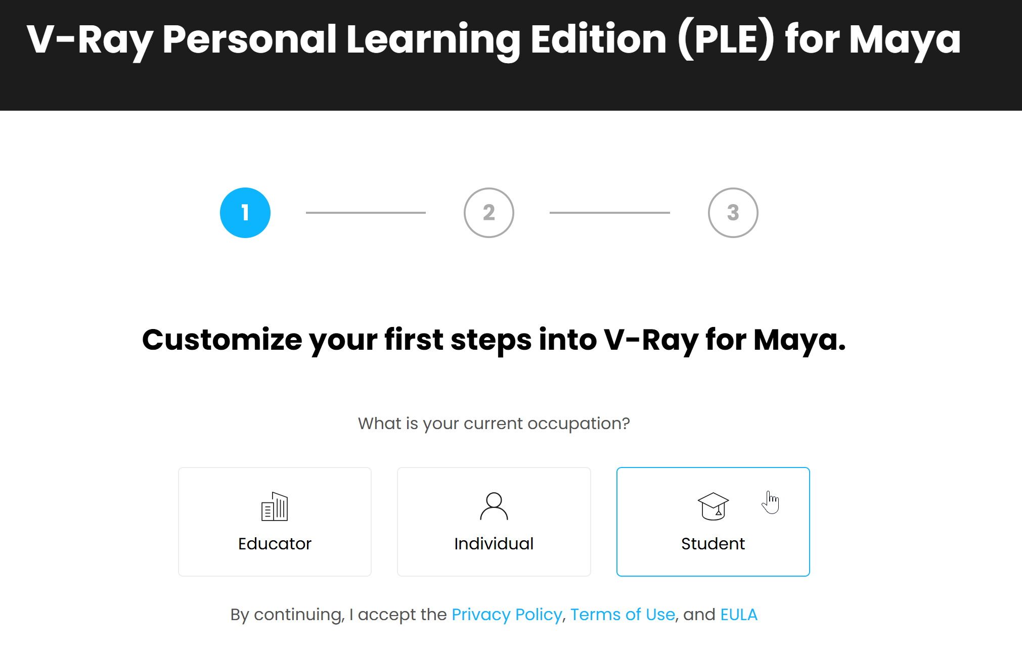

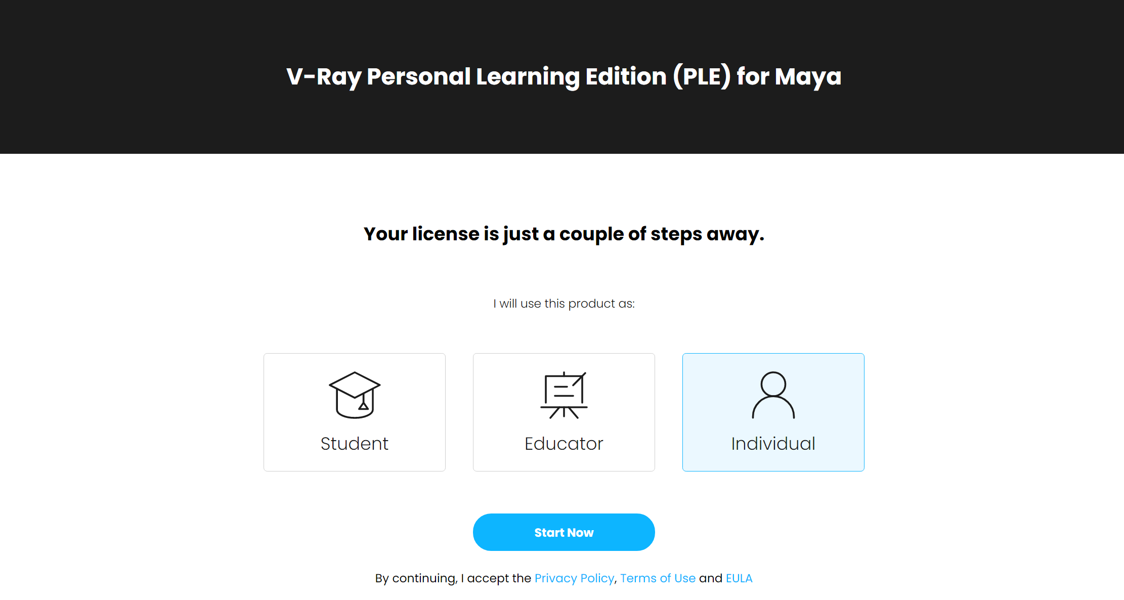

A new window opens. Select how you plan to use the product.
Section
Column
width20%
Column
width60%
Image Added
Column
width20%

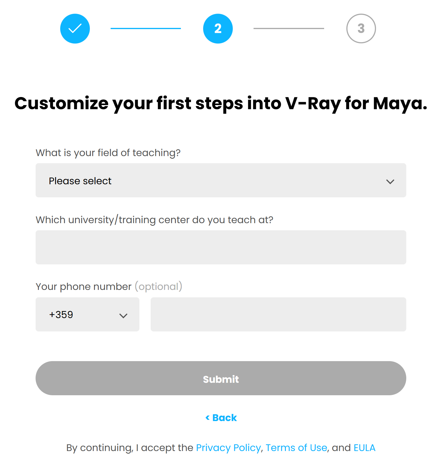

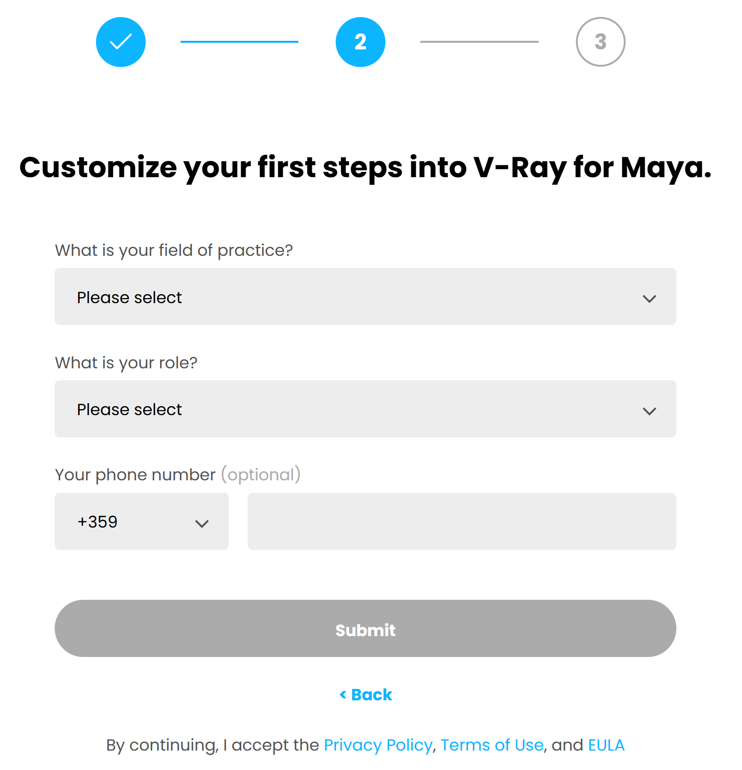

Depending on the chosen role, you are asked to enter some additional information about yourself. Once done, click Submit to continue to the next step.

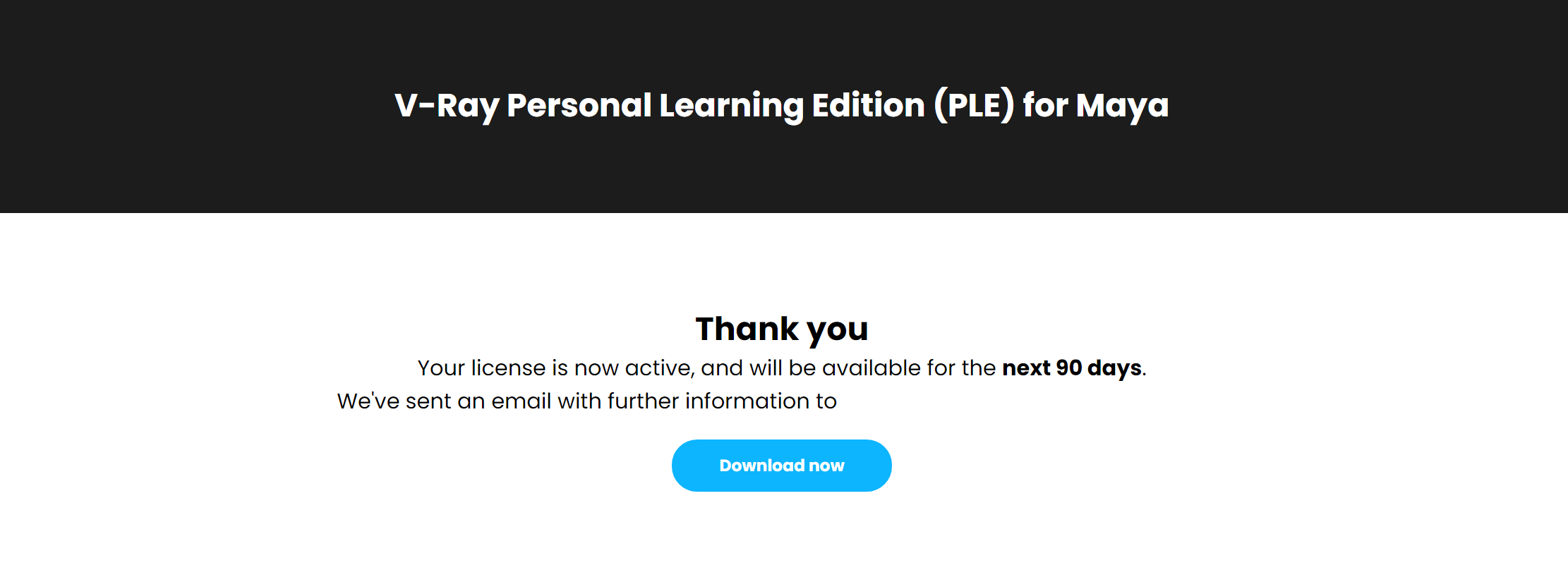

Once your request is processed, you will see a "Thank you" message and a Download Now link to access the product.

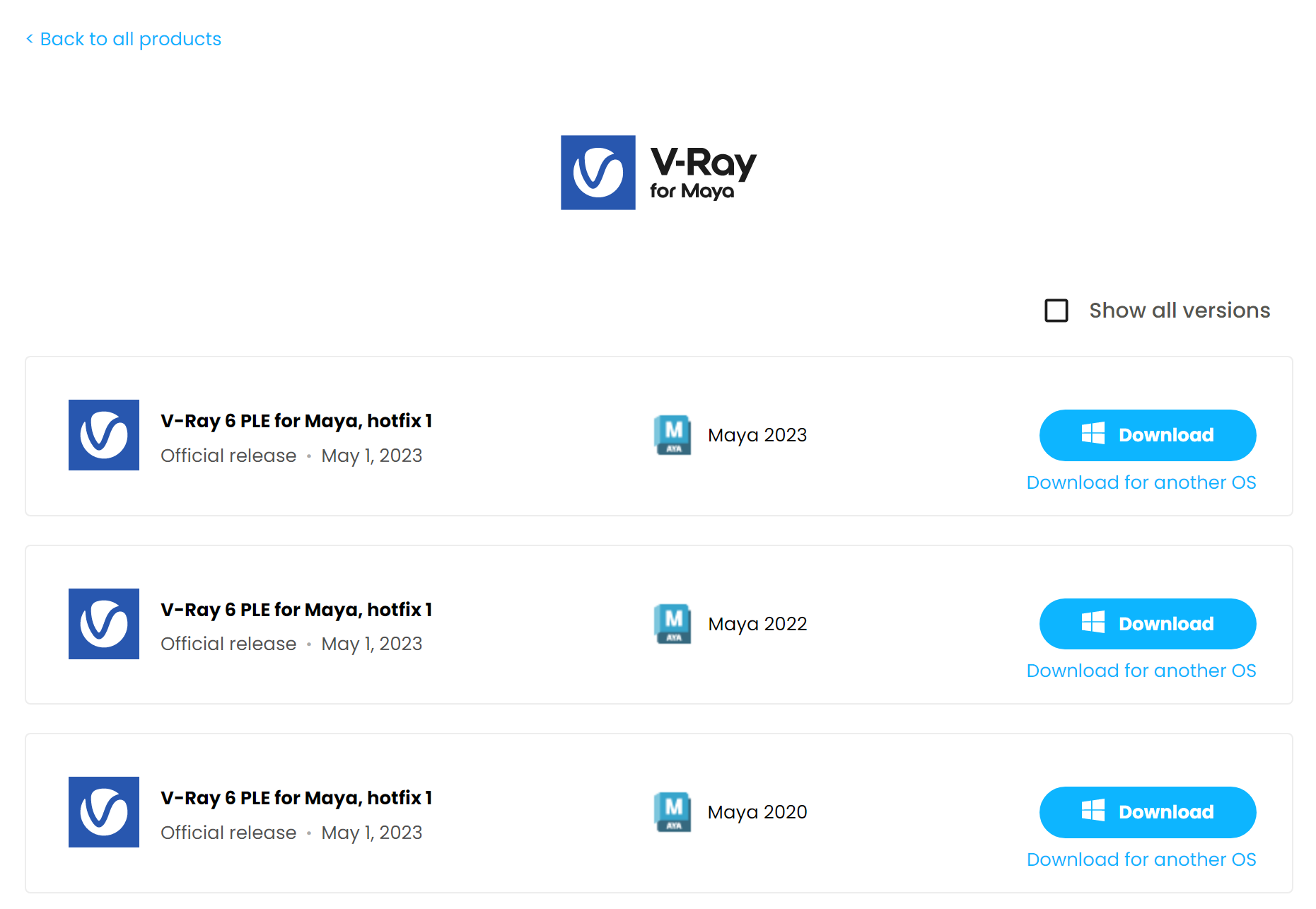

Select the version you need to download for your operating system and install it. For more information on how to do it, see the Installing V-Ray PLE for Maya section below. You can also download the license from my.chaos.com → Products → Active Products.

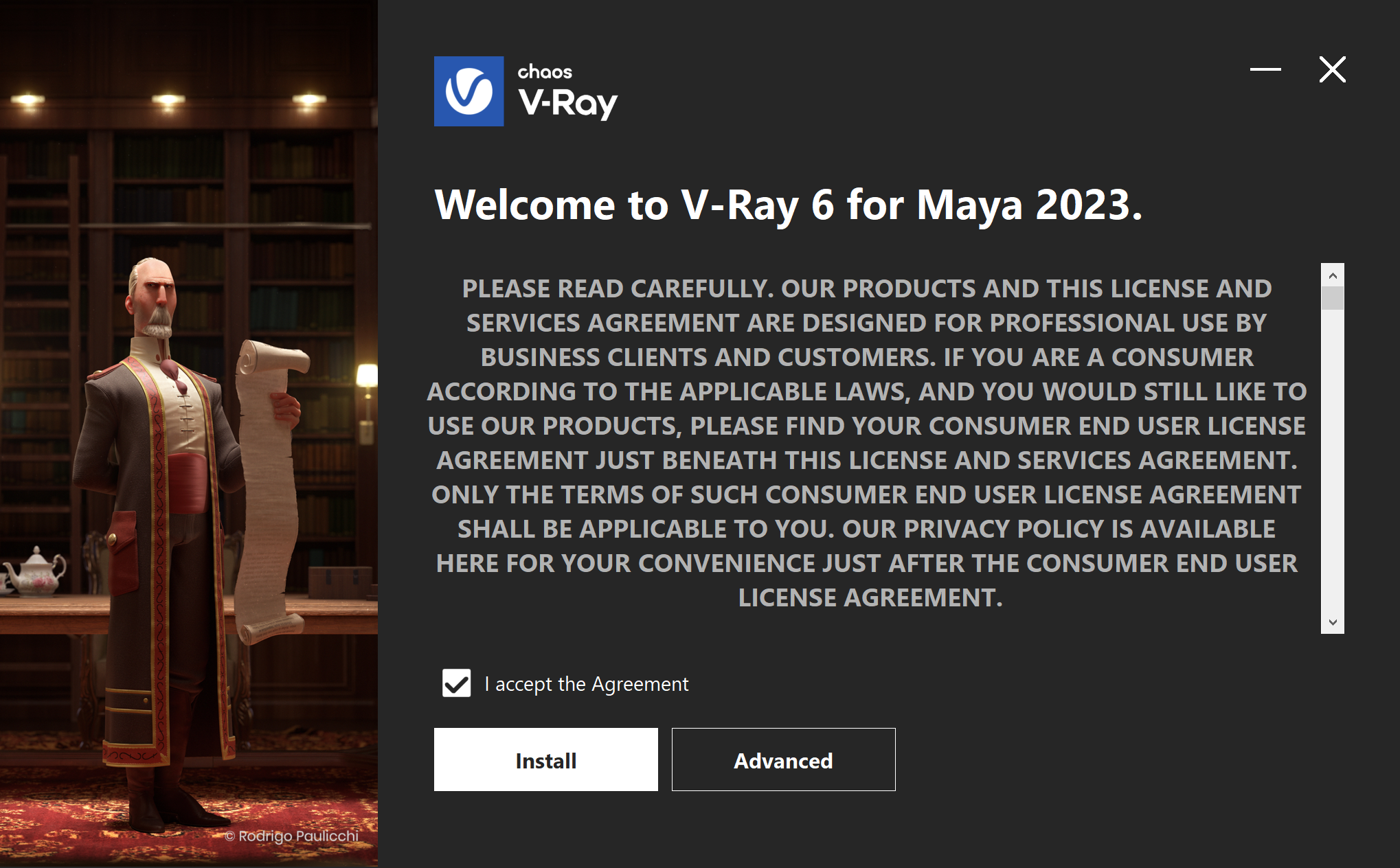

1. You will be presented with the V-Ray licensing agreement. Please take a moment to review the agreement. Check the I accept the Agreement checkbox and click Install to proceed.
UI Steps
UI Step
Section
Column
width60%
Welcome
Carefully read the End User License Agreement and the Global Consumer Privacy Policy. Click the I accept buttons if you agree to the terms.
Proceed to click the Install button. If you need to customize your V-Ray installation,
press the
click the Advanced
 button
button.

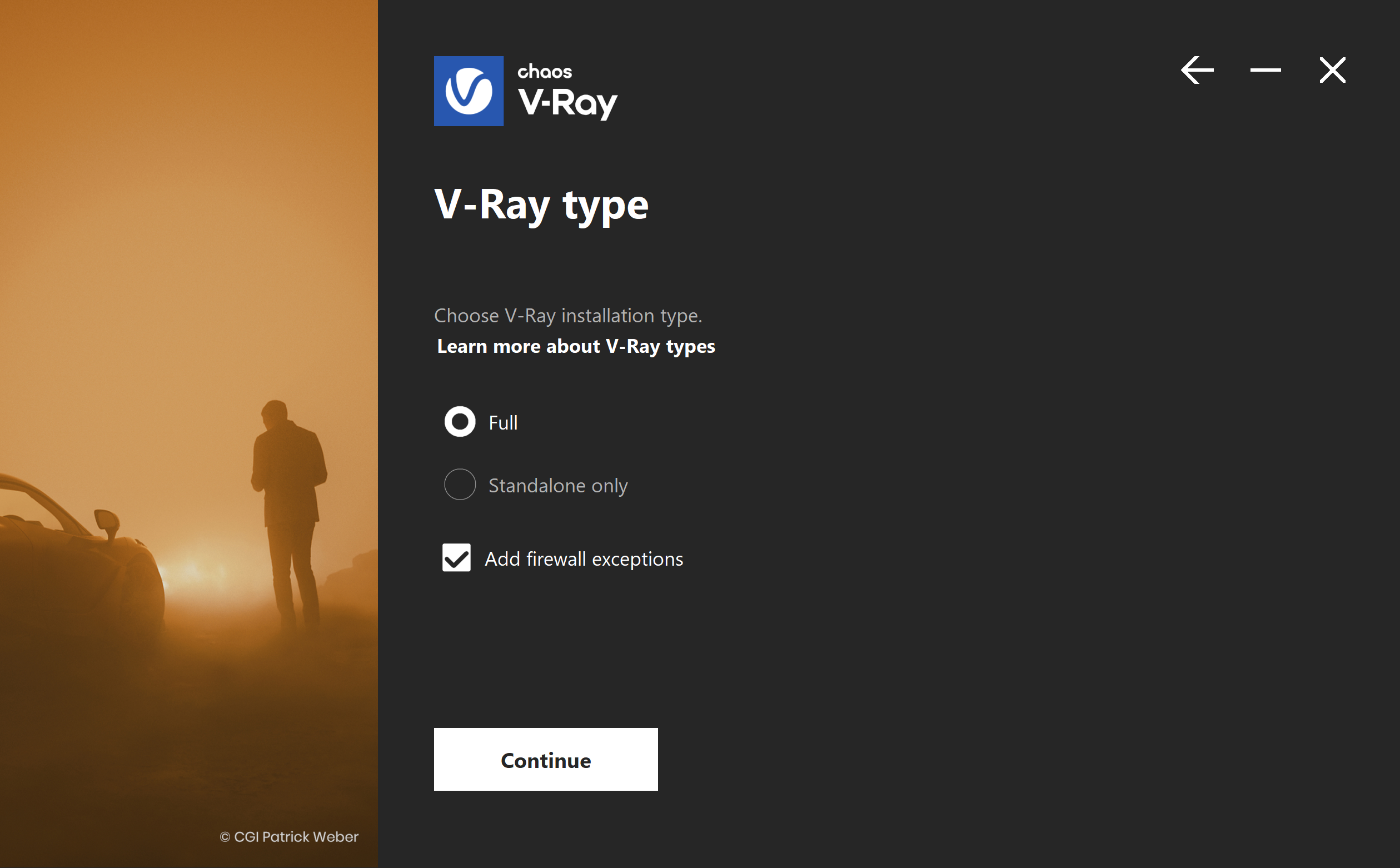

V-Ray type
Advanced settings
Full – Includes all components. It allows you to use V-Ray in Maya, run V-Ray Standalone or a V-Ray render server for Distributed or Network Rendering.
Standalone only – Installs only V-Ray Standalone and V-Ray render server. Choose this option if you only use this machine for Distributed Rendering.
Add firewall exceptions – Automatically add firewall exceptions so Distributed Rendering and V-Ray Standalone can run uninterrupted.

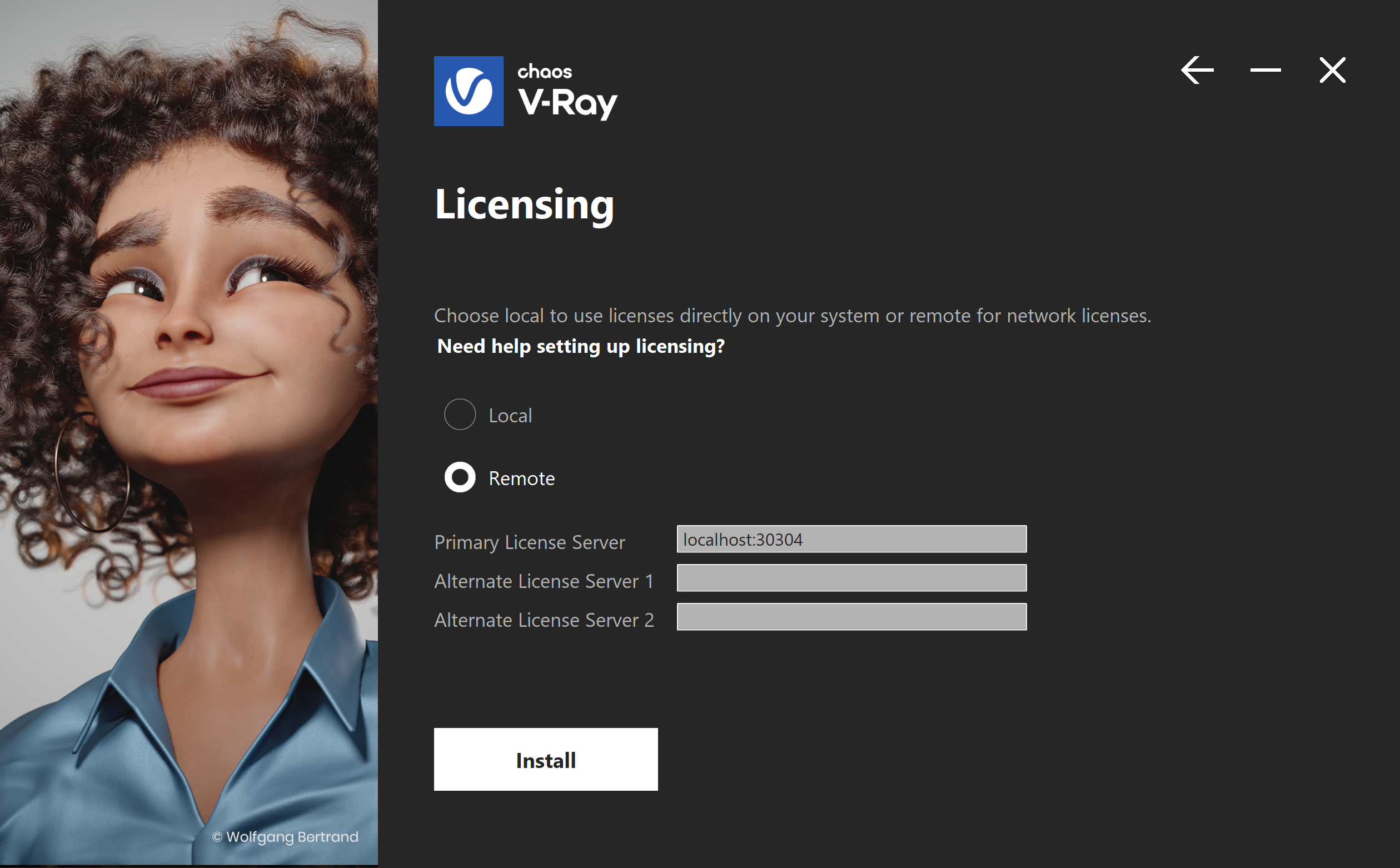

Licensing
In this step, specify whether the Chaos License Server runs locally or on another machine.
If you select Remote licensing, you have to enter the IP address of your Chaos License Server in the Primary License Server field. Leave port 30304 unchanged. An Alternate License Server can be used for redundancy in case the primary one does not respond. The License Server will not install when the Remote option is selected. When Local licensing is selected, the Chaos License Server is installed with V-Ray.

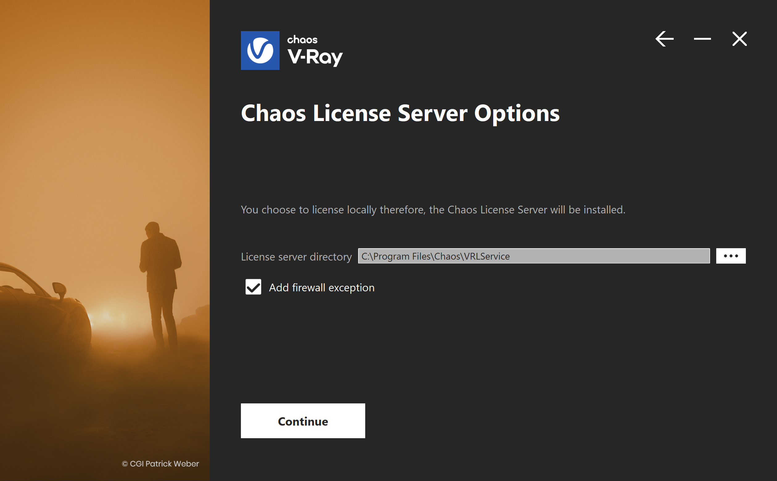

Chaos License Server Options
At this step, you can choose where to install the Chaos License Server.
Add firewall exception – Allows the default licensing port (TCP 30304) in the firewall. If you disable it at this step, you must manually add firewall exceptions later. This option is available for Windows OS only.

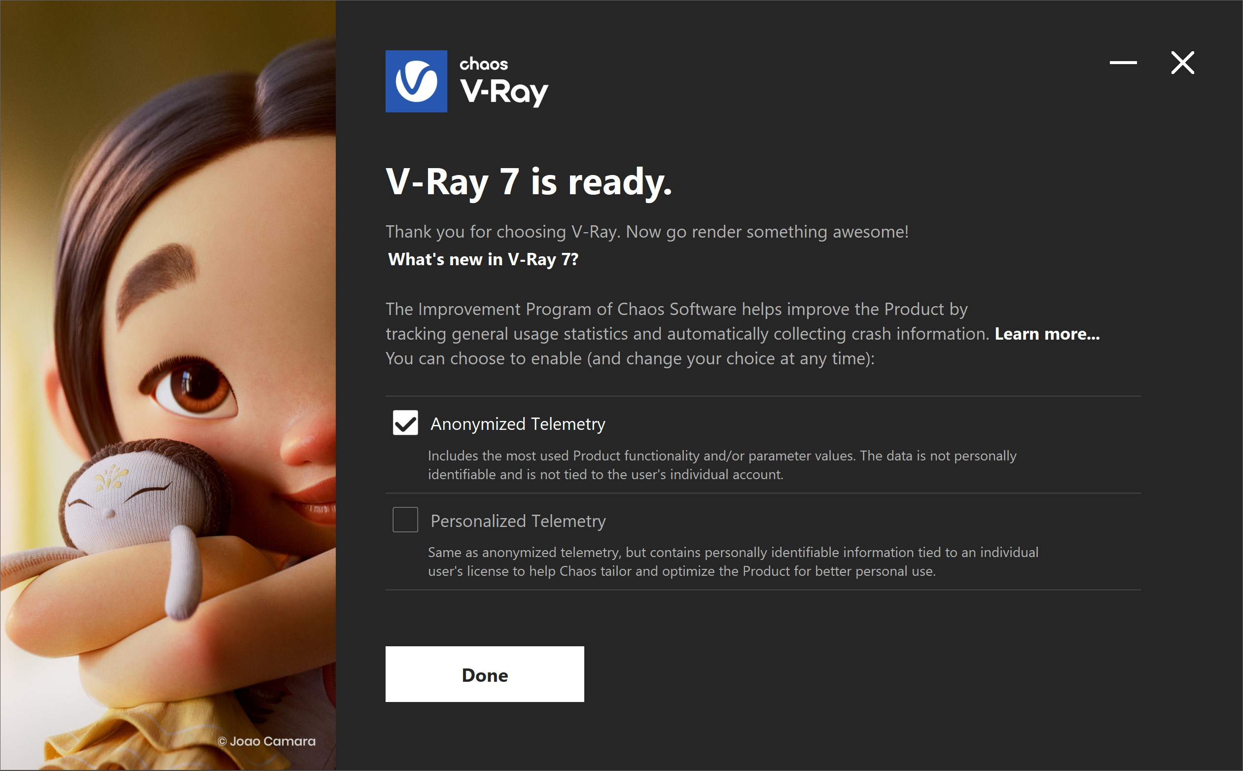

Chaos Telemetry
V-Ray installation is successful.
Participate in the improvement decisions for future
version
versions of V-Ray. No intelligence property is violated when agreeing to participate in the feedback program.

Anonymized Telemetry – Includes the most used product functionality and/or parameter values. The data is not personally identifiable and is not tied to the user's individual account.
Personalized Telemetry – Includes the most used product functionality, parameter values, but also contains personally identifiable information tied to an individual user's license. This helps Chaos tailor and optimize the product for better personal use.

Now V-Ray is ready to render! Don't forget to activate your Chaos License, otherwise your product won't be active.
