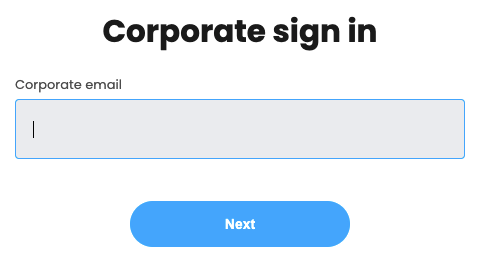

Once selected, the user is asked to input their email address.
Chaos uses the email domain name to determine which Corporate Sign In integration to use. Based on that the user is redirected to log into the relevant identity provider service.

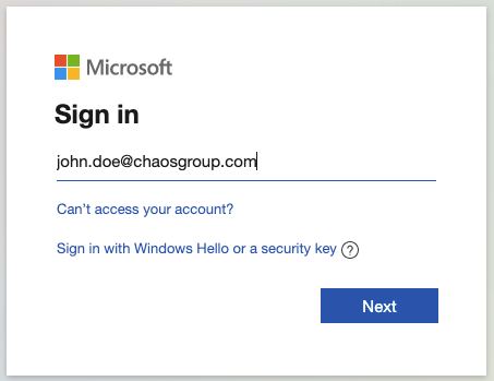

For example, for Azure this looks as follows:
By default the Chaos login form forwards the email address to the corporate identity provider login page. However, if you are not using email addresses for login in your identity provider, the forwarding behavior can be disabled, which allows to use username or some other indication at your identity provider’s login page instead.
Once the user is logged in the company corporate login page, they are redirected back to the Chaos login page, where a session is established. The user is now able to use the Chaos web page as though they logged in via password.
