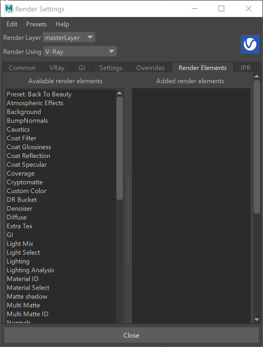

Render Elements List
Available render elements – List of all render elements that V-Ray supports.
Added render elements – List of render elements that V-Ray will render when that layer is enabled. Note that it is possible to add multiples of the same render elements.
Add – Adds all render elements selected from the list on the left, to the scene for rendering. You can also double-click a render element on the left list to add it.
Remove – Remove the selected render elements from the scene. This is not the same as merely disabling a render element from rendering.
Save – Save the list of render elements to a file for later retrieval or pipeline dissemination.
Import – Import the list of render elements from a file.
For more information on each Render Element, please see the Render Elements section.
