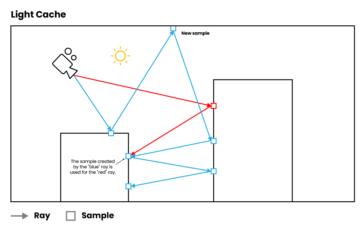

The diagram on the right shows the way the light cache is generated. To get the lighting from the environment, V-Ray traces many rays from the camera into the scene. Each bounce of light creates a sample in the light cache that can be used during the rendering. If one ray hits a sample that was created by another ray, the computation process stops and the information from the sample is read instead. The ability to detect and read lighting information created by other rays (instead of computing new information) speeds up the light caching process a great deal.
