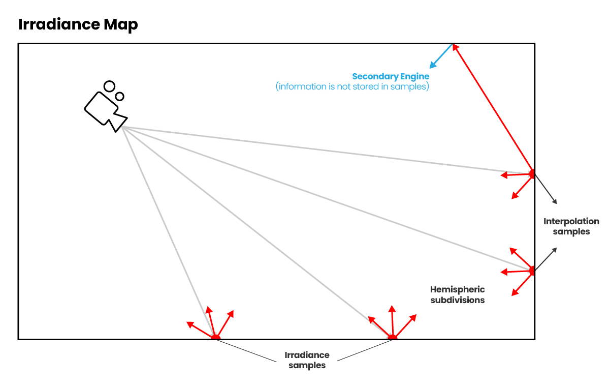

The diagram above shows the way the Irradiance map is generated. The Irradiance map method can only be selected as the Engine for Primary bounces; it is not available for Secondary bounces. Since the method is view-dependent, the first rays (the black lines in the diagram) are traced from the camera into the scene in order to determine the placement of the irradiance samples. Once this is done, GI rays (red) are traced from the samples into the scene in order to determine the illumination coming from the environment. The number of traced rays is determined by the Subdivs parameter. The irradiance map only traces one bounce of light. All additional bounces (blue) are traced by the secondary engine. The irradiance map is created on several passes - each pass adding more samples where this is needed. During rendering, for each rendered point, V-Ray takes several samples from the already complete irradiance map and interpolates between them in order to create a smooth GI solution. The number of samples taken is determined by the Interp. samples parameter.
