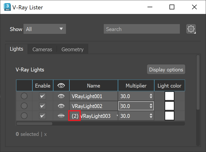

The number of instanced lights or cameras is marked in brackets in front of the object’s name.
