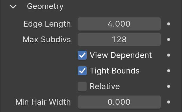

Geometry
Edge LengthDetermines the quality of the displacement or subdivision. Each triangle of the original mesh is subdivided into a number of sub-triangles. More sub-triangles means more detail in the displacement, slower rendering times and more RAM usage. Less sub-triangles mean less detail, faster rendering and less RAM. The meaning of Edge length depends on the View-dependent parameter below.
Max SubdivsControls the maximum sub-triangles generated from any triangle of the original mesh. The value is in fact the square root of the maximum number of sub-triangles. For example, a value of 256 means that at most 256 x 256 = 65536 sub-triangles are generated for any given original triangle. It is not a good idea to keep this value very high. If you need to use higher values, it is better to tessellate the original mesh itself into smaller triangles instead.
View DependentWhen on, Edge Length determines the maximum length of a sub-triangle edge, in pixels. A value of 1.0 means that the longest edge of each sub-triangle is about one pixel long when projected on the screen. When View-dependent is off, Edge Length is the maximum sub-triangle edge length in world units.
Tight BoundsWhen on, V-Ray computes the exact bounding volume of the displaced triangles from the original mesh. This requires pre-sampling of the displacement texture, but the rendering is faster, if the texture has large black or white areas. However, if the displacement texture is slow to evaluate and varies a lot between full black and white, it may be faster to turn this option off. When off, V-Ray assumes worst-case bounding volumes, and does not pre-sample the texture.
RelativeWhen on, the actual displacement amount is based on the bounding box of the objects. When off, the displacement is expressed in generic world units where white areas in the displacement map correspond to displacement of 1 generic unit. You can use the Amount parameter to increase or decrease the displacement amount.
Min Hair Width –

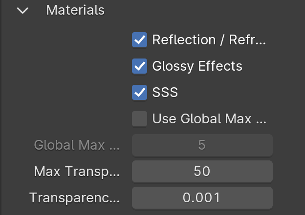

Materials
Reflection / Refraction – Enables (default) or disables the calculation of reflections and refractions in V-Ray maps and materials.
Glossy effects – Enables (default) or disables the rendering of glossy effects.
SSS – Enables (default) or disables the rendering of sub-surface scattering effects.
Use Global Max Depth – Enables global limiting of the reflection/refraction depth of a material. When this is disabled, the depth is controlled locally by the materials' Reflection Max depth parameter. When this option is enabled, all materials use the Global Max Depth specified in this rollout. For more details, see the Global Max Depth example below.
Global Max Depth – Specifies the maximum depth when Global Max Depth is checked. To disable all reflections/refractions in the scene, set this value to 0.
Max. Transparency Levels – The depth to which transparent objects will be traced. For more details, see the Max Transparency Levels and Reflection/Refraction example below.
Transparency Cutoff – Determines when tracing of transparent objects will be stopped. If the accumulated transparency of a ray is below this threshold, no further tracing will be performed.
