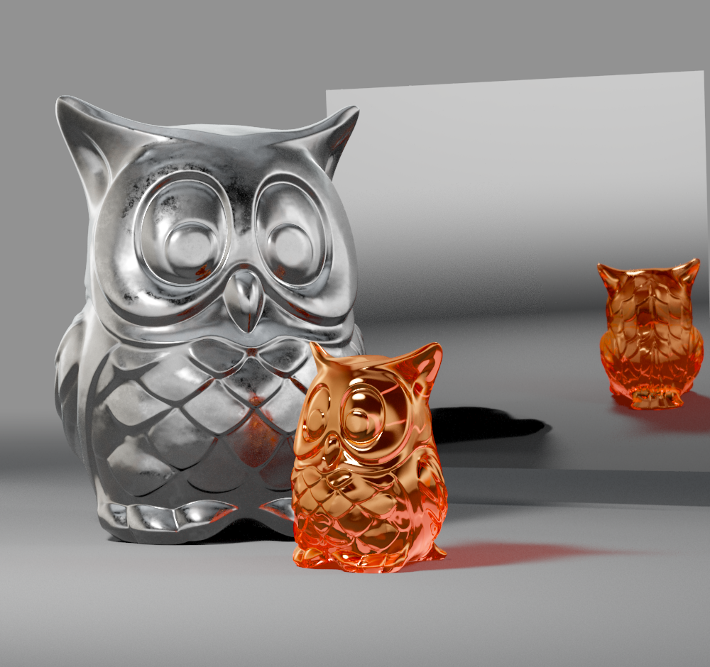

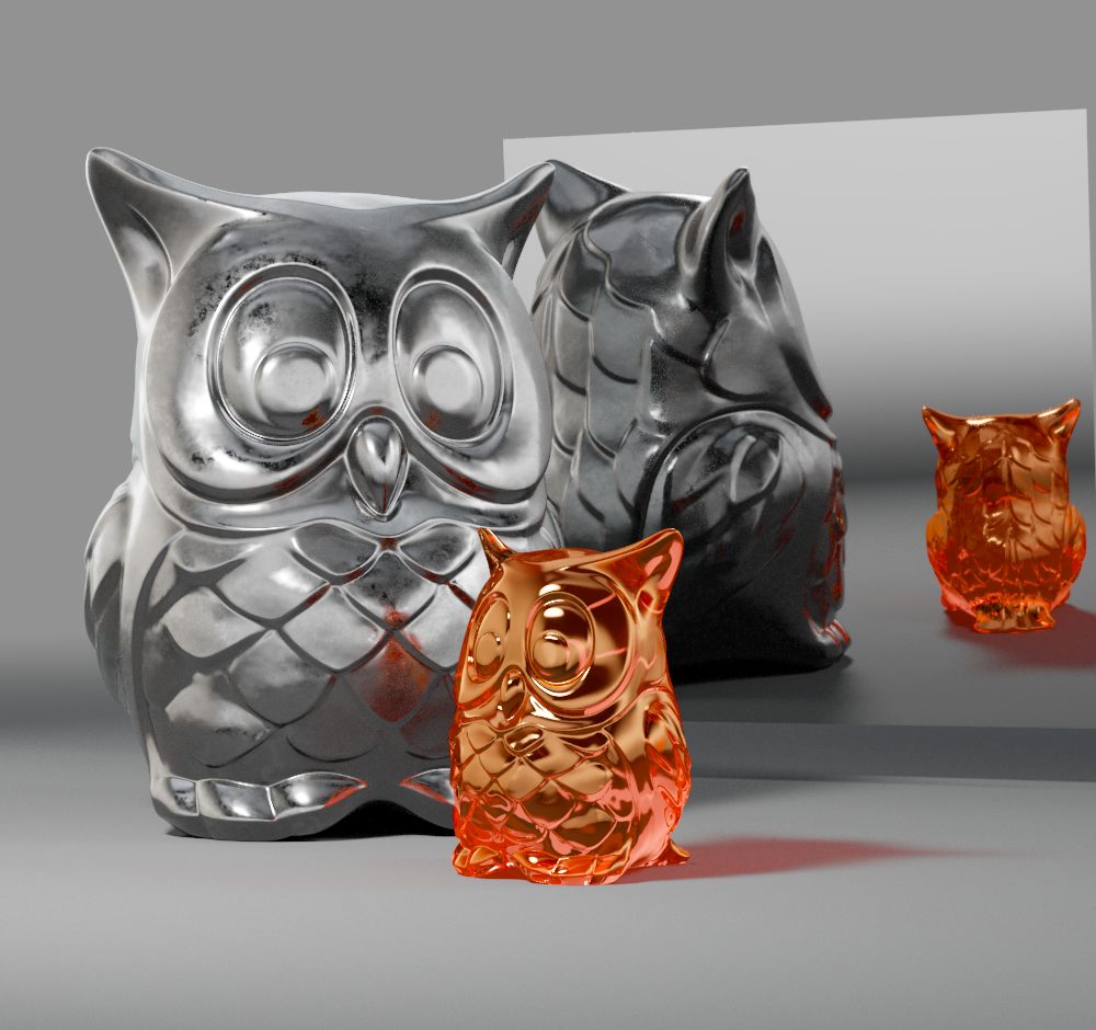

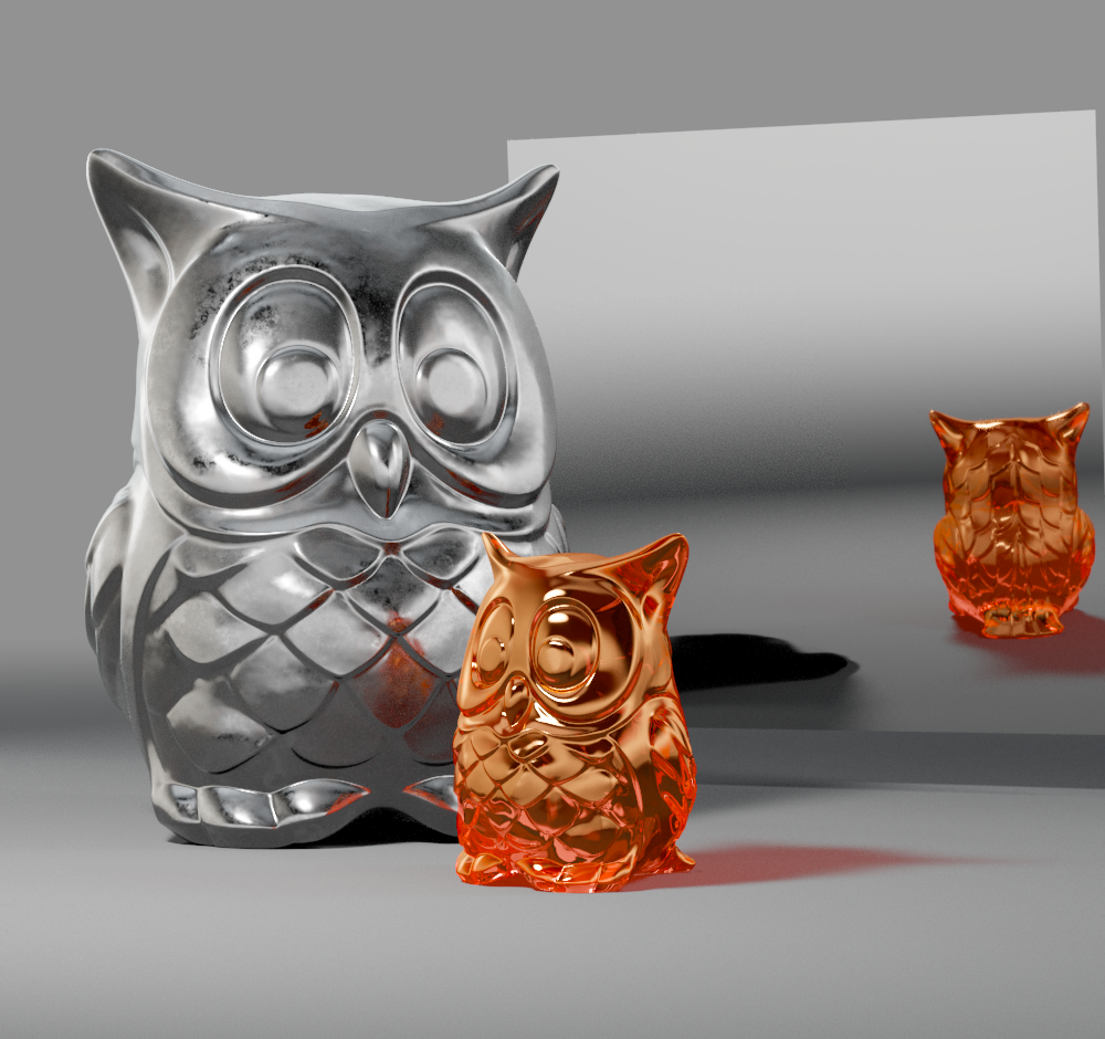

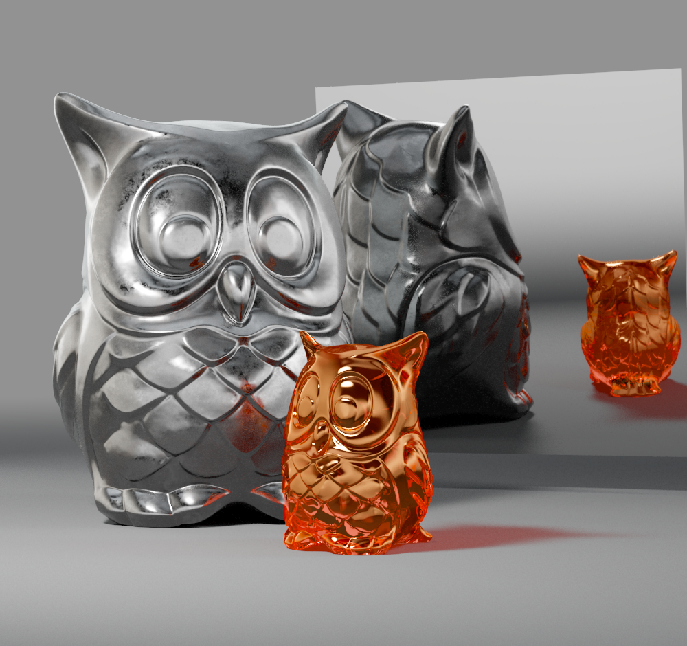

This example shows the effect of the Cast Shadows parameter. The V-Ray Render Stats material is applied to the metallic owl figurine.
Example: Visible in Reflections/Refractions
This example shows the effect of the Visible In Reflections and Visible In Refractions parameters. The V-Ray Render Stats material is applied to the metallic owl figurine.
When Visible In Reflections is off, the metallic owl is transparent to reflection rays, and respectively when the Visible In Refraction is off, the metallic owl is transparent to refraction rays. When both options are off, the metallic owl is neither visible in the mirror plane nor in the glass owl figurine.
