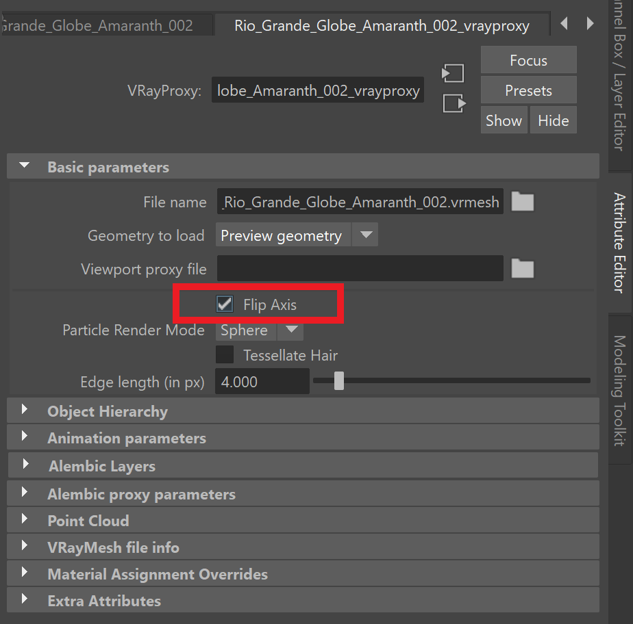

V-Ray Proxy files are often created in other software, not Maya. This may result in their axes having a different orientation than the native Maya one. Having axes with a different orientation obstructs Chaos Scatter from trimming the instances properly. This is the case for all Chaos Cosmos assets and proxies created in V-Ray for 3ds Max. You need to adjust their axes if you want to scatter such proxy files and use Edge Trimming. To do so:
  • Go to the proxy object's attributes, and in the Basic Parameters rollout, enable the Flip Axis option.

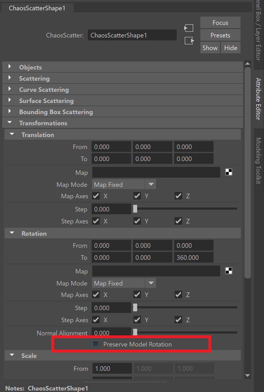

  • In the Scatter Object's attributes, go to the Transformations rollout > Rotation and disable the Preserve Model Rotation option.
Enable the Proxy's Basic Parameters > Flip Axis
Disable the Scatter object's Translations > Rotation > Preserve Model Rotation option

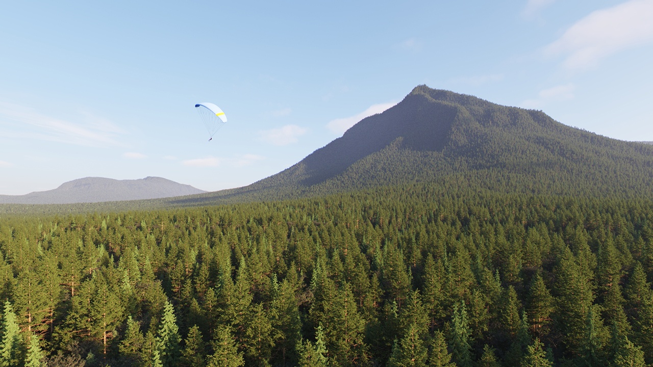

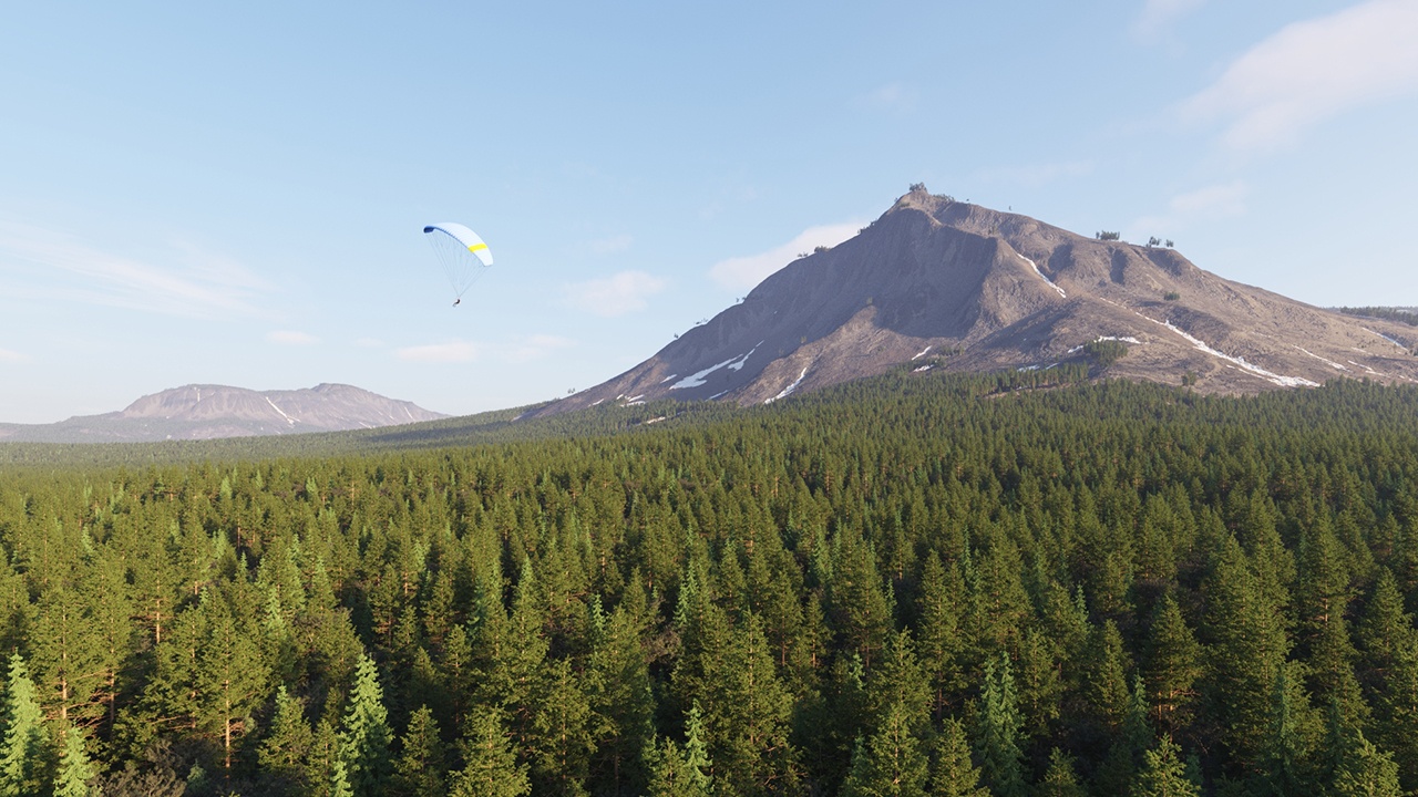

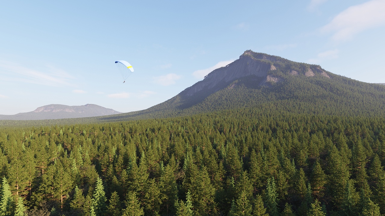

The Min/Max Angles remove instances based on the angle of the underlying geometry. These options can be used to remove geometry from steep areas as well as shallow areas.
Slope Limitation is disabled
Min/Max Angles = 0.0° - 45.0°
Min/Max Angle = 0.0° - 20.0°
Min/Max Angle = 5.0° - 20.0°

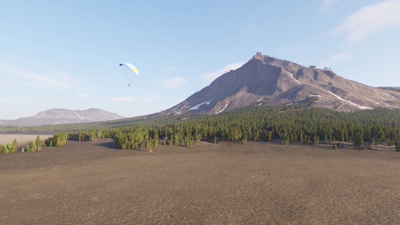

Max Altitude – Determines the maximum altitude range for the scatter objects. Objects above this threshold are not rendered. See the example for more information.
Example: Altitude Limitation
Setting the Max Altitude to 5000.000 cm (500m) limits the scattered trees to that height.
