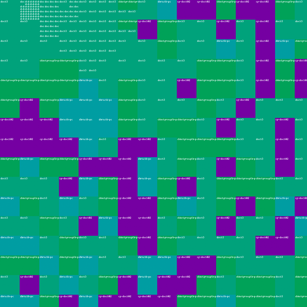

Distributed rendering ID
The Distributed rendering ID Render Element shows the name of the rendering machine that rendered any particular bucket when distributed rendering is used.
The Distributed rendering ID Render Element renders an image with each bucket shown in a different color, and a short text on each bucket naming the machine that rendered it. A bucket is a region of an image that is being rendered. The render setup must be set to use the Bucket image sampler, which divides the rendering process into render buckets. This render element is useful for assessing machine performance or for troubleshooting a distributed rendering process.

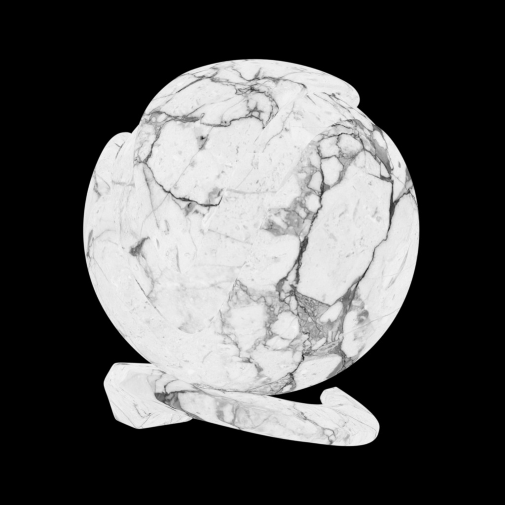

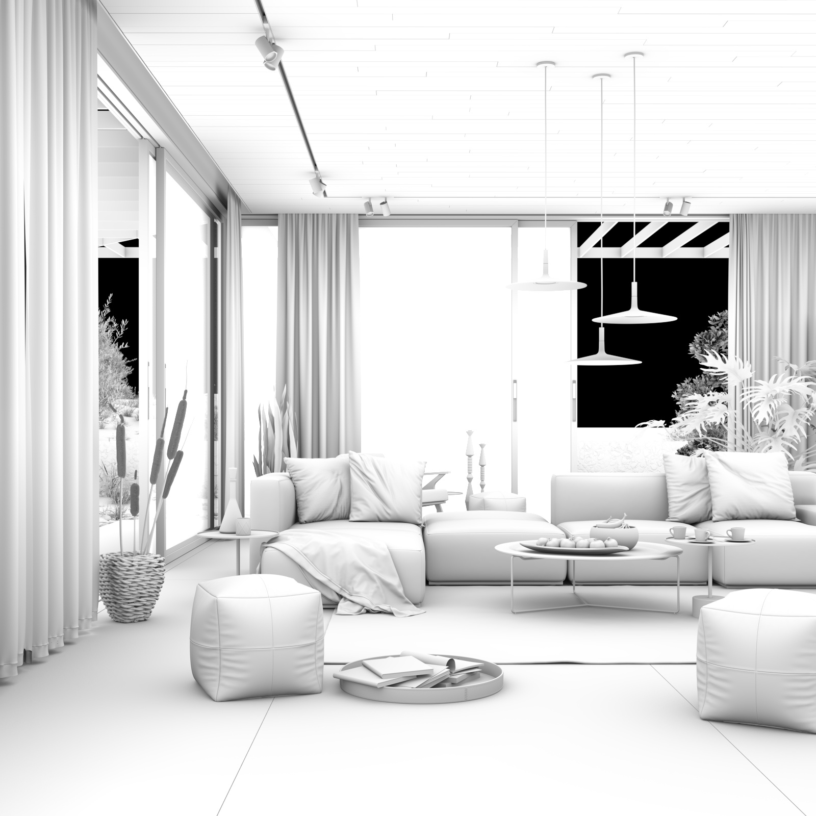

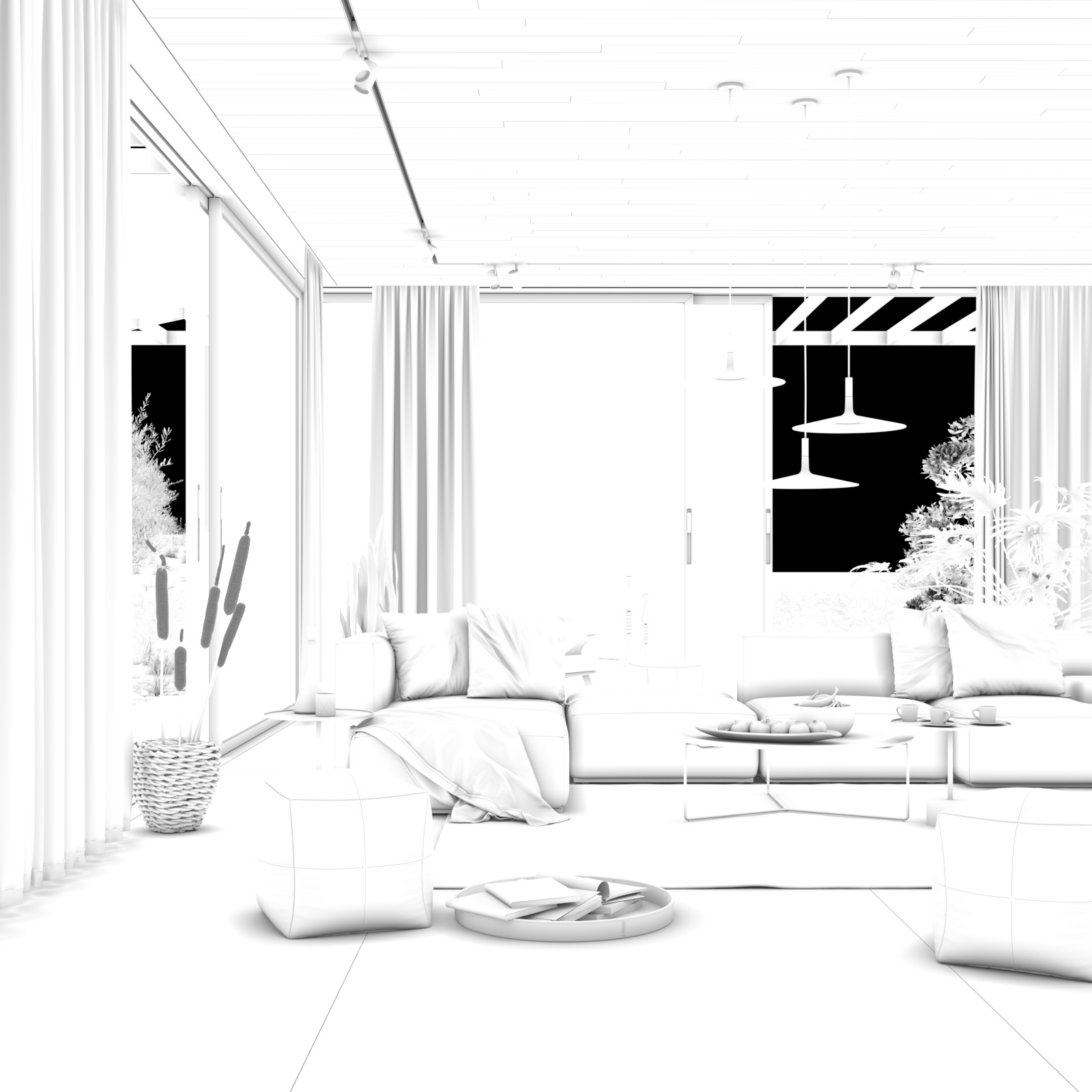

Extra Texture
The Extra Texture Render Element renders the entire scene with one texture mapped onto all objects in the scene.
The Extra Texture Render Element shows the rendered image with a single texture applied to all objects in the scene. The texture applied to the scene can be a bitmap or a procedural texture such as TexDirt or TexCurvature.
A common use for Extra Tex is to use TexDirt as the texture, which creates an ambient occlusion element for use in the composite. In this way, ambient occlusion can be controlled separately during the compositing process.
While you can obtain a result similar to the Extra Tex render element by applying the same texture to all objects in the scene and rendering as usual, such an approach requires additional time spent on reverting to actual materials, saving different versions of the scene, etc. The Extra Tex render element provides you with a quick and easy way to render the scene with a single texture without the extra work.
Extra texture with applied texture
Extra texture with applied TexDirt
Extra texture with applied TexFalloff
The Extra Texture Render Element is accessible through the RenderChannelExtraTex plugin.

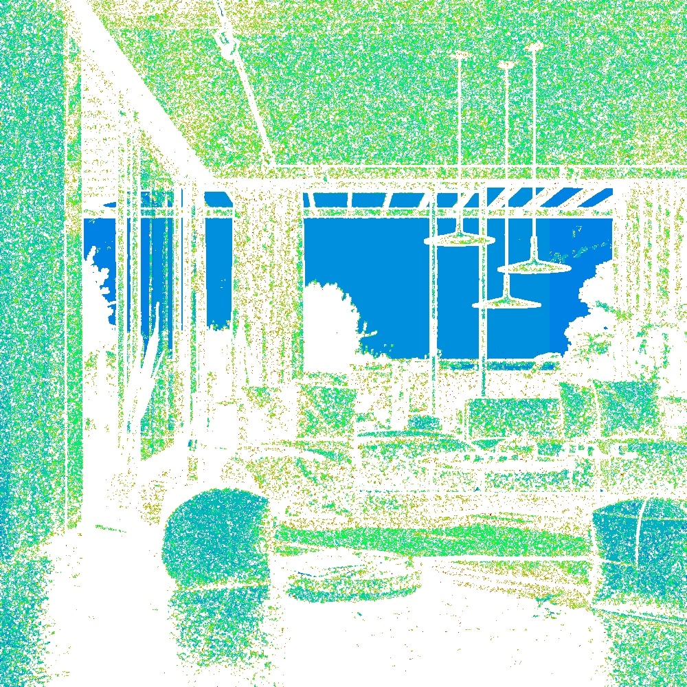

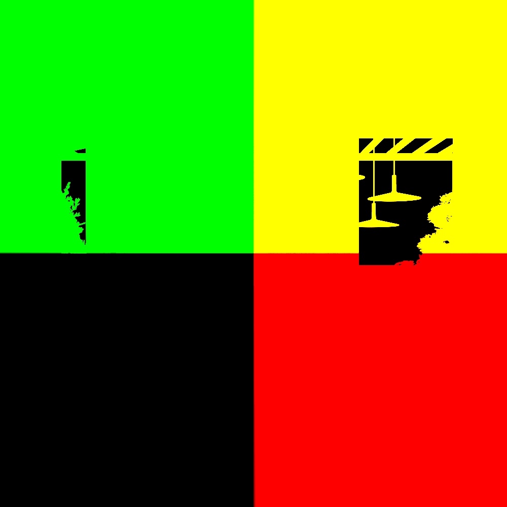

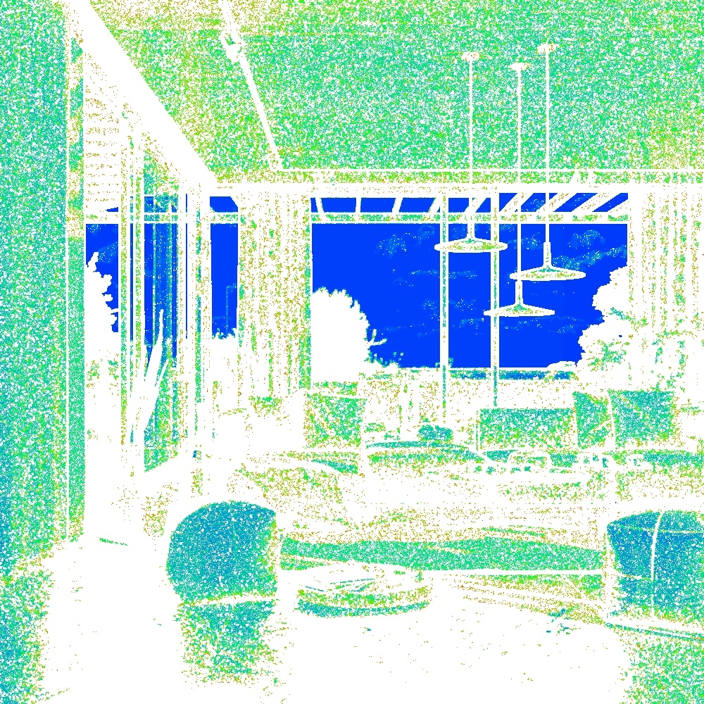

Sample Rate
The Sample Rate Render Element displays the work being done by the image sampler as a red, green, and blue image.
The Sample Rate Render Element displays the work being done on the image as it is rendering, and shows the job done when the render completes.
A color is assigned to each pixel according to how many primary samples are being taken by the Image Sampler:
  • The Blue channel contains the areas which reached the desired image quality with few primary samples.
  • The Green channel shows areas which required more antialiasing (AA) samples to clean up than the Blue areas, but managed to achieve the Noise Threshold within the number of AA rays used.
  • The Red channel contains the parts of the image which didn't make it to the desired quality threshold, as they reached the maximum amount of AA rays before reaching the Noise Threshold.
  • If the Image Sampler type is Progressive, the White areas represent the areas the sampler is currently working on, as they were found to not satisfy the Noise Threshold as of yet.
The way to ensure a render is correctly computed is to minimize the amount of red color in this render element. Raising secondary sampling through any means reduces the primary sampling work in the corresponding areas, effectively moving red areas into green ones, and green ones into blue ones. Lowering secondary samples per pixel does the opposite, potentially leading to more red areas. The suggested way to minimize the red color and optimize render times to increase the Max AA Subdivs value (if the previous render was still noisy), or increase the Noise Threshold value (if the previous render was clean, but took too long to complete).
Note that some specific image features, like high-frequency detail often found in fur and hair, or high-contrast zones, will likely always try to reach the maximum sampling, so some red will appear there. This is perfectly normal and doesn't slow down the rest of the rendering while ensuring the problematic parts of the image will clean up as per the user's settings.
Common Uses
Sample Rate can be used with both the Bucket and Progressive image samplers.
Bucket Image Sampler

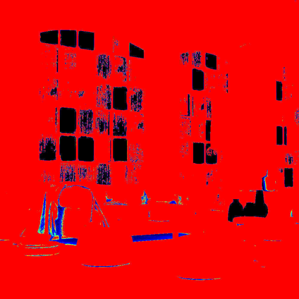

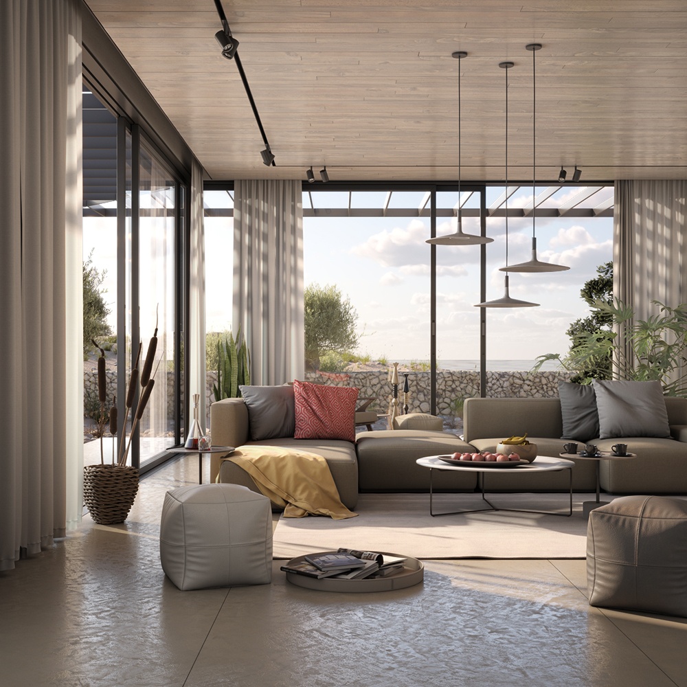

The Sample Rate Render Element is useful for fine-tuning render settings using a "red is bad" rule.
Below is a scene with minimal red in the Sample Rate Render Element, indicating that the sampler had a high enough Max Subdivs value to hit the desired noise level.
Render time = 11m 39s, Max Subdivs = 24, Noise Threshold = 0.01, Min shading rate = 6
The image sampler is mostly able to reach the noise threshold using the subdivisions allotted.
In the next image, the sampler did not have a high enough Max Subdivs value to hit the desired noise level. The high amount of red shows that the image sampler cut off sampling before the image hit the desired noise level. Noise can be decreased by increasing the Max Subdivs parameter to allow the image sampler to reach the desired noise level.
Render time = 6m 17s, Max Subdivs = 8, Noise Threshold = 0.01, Min shading rate = 6
The Image sampler is mostly not able to reach the specified noise threshold.
The primary samples can be allocated to the complex areas of the image by increasing both the Max Subdivs and the Noise Threshold values. This way, V-Ray has available enough primary samples to lower the noise of the complex areas in exchange for an overall slight increase in noise, while still keeping the render times down.
Render time = 5m 37s, Max Subdivs = 12, Noise Threshold = 0.02, Min shading rate = 6
Sample Rate Render Element with not enough max subdivs.
Alternatively, the image sampler can allocate primary and secondary samples by changing the Min shading rate value.
For this scene, increasing the Min shading rate allows the sampler more secondary samples to focus on cleaning the lighting, GI, reflections and refractions. In exchange, some of the detailed fur and high contrast areas are a bit noisier as there are not enough primary samples taken for those areas.
Render time = 8m 38s, Max Subdivs = 8, Noise Threshold = 0.01, Min shading rate = 20
Sample Rate Render Element with not enough Max Subdivs.
Less primary samples are needed to hit the desired noise level, since more secondary samples are taken.

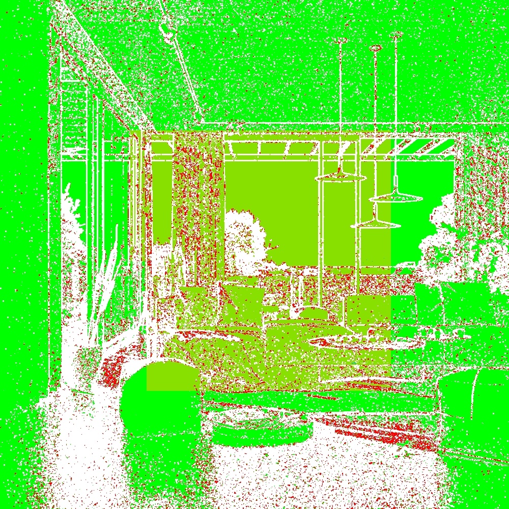

Progressive Image Sampler
The Progressive sampler uses the same algorithm as the Bucket sampler. The main difference is that the maximum samples increase as the sampler finishes each pass.
11 passes
Very few samples are given to complex areas of the image
36 passes
Samples start to focus on difficult areas.
200 passes
Many samples start to collect only when needed.
White areas are the primary target now.

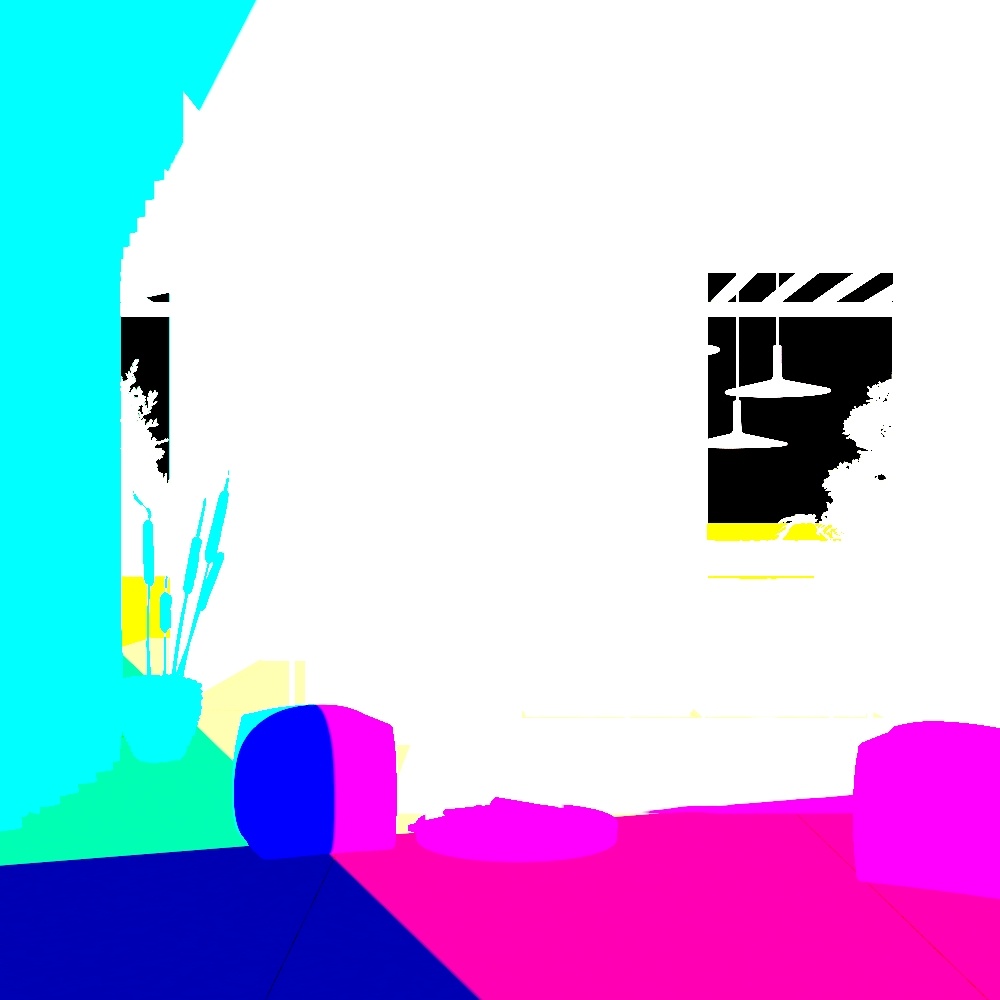

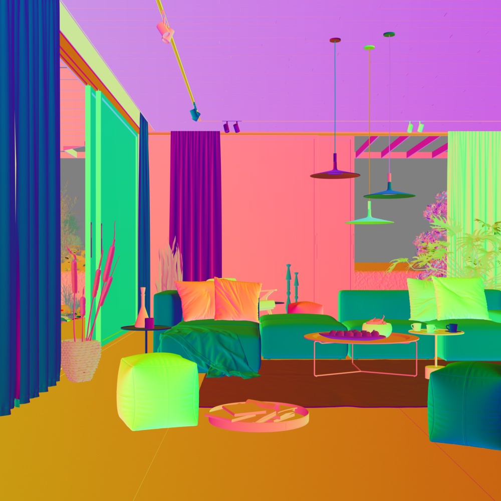

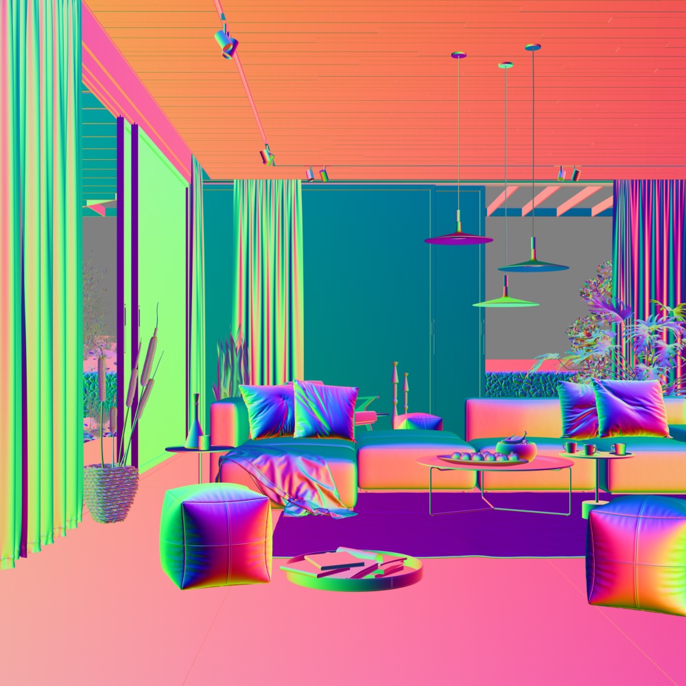

Sampler info

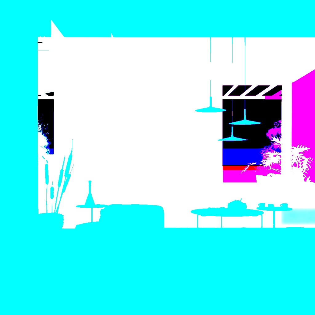

The Sampler Info Render Element is a color image that provides information about the scene, with the choice to show any of various aspects as color blocks.
The Sampler Info Render Element provides information about various aspects of the shaded points such as position, normal, bump normal, reflection/refraction vectors and UVW coordinates. This render element can be used either for world position passes or normal passes. It extracts particular information about the scene, converting the gathered information into RGB data for use in compositing.
Common Uses
The VRaySamplerInfoTex texture extracts particular information about the scene. It then converts the gathered information into RGB data that can be used for compositing.

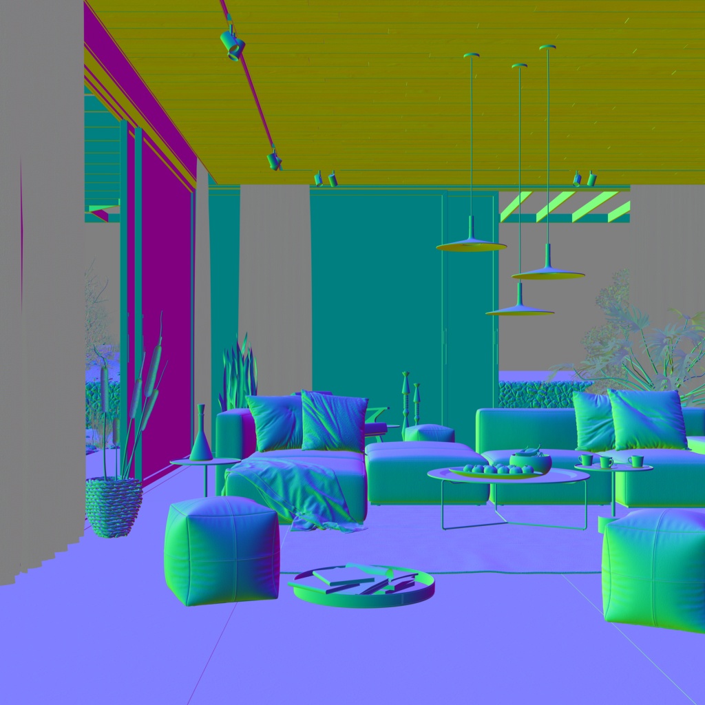

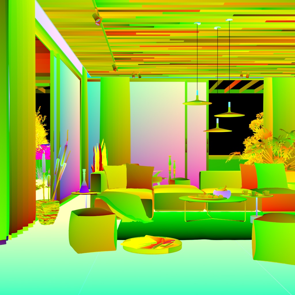

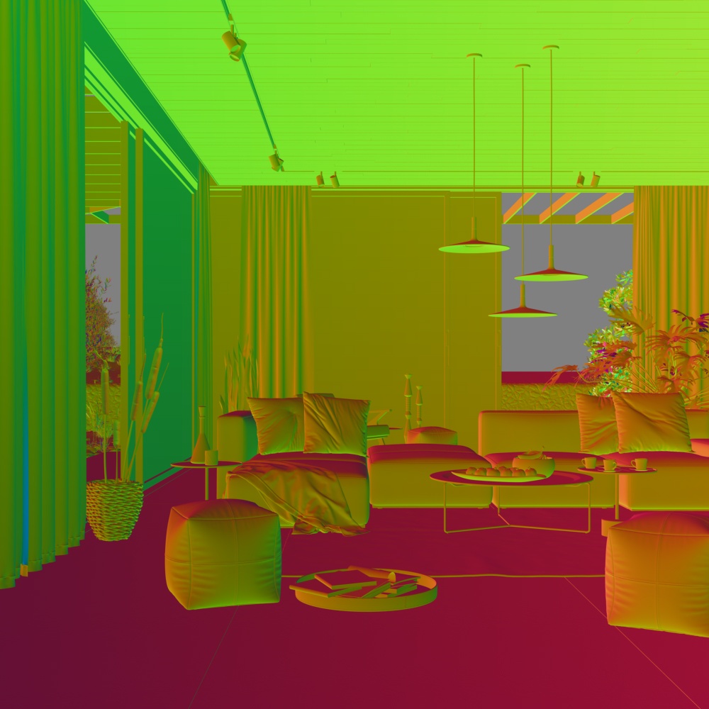

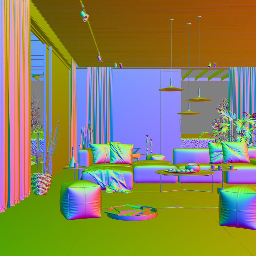

Sampler Info Render Element with Type set to Point (world space)
Sampler Info Render Element with Type set to Normal vector (world space)
Sampler Info Render Element with Type set to Reflection vector (world space)
Sampler Info Render Element with Type set to Refraction vector (world space)
Sampler Info Render Element with Type set to UVW coordinates
Sampler Info Render Element with Type set to Normal vector with bump mapping

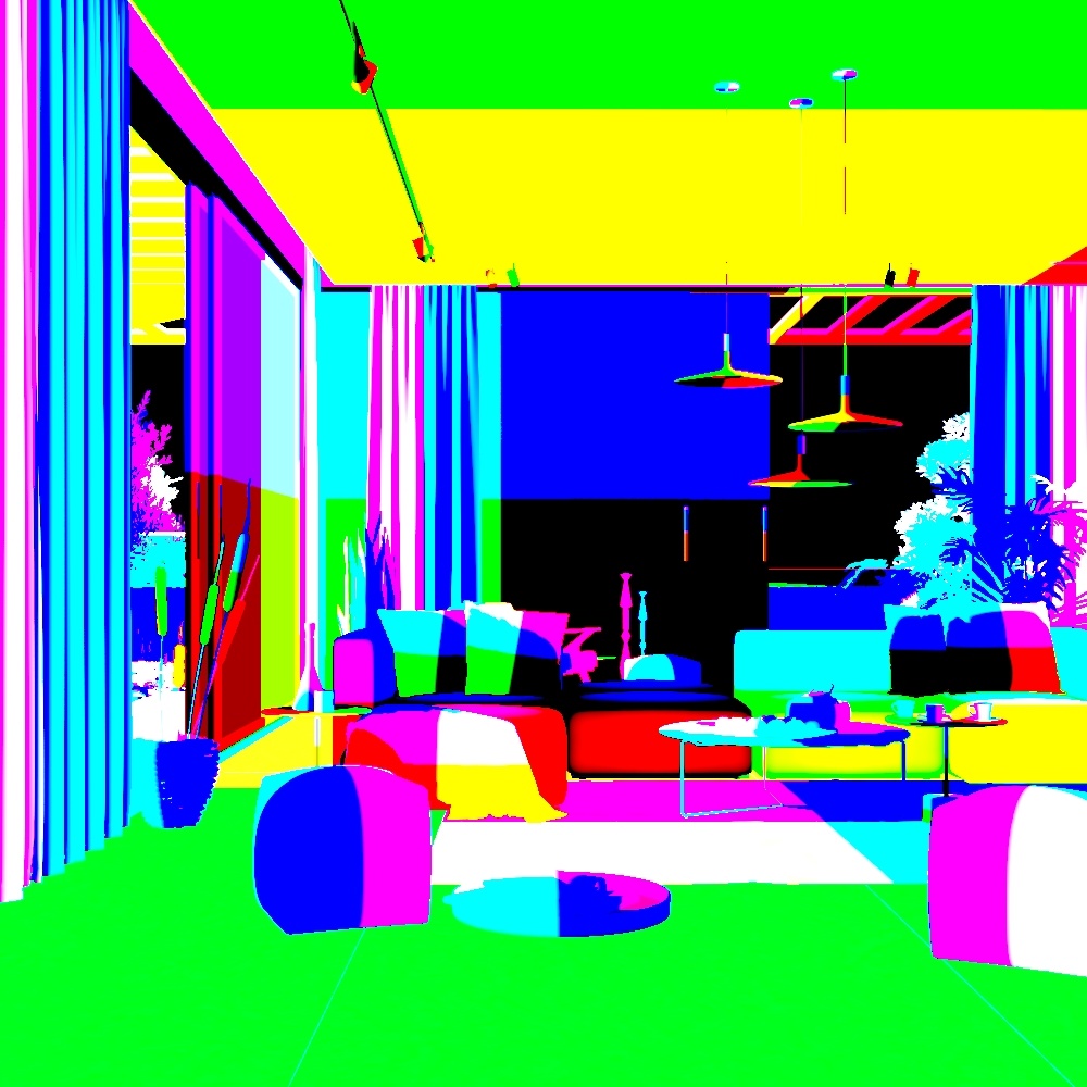

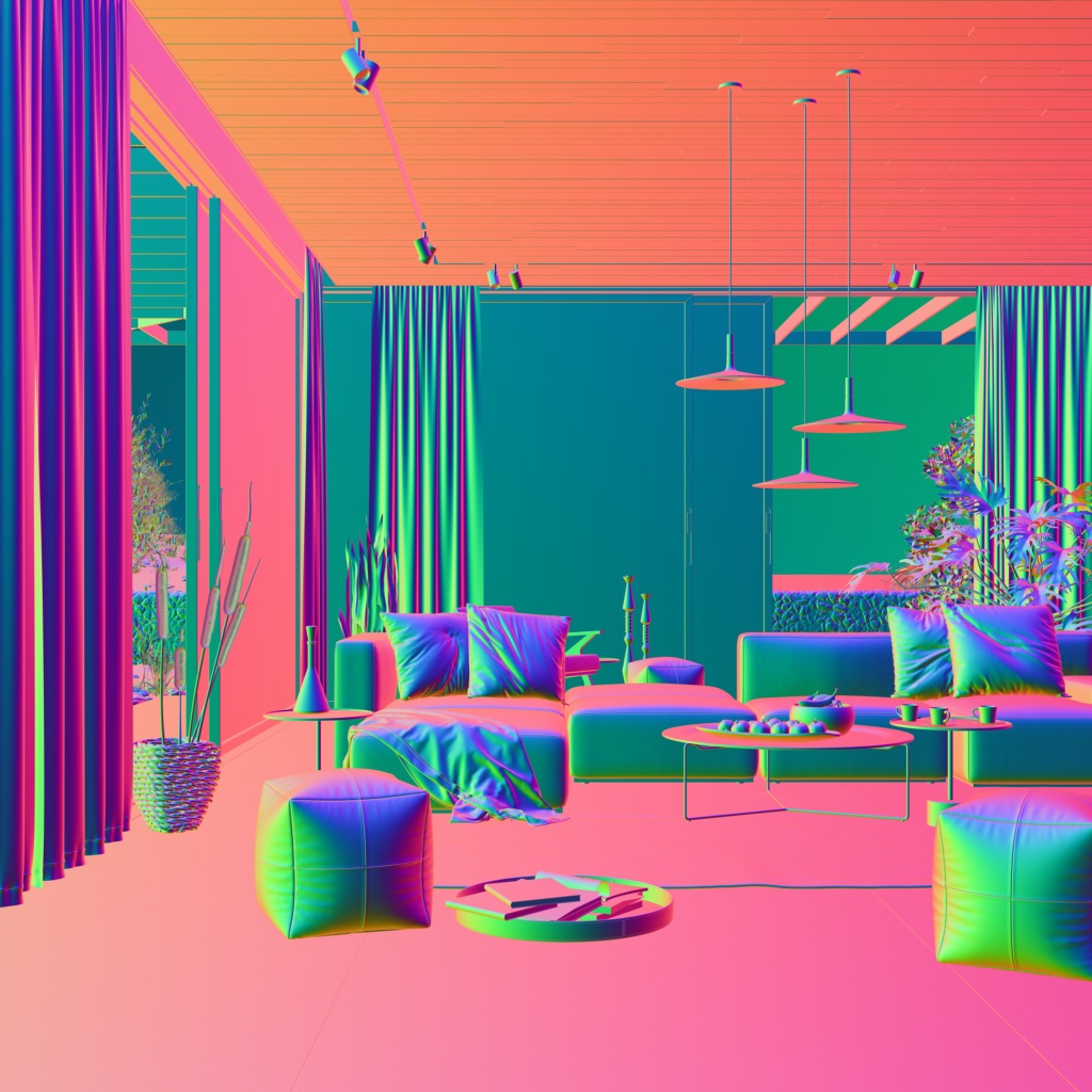

Example: Re-texturing in composite
Using the Sampler Info Render Element it is possible to apply a new texture to an already rendered still or sequence via setting its type to UVW coordinates. This then enables the creation of what effectively amounts to a new Diffuse Filter Render Element which can then be used in a composite, enabling a change of texture to be easily made. It is worth noting that any UV stretching on the model will carry through into the UVW pass created by Sampler Info as can be seen in the examples below.
The Sampler Info with type set to UVW coordinates
(uvw mode = normal)
Beauty render prior to re-texturing in composite
New texture image applied in composite.
(This effectively creates a new Diffuse Filter Pass.)
Re-textured Beauty render
(Done purely at a composite level)

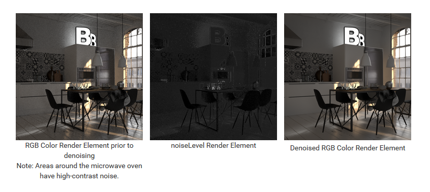

V-Ray Denoiser

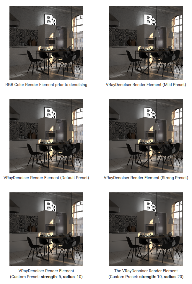

The Denoiser Render Element removes noise from other render elements and saves its results in a few different ways.
The Denoiser takes an existing render and applies a denoising operation to it after the image is completely rendered out via normal means. The denoising operation detects areas where noise is present and smooths them out.
Because the Denoiser operates on other render elements (such as Beauty | RGB_Color) rather than being part of the rendering process itself, the denoising operation does not require rerendering of the scene. The Denoiser settings can be quickly changed and tested over and over to improve the result.
The Denoiser has three preset options for its settings: Default, Mild, and Strong. Parameters can also be adjusted directly by selecting the Custom preset.
When rendering, the Denoiser automatically adds a few render channels in the V-Ray frame buffer which are required by the denoising algorithm. Some of them are standard render channels like the diffuse filter color, the reflection filter color etc. A few special channels are also generated:
  • The noiseLevel channel is the amount of noise for a pixel as estimated by the V-Ray image sampler.

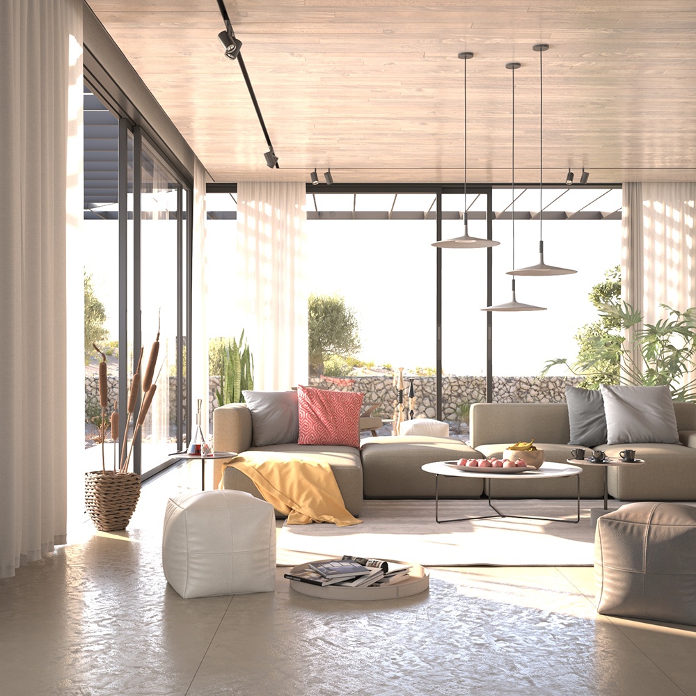

Example: Denoising Presets
The example below illustrates how Denoiser works using the presets. A purposely noisy render was set up using the Progressive Image Sampler Type with Render Time set to only 3 minutes to leave plenty of noise in the render. To better see the noise level in each image, click the image to see it at full size.

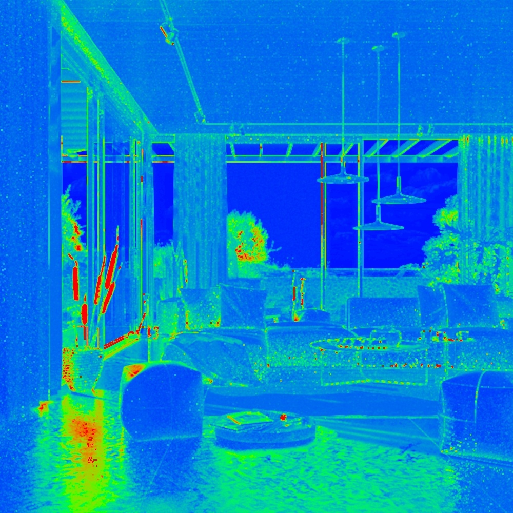

Example: noiseLevel Render Element
The noiseLevel Render Element shows where areas of noise have been detected in the scene. White areas have the most noise, black areas have no noise, and gray areas have varying levels of noise.
Image denoising takes place after the frame has been rendered and does not show up until all rendering has finished.
Textures or materials such as VRayStochasticFlakesMtl that could be considered to have a purposely noisy look are not considered "noisy" by the Denoiser, and are not affected by the noise removal process.
