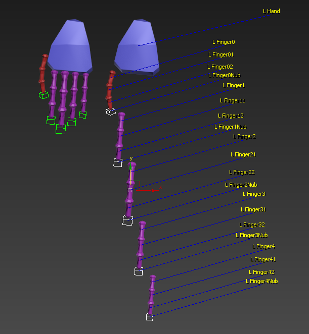

Hands
Left Hand | Right Hand |
Biped | Metropoly | Biped | Metropoly | L Hand | LeftHand | R Hand | RightHand | L Finger0 | LeftHandThumb1 | R Finger0 | RightHandThumb1 | L Finger01 | LeftHandThumb2 | R Finger01 | RightHandThumb2 | L Finger02 | LeftHandThumb3 | R Finger02 | RightHandThumb3 | L Finger0Nub | LeftHandThumbNub | R Finger0Nub | RightHandThumbNub | L Finger1 | LeftHandIndex1 | R Finger1 | RightHandIndex1 | L Finger12 | LeftHandIndex2 | R Finger12 | RightHandIndex2 | L Finger11 | LeftHandIndex3 | R Finger11 | RightHandIndex3 | L Finger1Nub | LeftHandIndexNub | R Finger1Nub | RightHandIndexNub | L Finger2 | LeftHandMiddle1 | R Finger2 | RightHandMiddle1 | L Finger21 | LeftHandMiddle2 | R Finger21 | RightHandMiddle2 | L Finger22 | LeftHandMiddle3 | R Finger22 | RightHandMiddle3 | L Finger2Nub | LeftHandMiddleNub | R Finger2Nub | RightHandMiddleNub | L Finger31 | LeftHandRing1 | R Finger31 | RightHandRing1 | L Finger3 | LeftHandRing2 | R Finger3 | RightHandRing2 | L Finger32 | LeftHandRing3 | R Finger32 | RightHandRing3 | L Finger3Nub | LeftHandRingNub | R Finger3Nub | RightHandRingNub | L Finger42 | LeftHandPinky1 | R Finger42 | RightHandPinky1 | L Finger41 | LeftHandPinky2 | R Finger41 | RightHandPinky2 | L Finger4 | LeftHandPinky3 | R Finger4 | RightHandPinky3 | L Finger4Nub | LeftHandPinkyNub | R Finger4Nub | RightHandPinkyNub |
