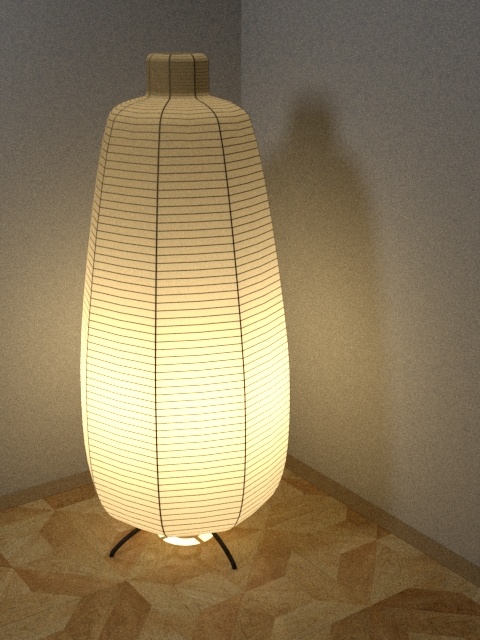

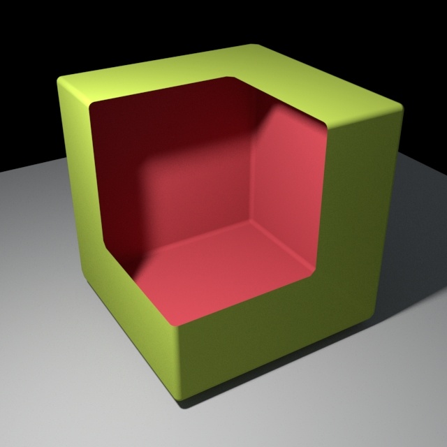

V-Ray 2 Sided Material
V-Ray 2 Sided Material is translucent material intended to simulate thin bodies - little or no volume. It's not a separate material but a utility node - it allows other materials to inherit its qualities. It will enable the light to flow bidirectionally through the object. The types of objects simulated with it include paper, thin fabric, curtains, blinds, and leaves. It's pretty fast to render, making it useful for translucent objects.
Opaque
See the comments in the "2Sided Simple.vrscene" file from the scene bundle.
Translucent
See the comments in the "2Sided Translucent.vrscene" file from the scene bundle.
The main plugin of interest is called Mtl2Sided.
  • front - this material will be used for front-side faces as defined by the object normals.
  • back - this is the material V-Ray will use for back side faces as defined by their normals.
  • translucency determines which side (front or back) relative to the camera is more visible in the rendering process. By default, this value is 0.5, which means that both the side facing the camera and the one facing away from it will be visible to the same degree. When this parameter is closer to 0.0, more of the material facing the camera will be seen. When closer to 1.0, more of the back material is seen.
  • force_1sided - when it is on (the default), the sub-materials will be rendered as one-sided materials. Turning this option off is not recommended.
