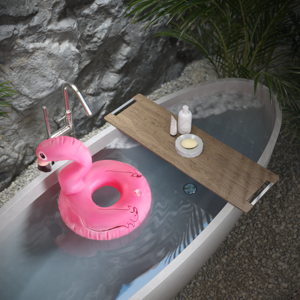

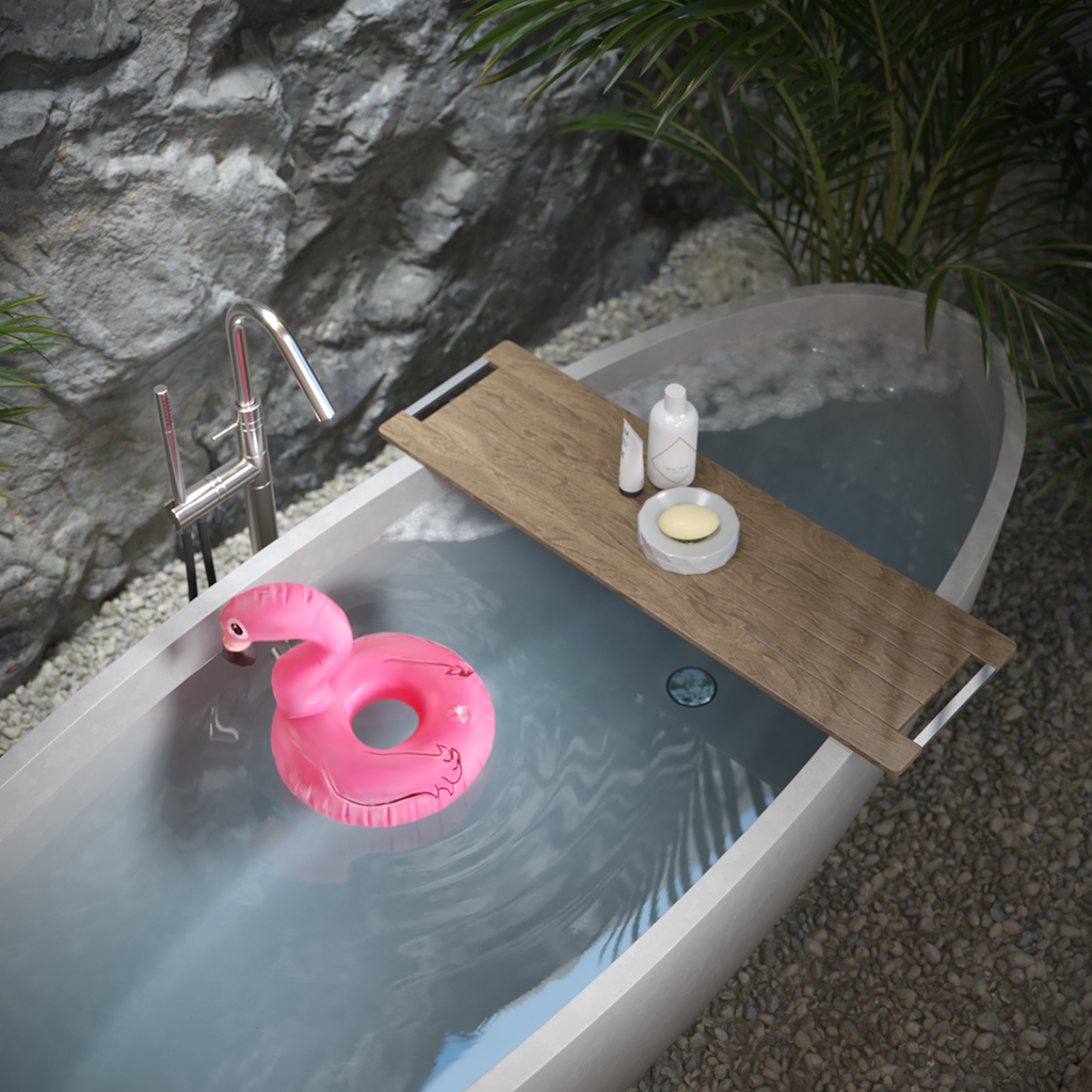

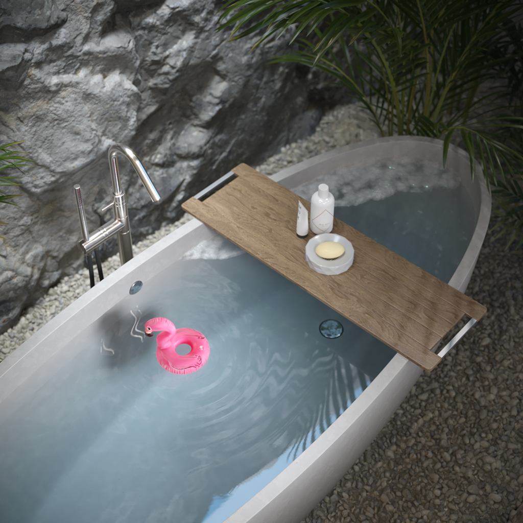

Example: scale
This example shows Gaussian Splat used as an individual object - the pink flamingo floatable in this scene. It can be scaled as any other object in the scene, using the scale parameter.
scale = 0.5
scale = 1
scale = 1.5
