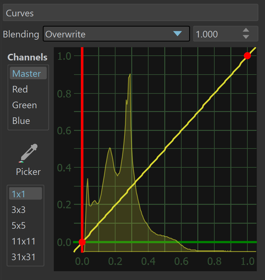

Curves
This correction allows you remap the image colors with a Bezier curve. The control also allows you to save and load .acv curve files from Adobe Photoshop. Controlling the ViewUse the mouse wheel to zoom in and out of the curve view. Drag with the middle mouse button to pan. Controlling the Bezier PointsClick on a point to select it. Draw a rectangle to select multiple points at once. Click and drag on a selected point or its tangents to move them. To add a new point, Ctrl+click on the curve. To delete points, select them and press Del, or alternatively, Shift+click on a point. Once a point is selected, you can also use the input coordinates field to modify its position. To display the input coordinates field, either press Enter or right-click on the point and then select Edit point. Right-click on a point to bring up a context menu with additional options for that point.
Context MenuRight-clicking in the curve view brings up a context menu with additional options: Menu Item | Description |
Themes |
| Zoom all | Adjust the curve view so that all points are visible. | Undo/Redo | Undo and redo modifications to the curve. | Load | Load the curve control from a file. Two formats are available: native .bcurve and Photoshop .acv. | Save | Save the curve control to a file. Two formats are available: native .bcurve and Photoshop .acv. | Reset Master | Reset the curve control to its default state. | Select internal only | Select only the points that are currently visible in the curve view. | Select all | Select all points. | Snap to grid | Toggle snapping to the curve grid. When enabled, moving points snaps them to the grid nodes. |
When working with .acv files, some approximations are performed because the curves in the .acv files are described by different mathematical formulas. |

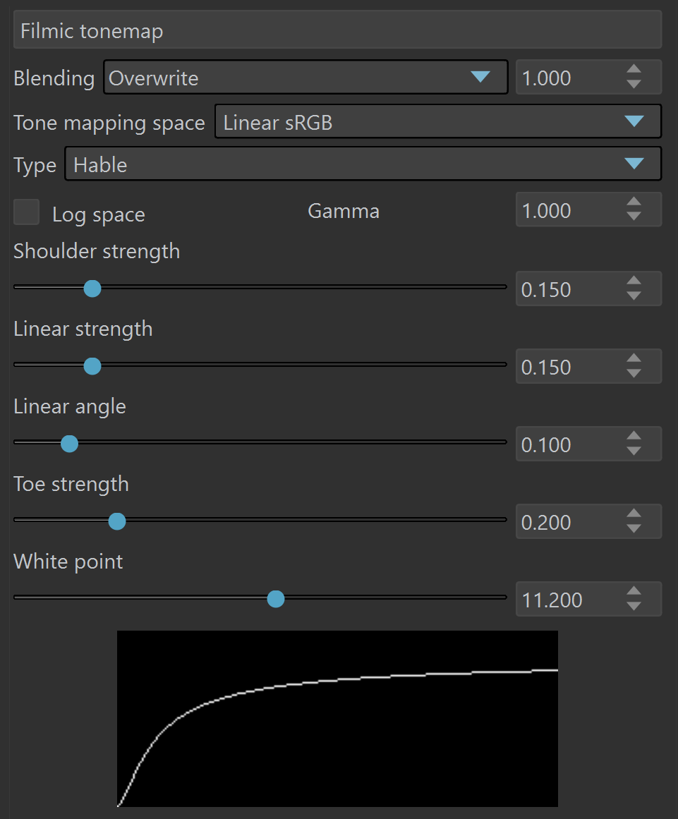

Filmic Tonemap
This correction allows you to control different types of mapping curves, make gamma correction and select a color space. Note that color values are mapped per channel. Tone mapping space – Specifies the color space where the operator is applied. Converts the image to the selected space and back, if needed. You can choose between Linear sRGB and ACEScg. Type – Specifies the type of curves used for the tone mapping. You can choose between Linear, Hejl-Dawson, AMPAS (ACEScg), Hable, and Power Curve. Log space – Converts the image to log space before applying the tone mapping. Gamma – Specifies the gamma correction. It is applied before the operator. Use blue fix – Applies an additional transformation to ACEScg primitives that results in pure blues burning out through cyan instead of magenta. Available when Tone mapping is ACEScg. AMPAS (ACEScg)AMPAS mode applies an approximate ACES standard curve. Hejl-Dawson TypeShadows – Shadow compression. Higher values darken the shadows, while also brightening the mid tones. Highlights – Highlight compression. Higher values reduce burnout. Hable TypeShoulder strength – Determines how sharp the shoulder is. Higher values sharpen the shoulder, which results in an overall brighter image. Linear strength – Determines the strength of the effect from changing Linear angle. Linear angle – Determines the angle of the curve at the base. Higher values increase the angle. Toe strength – Low to mid tone compression. Higher values darken the low and mid tones. White point – The intensity, which gets mapped to 1. This parameter scales the whole curve evenly. Power Curve TypeToe length – Determines the range of low to mid tones that are compressed. Toe strength – Low to mid tone compression. Higher values darken the low and mid tones. Contrast – Higher values increase the contrast between low and high tones. Shoulder length – Determines the range of mid to high tones that are compressed. Shoulder strength – Mid to high tone compression. Higher values darken the mid and high tones. White point – The intensity, which gets mapped to 1. This parameter scales the whole curve evenly. |
