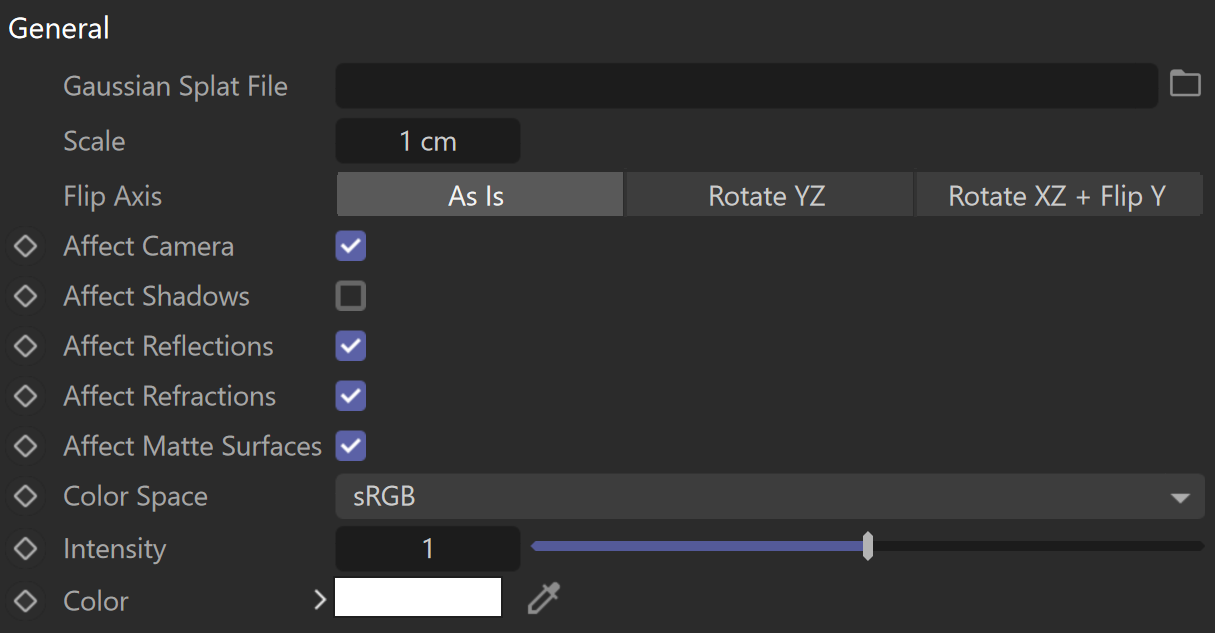

General
Gaussian Splat File – Loads the Gaussian splats file. Currently, only .ply files are accepted.
Scale – Scales the Gaussian splats up and down.
Flip Axis – Controls which axis is used as a vertical - the Y or Z axes for the loaded file. You can choose between:
As Is – No changes in the axes are applied.
Rotate YZ– Switches the Y and Z axes.
Rotate XZ + Flip Y – Switches the X and Z axes and flips the Y axis.
Affect Camera – Specifies whether the Gaussian splats should be visible to the camera. See the example.
Affect Shadows – When enabled, Gaussian splats block shadows from lights. When disabled, the Gaussian splats become transparent to shadow and GI rays. It is recommended that this option be turned off when using the Gaussian splats as environment or individual objects. See the example.
Affect Reflections – Specifies whether the Gaussian splats should be visible in reflections. See the example.
Affect Refractions – Specifies whether the Gaussian splats should be visible in refractions. See the example.
Affect Matte Surfaces – When enabled, Gaussian splats appear as part of the background on matte surfaces. It is recommended to enable this for Gaussian splats used as an environment and disable it for Gaussian splats used as individual objects. See the example.
Color Space – Specifies the color space of the data in the Gaussian splats file.
Default – Takes the current color correction that is set in Maya. That means it does not change the colors.
To read the Gaussian splats file as it was written, select the respective input color space - sRGB, ACEScg, or Raw.
Intensity – Increases or decreases the Color multiplier for the Gaussian splat.
Color – Specifies a filter color for the splat. By default, the Color is white, which does not affect the splat. See the example.
