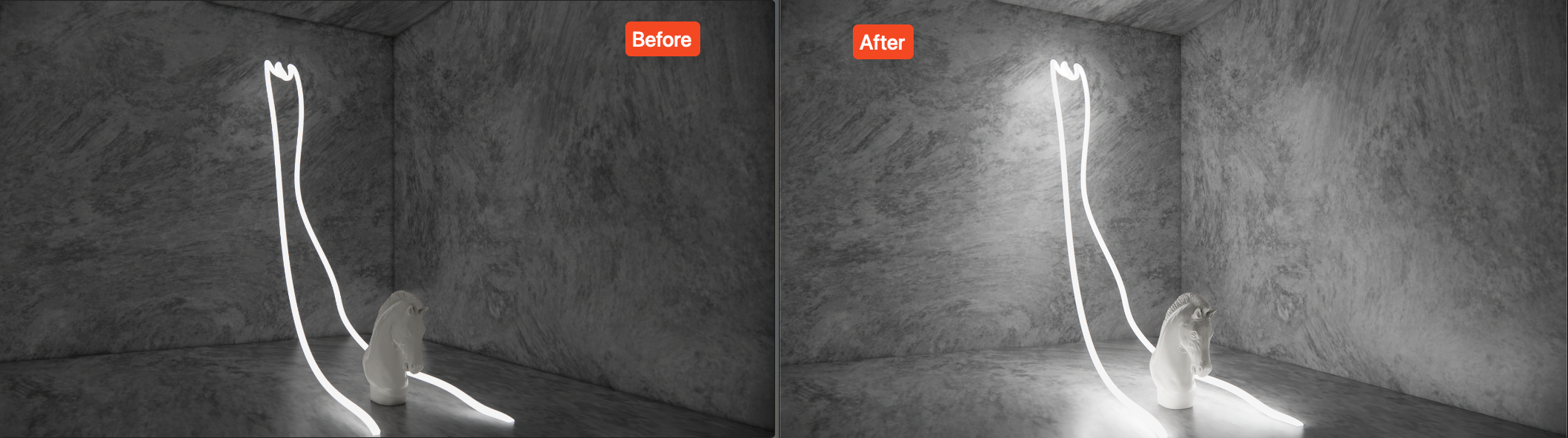

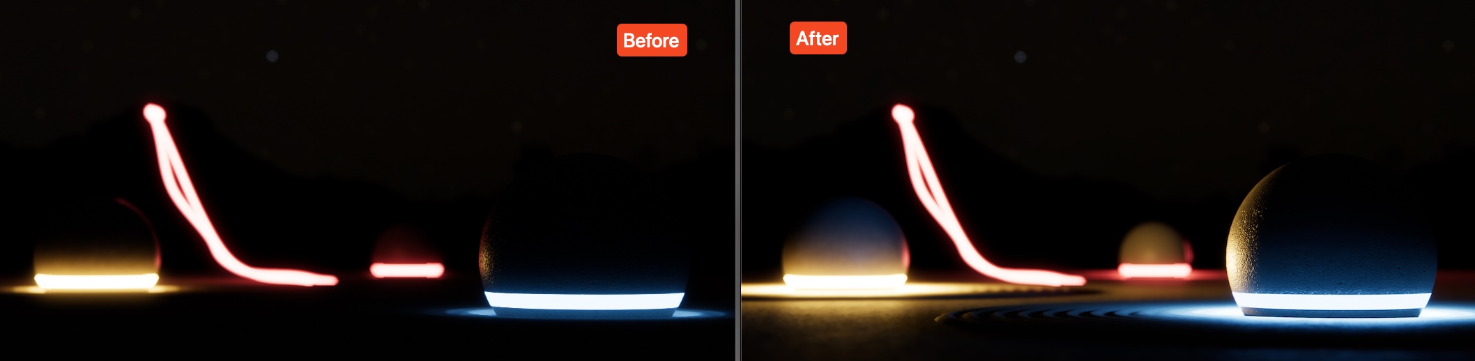

Emissive Materials as Ray-Traced Light Sources: Emissive materials now behave as true light sources when hardware ray tracing is enabled. This ensures more predictable lighting, reduces noise artifacts, and removes the need for inefficient modeling workarounds (e.g., manually placing thousands of light sources).
Cleaner, more consistent lighting behavior across all emissive materials.
Enhanced filtering and sampling methods minimize noise and ensure efficiency in both small and large-scale projects.
Matches the behavior of analytical and mesh lights for greater realism.
Please Note: This feature requires hardware ray tracing.
Screenshots:
