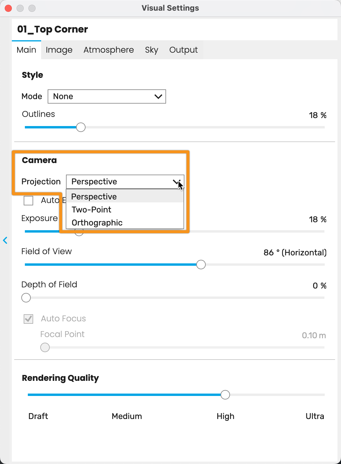

Firstly, via the Enscape Visual Settings window.
NOTE: only the ‘Perspective’ Projection option is available in VR.
The button to open the Visual Settings dialog
Projection menu in the Visual Settings dialog

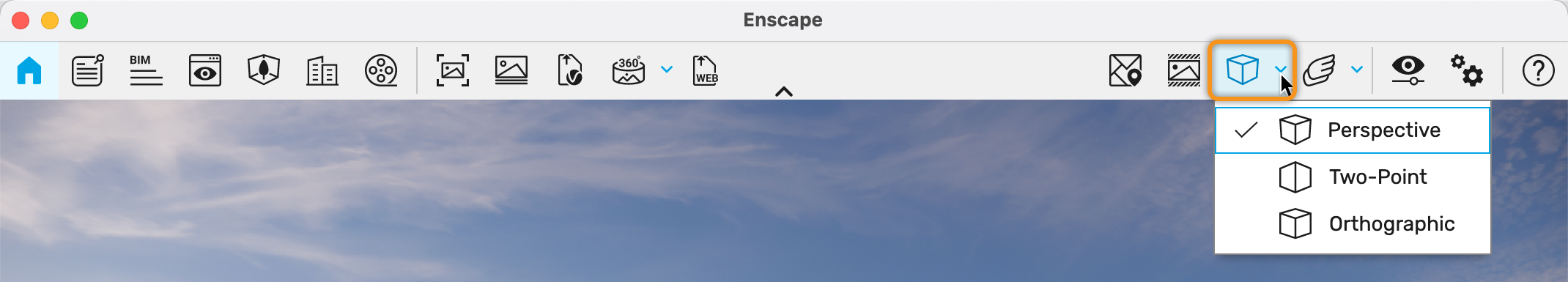

Or, you can directly select Projection via its associated button, located in the Enscape Viewport User Interface (UI) which should be found  at the top of the Enscape Viewport.
If you can not see these UI, make sure to click on the small chevron located mid top of the Enscape Viewport to expand the toolbar.
Projection mode button and menu in the Enscape User Interface

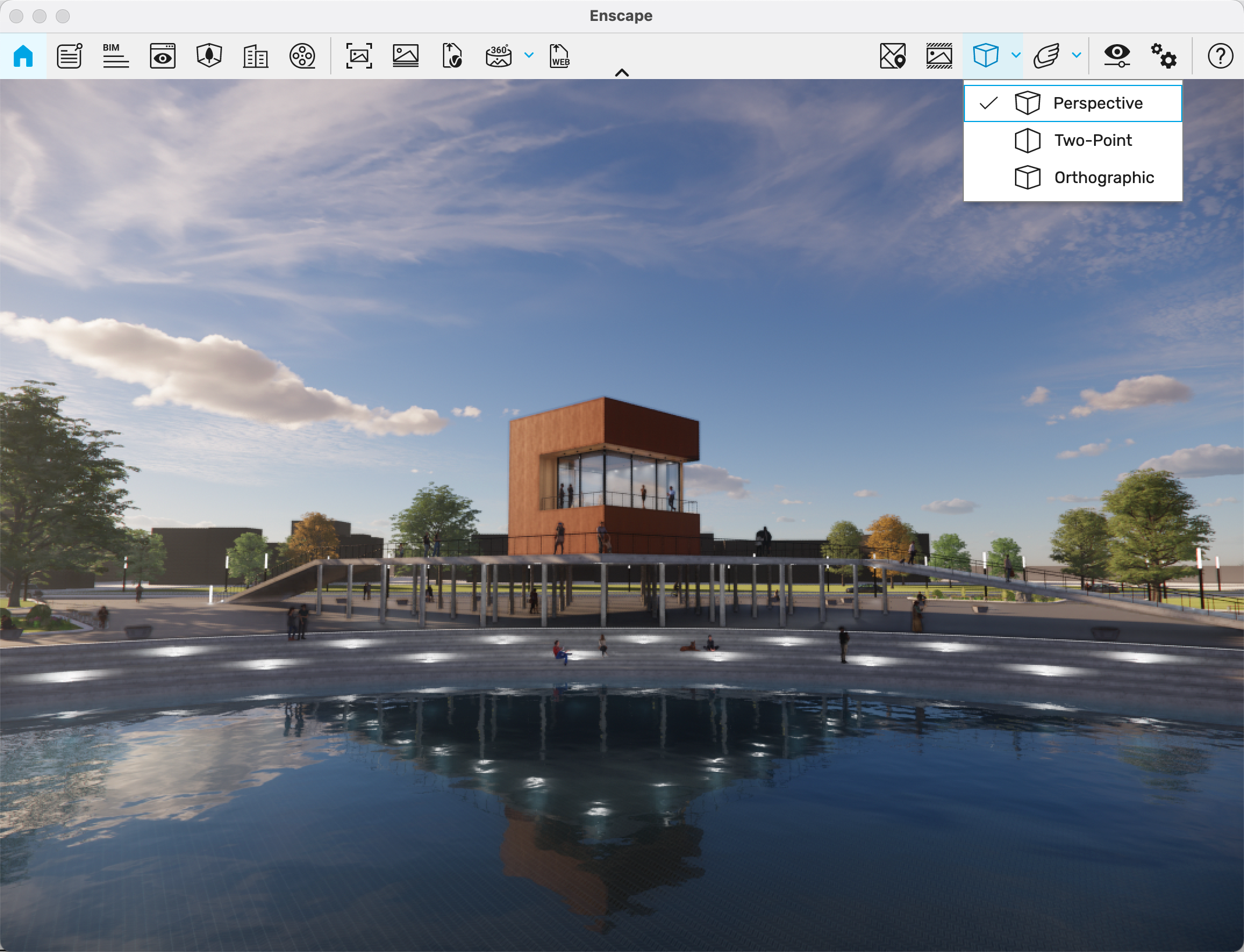

Perspective Projection
By default Projection is set to Perspective, as shown in the following screenshot. Click on the symbol to reveal the other two options for Projection.
Enscape in Perspective Projection mode

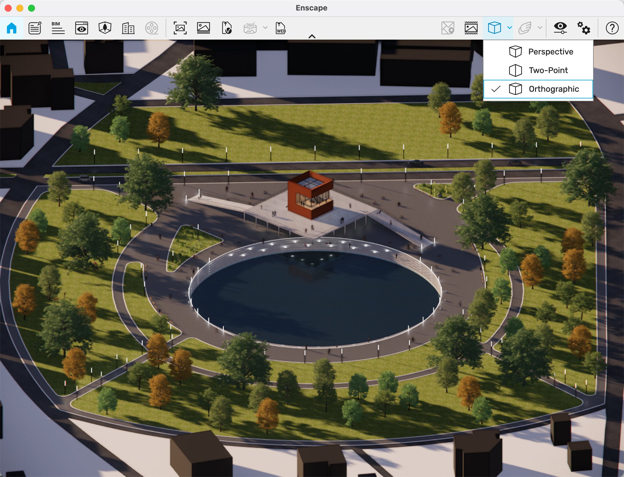

Orthographic Projection
Here, you can see Projection set to Orthographic:
Orthographic Projection Mode

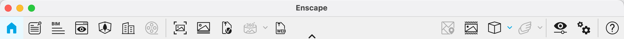

When Orthographic is selected, the Depth of Field, Focal Point, and Field of View options, under the Enscape Visual Settings’ Main tab, will be disabled or will not be available at all.
Furthermore, the buttons for the Video Editor, Panoramas, Minimap, and Navigation Mode will be disabled in the Enscape viewport UI.
Enscape Toolbar buttons disabled when in Orthographic Projection mode

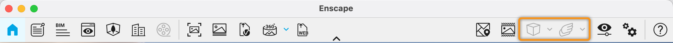

The options for Projection will only take affect when Synchronize Views is disabled.
When Synchronize Views is enabled, this will result in the Projection being always synchronized from the CAD application and being automatically locked in Enscape for as long as Synchronize Views is enabled.
Disabling Synchronize Views will unlock the Projection options again and return it to whichever Projection had previously been set by the user.
Synchronized Views is enabled resulting in Projection Type buttons being locked
