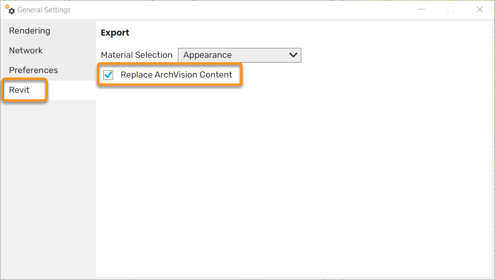

  • Go to the Enscape General Settings window and then click on the Revit tab
  • You will see an option “Replace Archvision Content”
  • When unchecked, it will use the standard Archvision RPC’s but you will have to restart the program for the changes to take effect.
  • It is checked by default and it will use the Enscape 3D models
Location of the Replace ArchVision Content checkbox in the Enscape General Settings window
