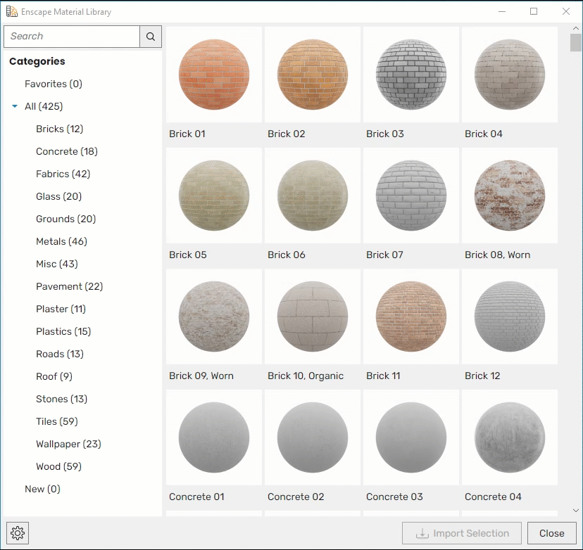

Either way will result in the Material Library dialog opening:
The Enscape Material Library dialog window

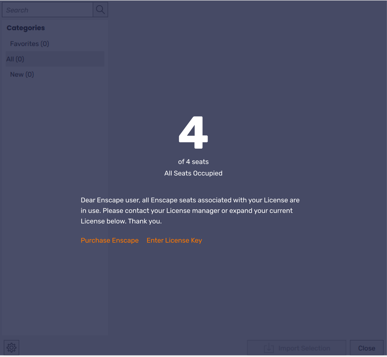

Being one of Enscape’s Core Features, where a license is invalid expired, whether that be a full or the 14 day trial license, or there are no seats available on a floating license, then the Material Library will be blocked from being used and you will see a notification similar to that shown below, depending on the cause. For more information please refer to this article.

You can select multiple material’s to import at one time, clicking the Import Selection button becoming available when at least one material is selected.
Furthermore, you can Favorite materials by clicking on the star buttons in at the top left corner of the tiles. These are then shown in the Favorites folder. Just click on the star again so it is not solid to remove materials from the Favorites folder.
New materials that get added over time by Enscape will show in the New folder, as well as being listed under their respective category.
Favorite and select a material to be imported to the Material Library
Once the import process has finished you will find the material listed in the Enscape Material Editor, where you can further edit the material if required.
