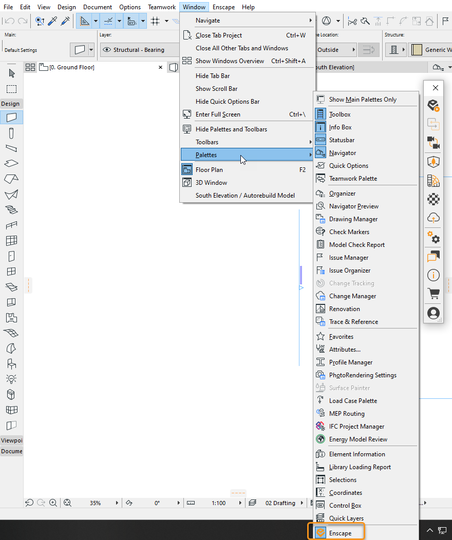

Once installed, the Enscape plugin can be found in the Window > Palettes menu. Here you can see the Enscape Palette to the far right.
Open the Enscape Palette

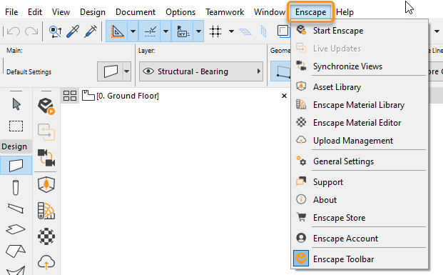

You should also have, by default, an Enscape menu option in the Archicad top menu, which you can then click to reveal all the Enscape options.
Enscape in top-level Archicad menu

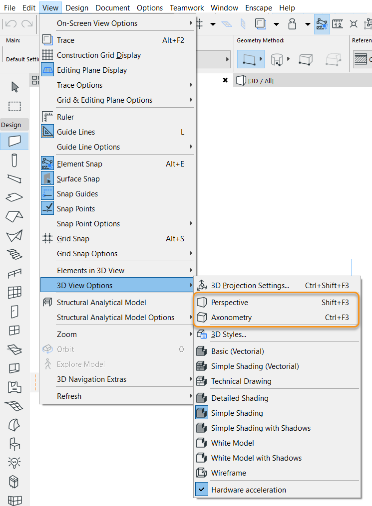

  • Open your Archicad project file and make sure you have either a Perspective or Axonometry view open.

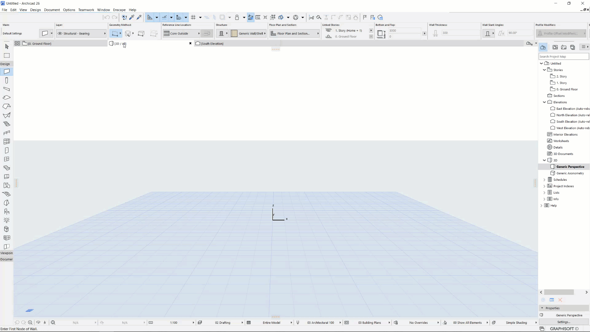

You can leave Enscape open while you make any desired changes in Archicad (e.g., cross sections, materials, or geometric changes in the model). Your changes show up instantly, as long as you have activated the Live Update in Enscape. Activating the Synchronize Views syncs the perspective view from Archicad to the Enscape window.
Open the required view in ArchiCAD
