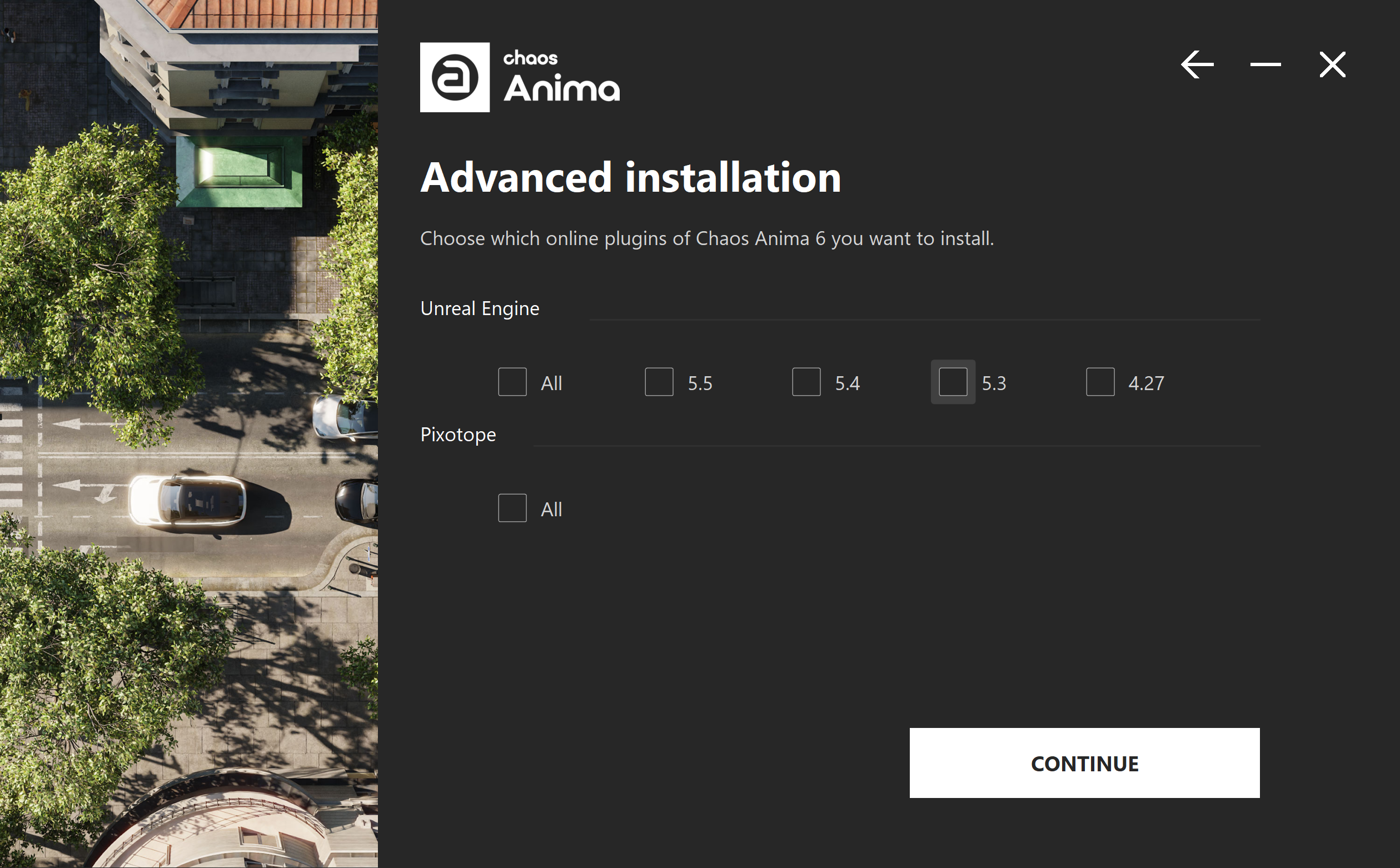

Advanced Installation Host Apps
Choose which Chaos Anima plugins should be installed along with the standalone Anima Designer.
To open a second screen of options, press More.
