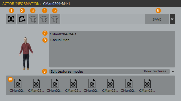

PARAMETERS
Actor Information
  1. Snapshot Thumbnail
    Takes a snapshot of the current character and sets it as the thumbnail
  2. Import Thumbnail
    Opens a file browser so you can load a thumbnail from disk. File formats supported are JPG, PNG, and TGA.
  3. Add New Variation
    Click this button to add a new color Variation for the selected character. Only available when Edit Textures mode is set to Generate Variations.
  4. Delete Current Variation
    Click this button to delete the active color Variation for the selected character. Only available when Edit Textures mode is set to Generate Variations.
  5. Randomize Current Variation
    Click this button to randomize the parameters of the color Variation for the selected character. This can be a very fast way to quickly create a lot of variations and works well as the starting point for custom colors. Only available when Edit Textures mode is set to Generate Variations.
  6. Save
    Save the changes to the selected character.
  7. Custom Name
    The name of the selected character. If this is an imported character the file name will be used automatically but you can edit it here.
  8. Description
    A description of the selected character. You can use this to include any useful information about the actor.
  9. Edit Textures Mode
    Sets the Texture editing mode. Use Show Textures to give you instant access to all available maps for easy manipulation in a 3rd party photo editing program. Use Protect Range to control which Material and parts of the maps are affected by the color variations features. Use Generate Variations to create color variations for your models in just a few clicks.
  10. Texture Maps
    Show a list of all the texture maps used on the selected actor. Double click one of these to open a folder where they will be available for editing in a 3rd party app.
