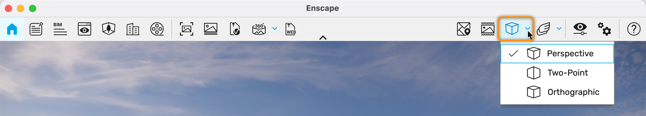

Or, you can directly select Projection via its associated button, located in the Enscape Viewport User Interface (UI) which should be found at the top of the Enscape Viewport. If you can not see these UI, make sure to click on the small chevron located mid top of the Enscape Viewport to expand the toolbar. |
Projection mode button and menu in the Enscape User Interface |

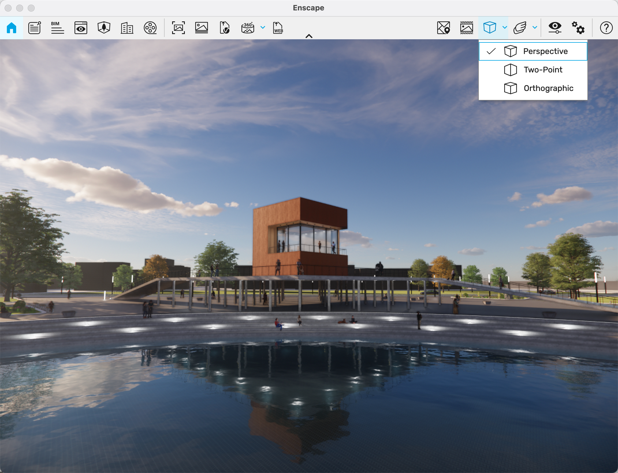

By default Projection is set to Perspective, as shown in the following screenshot. Click on the symbol to reveal the other two options for Projection. |
Enscape in Perspective Projection mode |

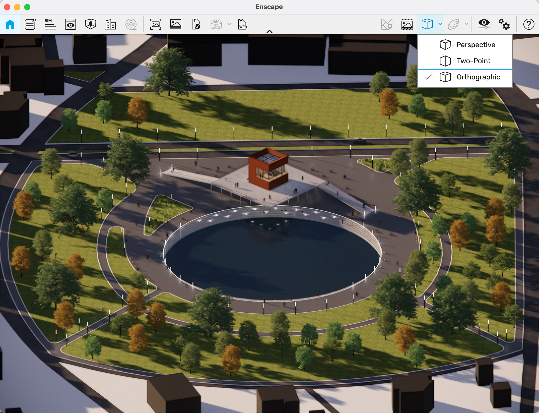

Here, you can see Projection set to Orthographic: |
Orthographic Projection Mode |
When Orthographic is selected, the Depth of Field, Focal Point, and Field of View options, under the Enscape Visual Settings’ Main tab, will be disabled or will not be available at all.

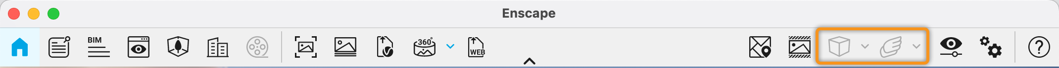

Furthermore, the buttons for the Video Editor, Panoramas, Minimap, and Navigation Mode will be disabled in the Enscape viewport UI.
Enscape Toolbar buttons disabled when in Orthographic Projection mode |
