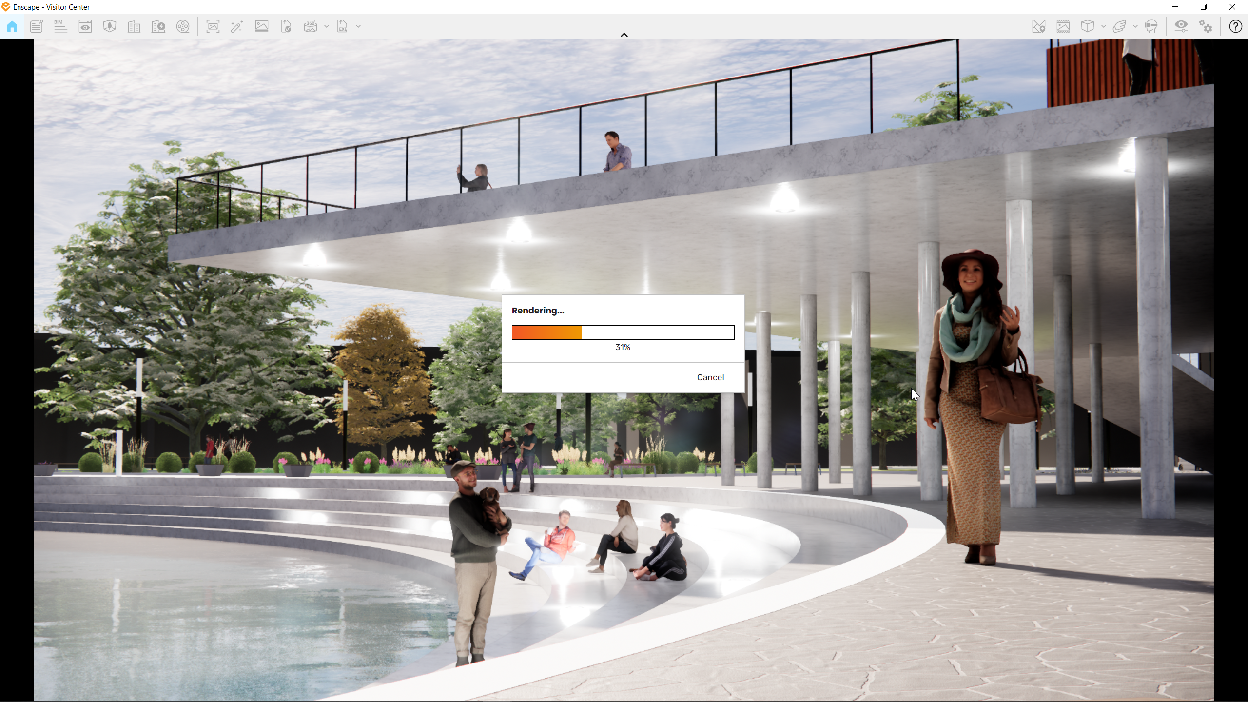

To start using the AI Enhancer, simply go to a named view or navigate inside your Enscape viewport to set up a view you want to export. The AI Enhancer works similar to the Screenshot button. However, the screenshot is exported to your Chaos Cloud account for enhancement. Simply click on the AI Enhancer button and a status window will pop up confirming that your screenshot is being rendered. |
Rendering Image |

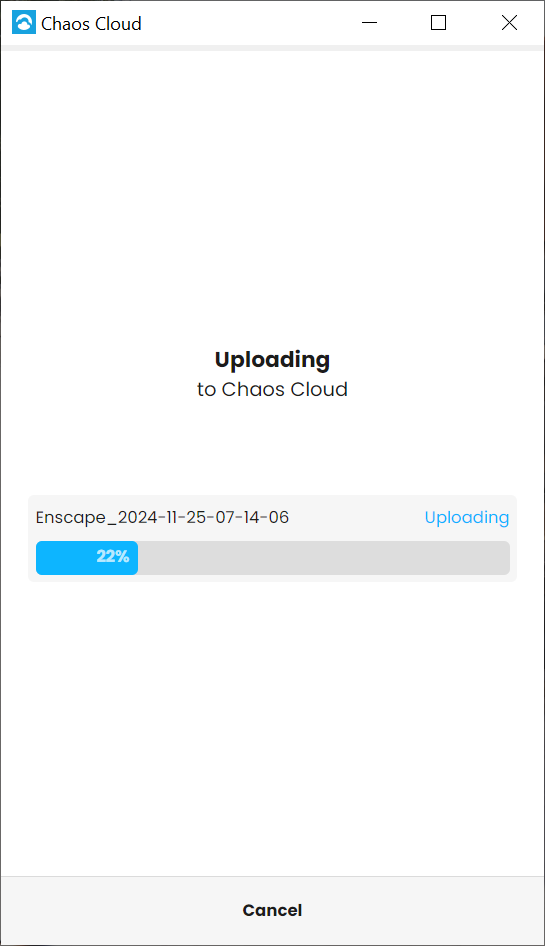

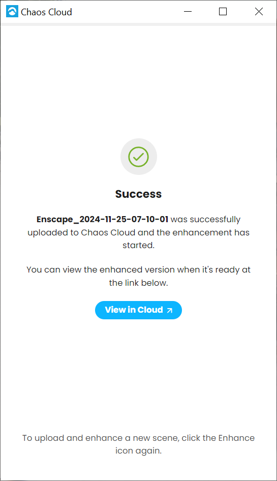

When you click Upload and enhance, you will be able to view the status bar for your upload. When the image has been successfully uploaded, you will be notified in that window, and a button ‘View in Cloud‘ will show up. When you click this button, it will open the exported screenshot in your Chaos Cloud account.
Upload Status Bar |
View in Cloud Button |

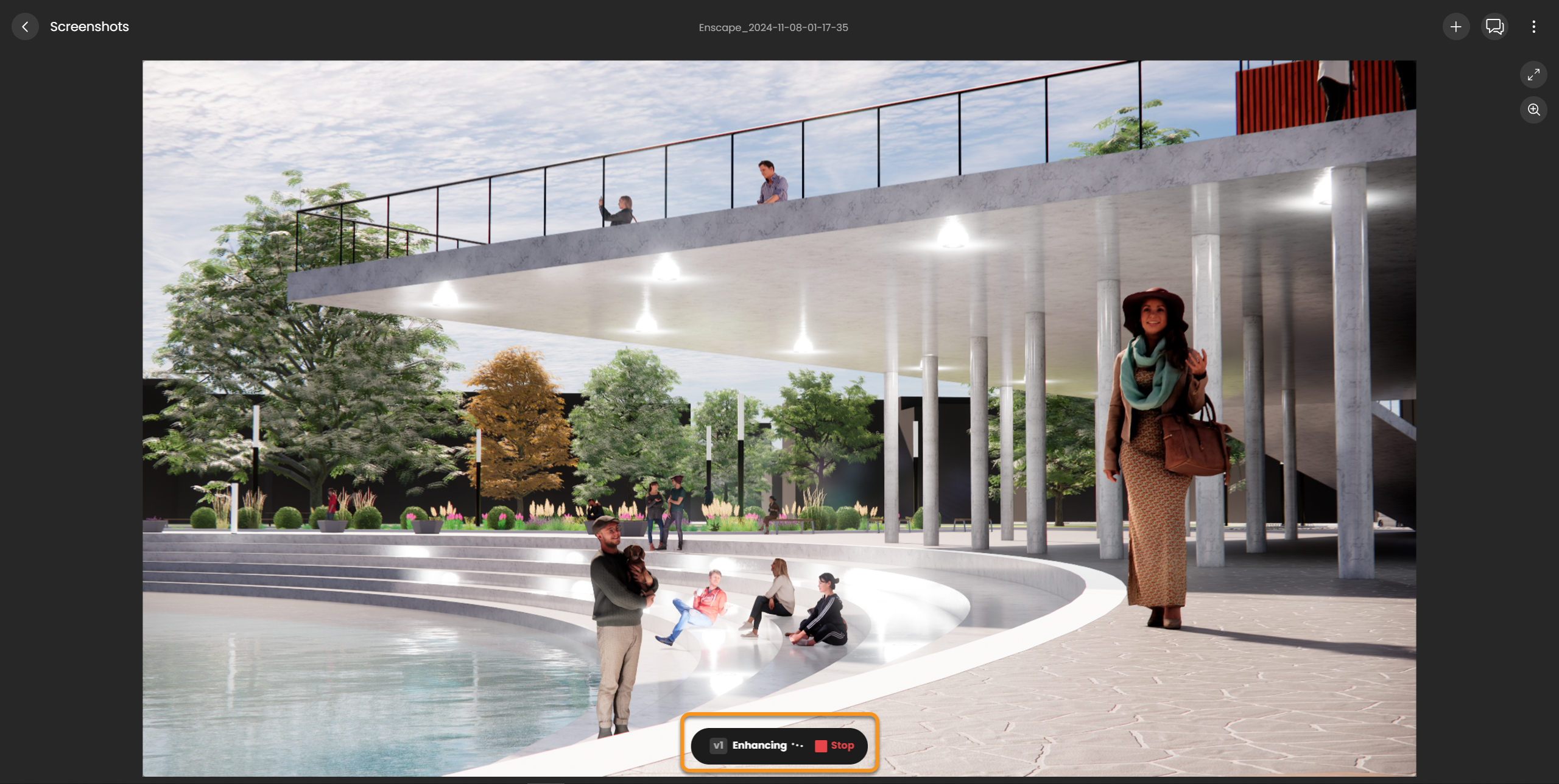

By opening up the exported screenshot in your Cloud Account, you will be able to view the Enhancing… status at the bottom. |
Enhancing your image |

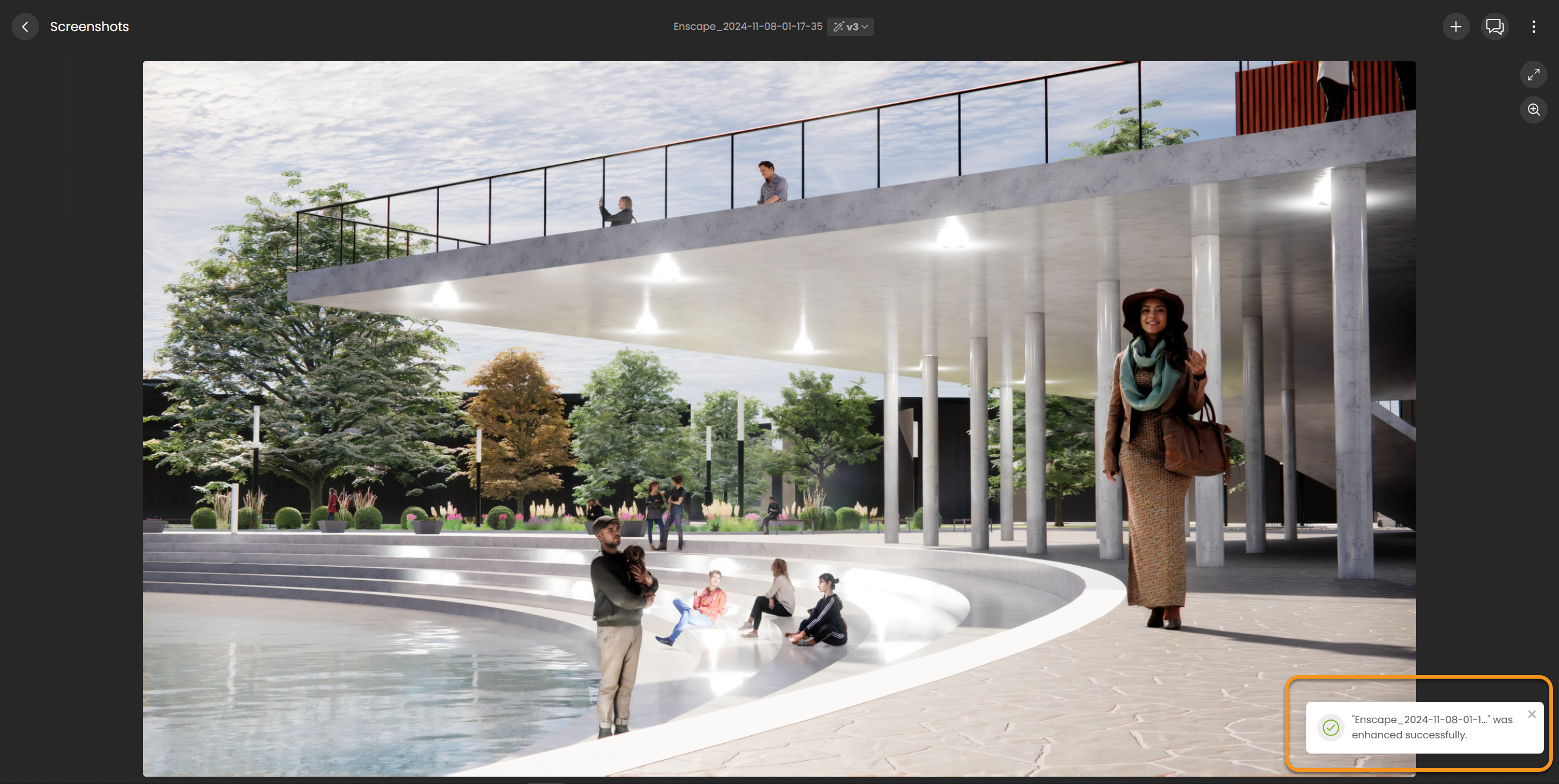

Once your image is enhanced, the enhanced version of the image will automatically open up, and a notification will pop up, confirming that your image was enhanced successfully. |
Image enhanced successfully |
You can use the compare versions feature in your Chaos Cloud account to compare the original and the enhanced version of your image as shown below. You can keep on uploading additional renders through the AI Enhancer button in Enscape. This will not stop you from using Enscape. The enhancement takes place directly in your Chaos Cloud account. To learn more about the AI Enhancer, check out the video tutorial. |
