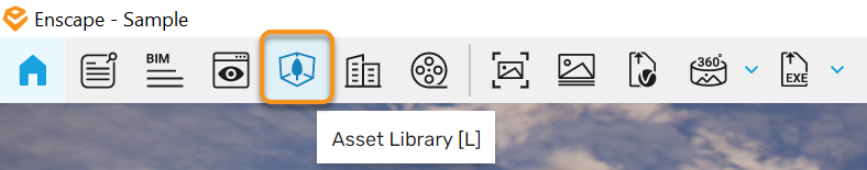

Asset Placement is achieved via the Enscape Asset Library which can be accessed in one of two ways. Either from within the CAD toolbar or from within the Enscape Viewport User Interface (UI) toolbar. This is covered in more detail in this article. This feature is available for both Enscape and Custom Assets, but the complete feature is only available when the Asset Library is opened via the Enscape Viewport UI. The Asset Library dialog that is opened via the CAD toolbar only allows for basic Single Asset Placement. But, once an asset has been placed, it then becomes available to be edited using the tools accessed via Asset Library when opened from within the Enscape Viewport UI. This article focuses on the initial placement of assets via both methods and begins with explaining the tools available in the Enscape Viewport UI, followed by the placement methods available in Rhino. If you find the Asset Library window, or the Enscape Viewport is blocked by a notification stating that no seats are available on the current License Key, or that the License has expired, then please refer to this article. |
Asset Library button in Rhino
Asset Library button in the Enscape Viewport UI |
Asset Library in Enscape

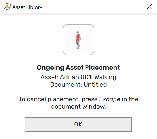

When Asset Placement is in progress in the CAD Viewport UI, placement can take place simultaneously in the Enscape Viewport as well. However, a notification will be shown, reminding you that there is an ongoing placement in progress. In case of conflicting changes, CAD Viewport takes priority. |

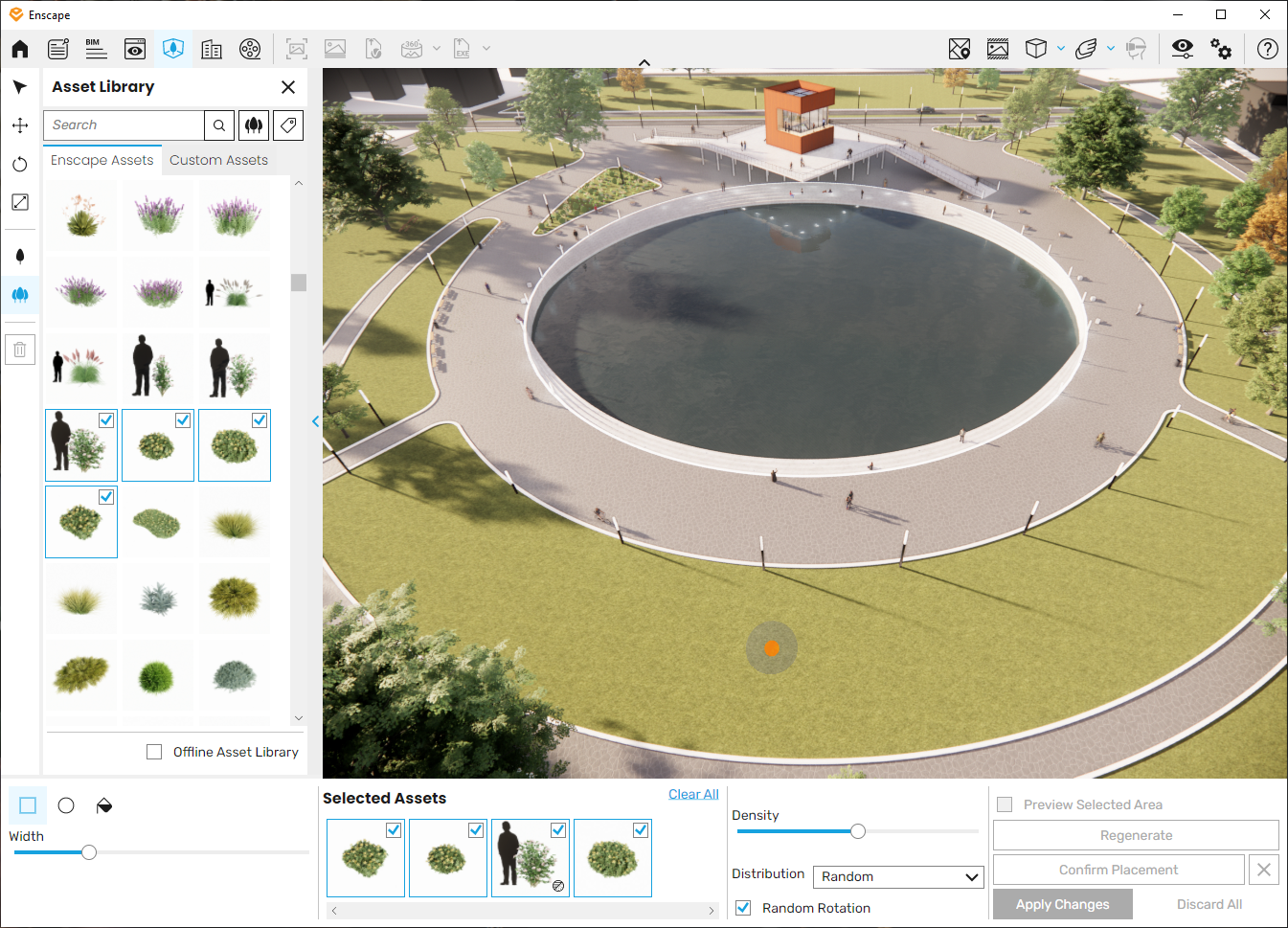

Multi Asset Placement
To speed up the asset placement process on large surfaces you can use the Multi Asset Placement tool. After clicking on the Multiple Asset Placement icon additional options will become available below the Asset Library. |
Multiple Asset Placement menu |

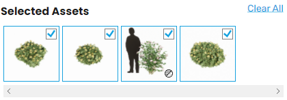

The first step to placing multiple assets is to select all the assets to be placed. Single or multiple assets can be selected and selected assets will receive a check box and will also be shown under the Selected Assets area at the bottom of the Enscape Viewport UI. |
Selected Assets |
Click the checkbox in the asset thumbnail either in the Asset Library panel or under the Selected Assets area to remove individual assets from the selection. To remove all assets at once click the Clear All option in the Selected Assets area.
If Confirm Placement is clicked, the current placement can be undone by clicking Discard All.
If assets are added, or removed by unchecking them, all assets in the current selection will be repositioned. |
Before or after selecting the assets, you need to select one of the selection tools to scatter the assets on a surface. - There are three options available:
- Rectangular Selection
- Circular Selection
- Bucket Selection
Area selection tools |
During the asset placement process, it is not possible to change the selection tool until the Confirm Placement button has been clicked. Or, click the Clear All option or uncheck all selected assets in the Selected Assets area first.

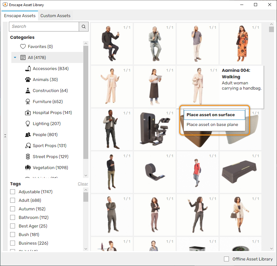

Rhino has two options to place assets: Place asset on surface – where you select the surface in Rhino before placing the asset. Place asset on base plane – which will place the asset on the base place (Construction or C-Plane). |
Initial asset placement in Rhino |
Using this option, open the Asset Library, click the menu next to the asset and choose Place asset on surface. Then, move the mouse into the Rhino viewport you want to use, choose the surface you want to place the asset on so that the surface is highlighted in yellow in the Rhino Viewport. In the active Rhino viewport, Rhino will indicate where the Asset can be placed with a small cross hair and the text box ‘OnSrf’ will appear in the Rhino Viewport next to that small cross hair. Left click to place the asset. As long as Live Updates is enabled, the asset will show instantly in the Enscape viewport. |
