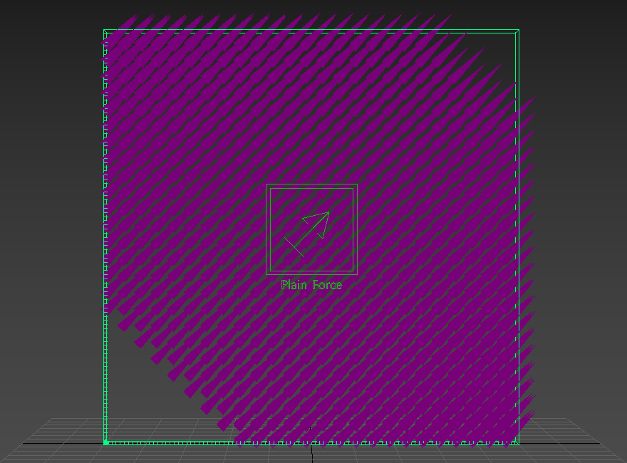

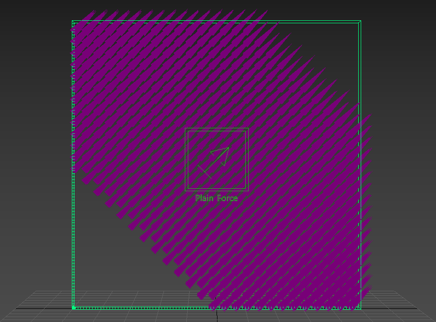

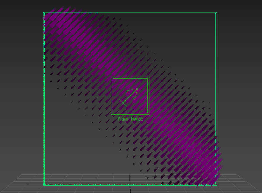

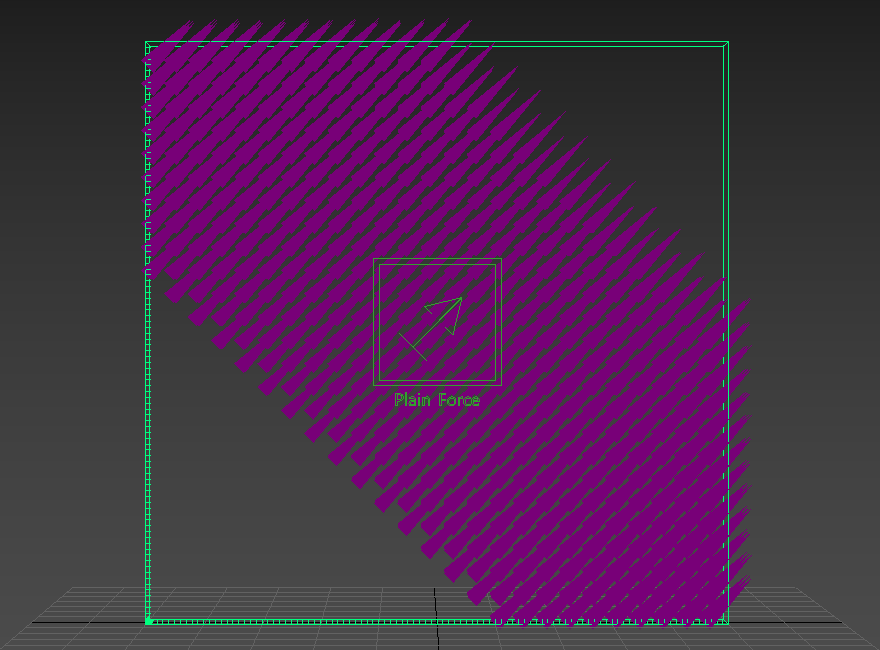

Strength | strength – Specifies the acceleration force measured in scene units/sec^2. Drag | drag – Specifies a value between 0 and 1 to determine how much of the existing velocity will be negated over a period of 1 second. The higher the drag, the more the fluid behavior is suppressed and the less the fluid features are pronounced. A value of 1.0 would completely stop the motion of the fluid. Max Distance | maxdist – Allows you to limit the effect of the force to a box centered around the helper icon. The box is oriented along the Plain Force's arrow and extends infinitely to the sides, while the thickness of the box is represented by the Max Distance option. In case Apply Force Behind Icon is enabled, then the box's thickness doubles as the force would be applied behind the helper icon as well. Here are the affected areas with Max Distance values of 30, 40, and 50 with a rotated Plain Force and enabled Apply Force Behind Icon option.
Max Distance set to 30.0 cm |
Max Distance set to 40.0 cm |
Max Distance set to 50.0 cm |
