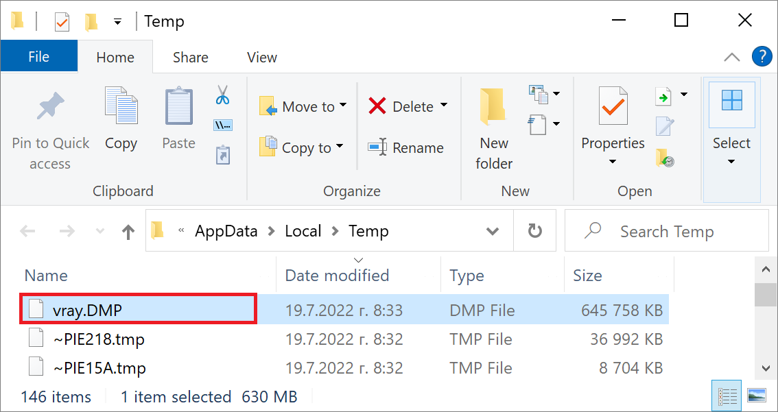

When the app crashes, a minidump file is automatically created in its designated folder. When using the app on Windows, the minidump file is stored in the %temp% folder by default.

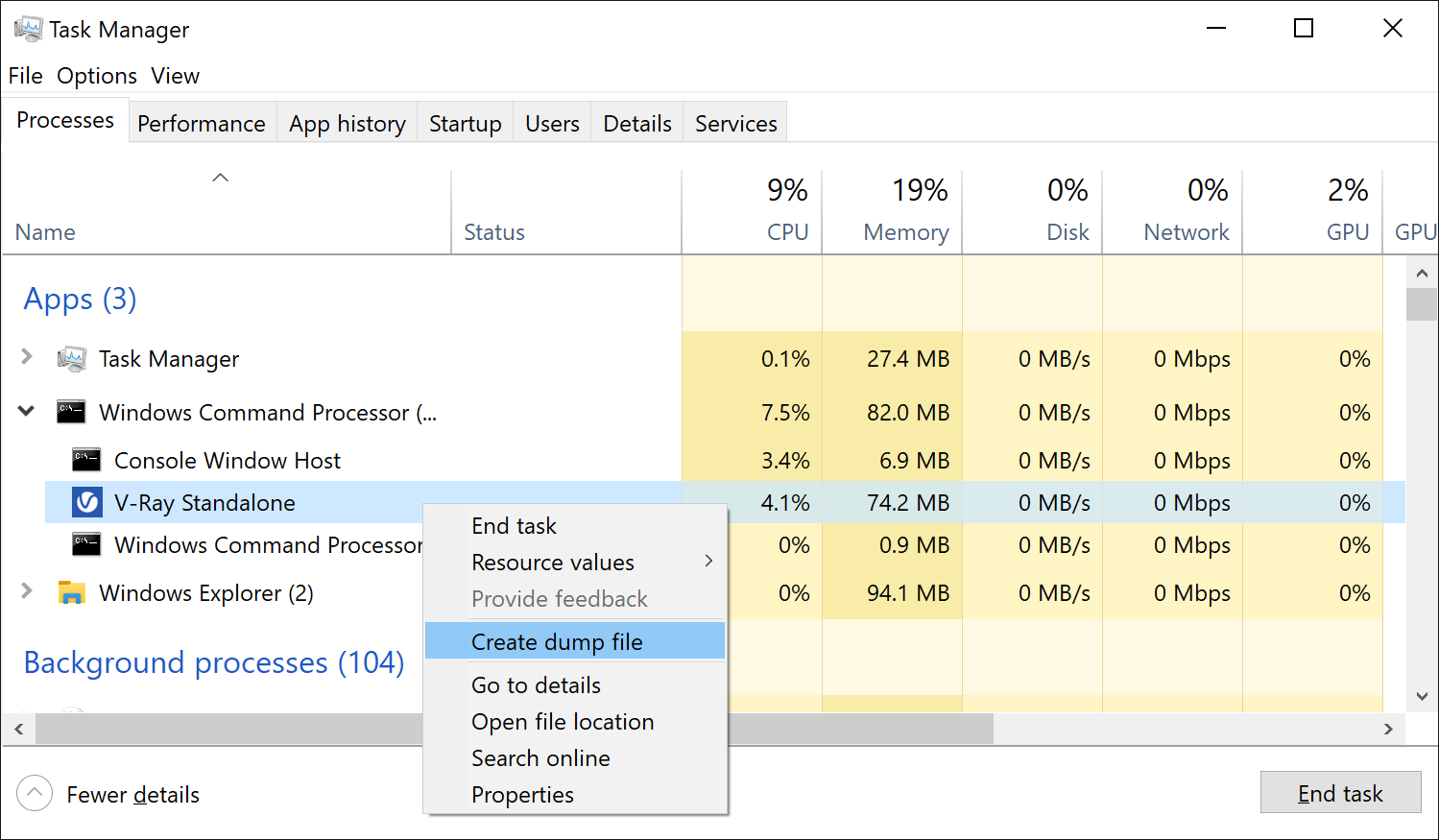

- Open the Windows Task Manager from the Start Menu.
- Right-click on the V-Ray application in the Processes tab to select the Create dump file option, while the V-Ray app displays the notification that unexpected error has occurred.
3. The crash dump file is created in the Temp folder.
