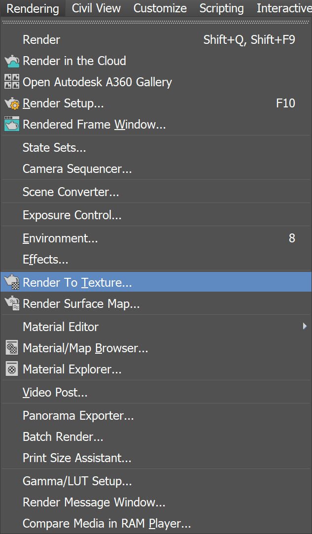

 Open the Render To Texture window from the drop-down or by pressing zero.
 Click Add to choose a render element, and scroll through the list that appears to find VRayMtlReflectHighlightGlossiness.
Select the appropriate Width and Height. Under Mapping Coordinates be sure to select Use Existing Channel if the object already has UV Mapping applied.
Select the three dots next to File Name and Type to select an output location before clicking Render to begin baking.
