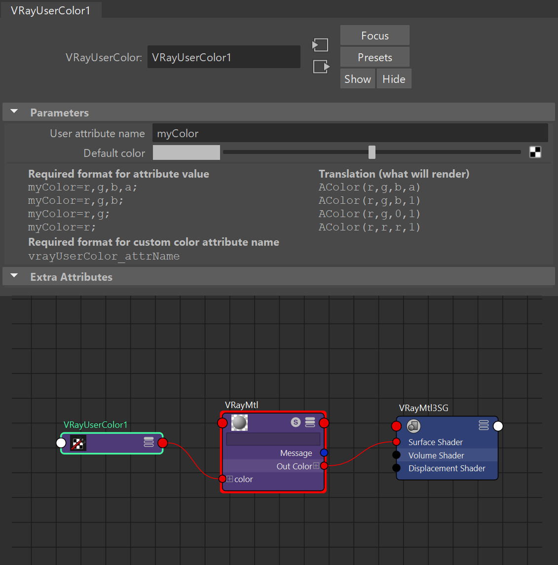

User attribute name – Specifies the name of the user attribute that is looked up and returned from this shading node. Default color – Specifies the color to return if the user attribute is not found on the shaded object. Required format for attribute name – Displays possible formats for the attribute in the V-Ray User Attributes string assigned to the object and what is rendered as a result. |

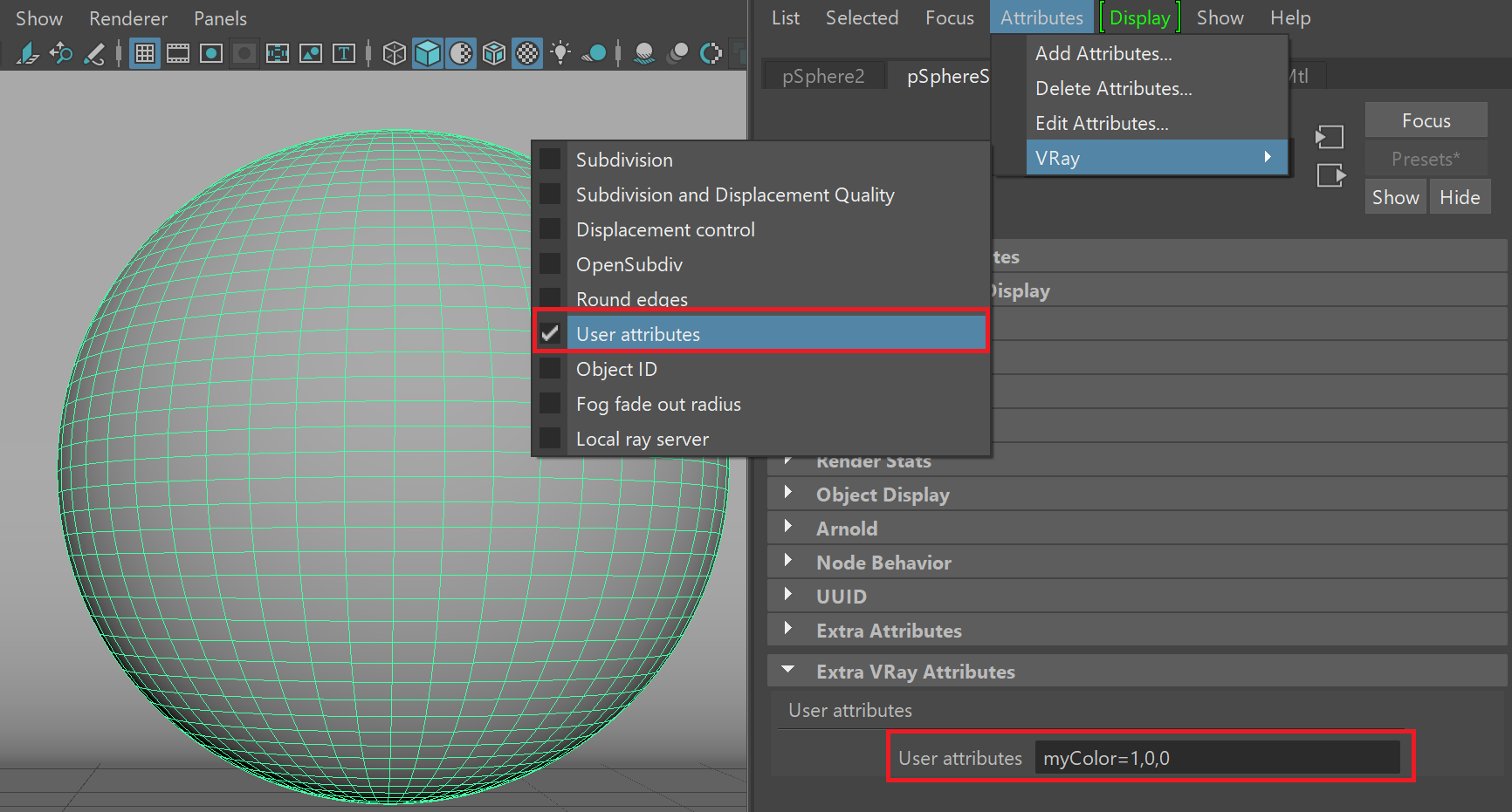

User attributes can be added though the Attributes > VRay > User attributes menu.

User attribute for the first object |
User attribute for the second object |

Assign a VRayMtl to the object. Link a VRayUserColor's оutColor to the VRayMtl Diffuse Color input. Assign myColor as the User attribute name in VRayUserColor. Note that the vrayUserColor_ prefix is not needed here. |
