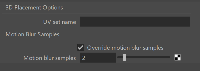

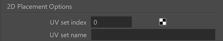

2D Placement and 3D Placement Options
Placement OptionsUV set index – Specifies a UV set index to be used. If a UV set name is specified, it is used instead. -1 (negative one) is a special index value that links against the first UV set found for a mesh. UV set name – The name of the UV set to be used. Motion Blur Samples Options (available only for 3D Placement)Override motion blur samples – Overrides the count of motion blur samples. Motion blur samples – Specifies the motion blur samples. Expression Editor icon ( ) – Opens the Expression Editor.
Add to node: vray addAttributesFromGroup place2dTexture1 vray_2d_placement_options 1; Remove from node: vray addAttributesFromGroup place2dTexture1 vray_2d_placement_options 0; Attributes: vrayUVSetName Example: setAttr -type "string" place2dTexture1.vrayUVSetName "uvSet1"; |
Add to node: vray addAttributesFromGroup place3dTexture1 vray_3d_placement_options 1; Remove from node: vray addAttributesFromGroup place3dTexture1 vray_3d_placement_options 0; Attributes: vrayUVSetName3D Example: setAttr -type "string" place2dTexture1.vrayUVSetName3D "uvSet1"; |
