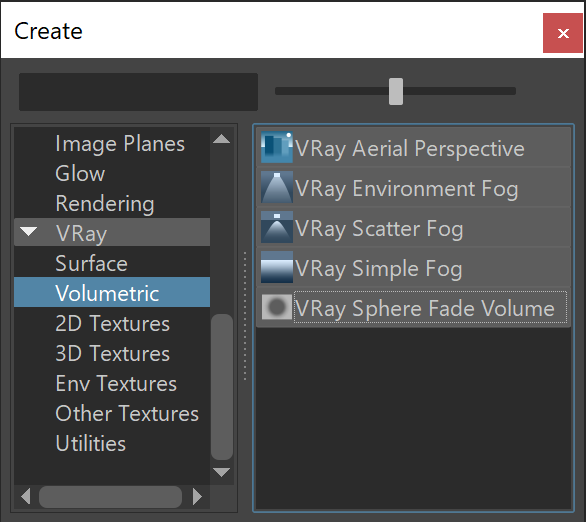

||Hypershade|| > Create panel > VRay section > Volumetric > VRay Sphere Fade Volume

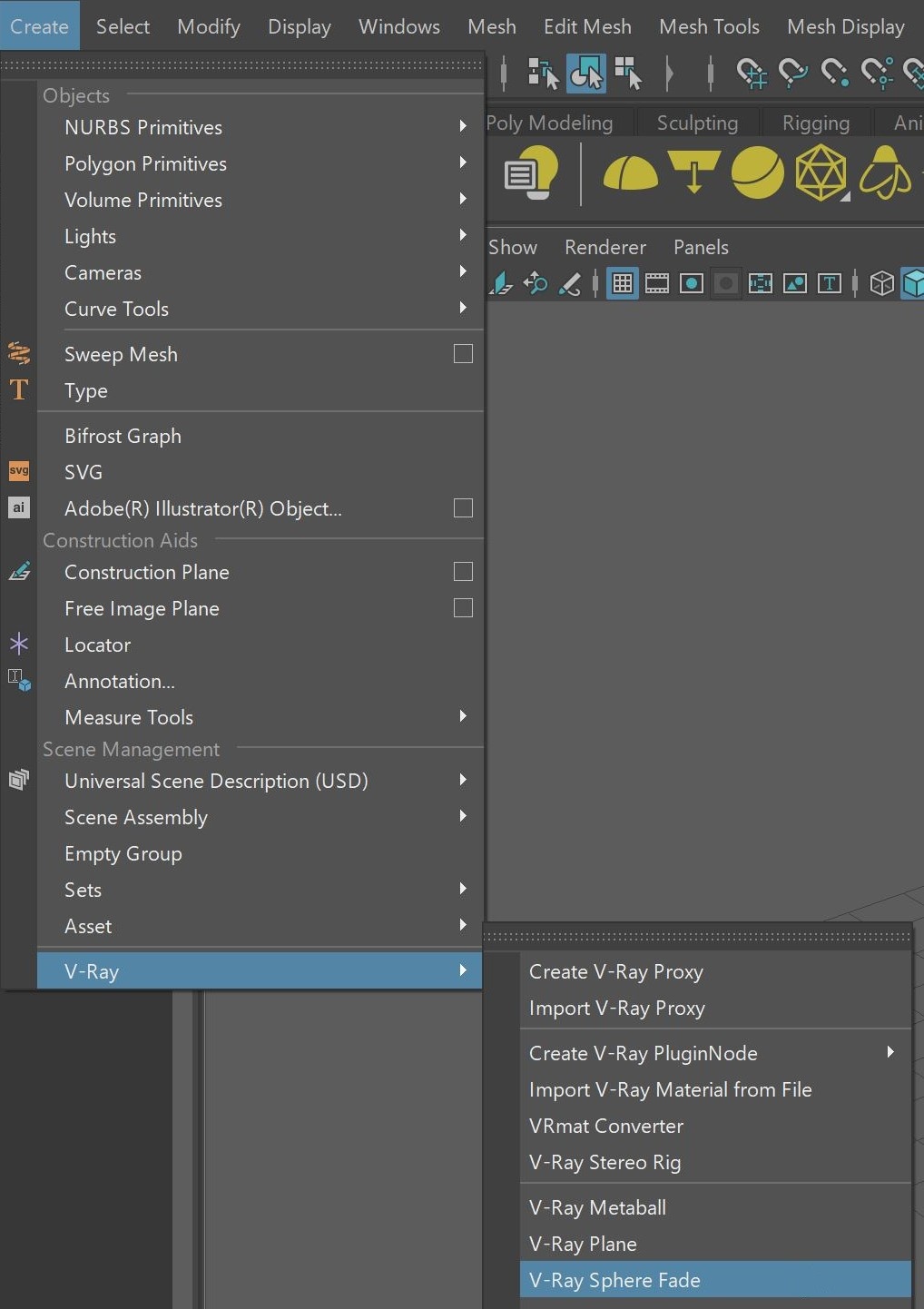

||Create menu|| > V-Ray > Create VRaySphereFade
