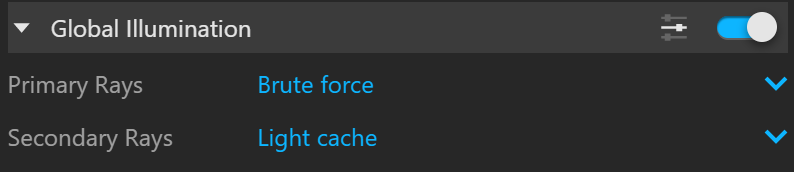

Enabled – Turns indirect illumination on and off.
Primary Rays – Specifies the GI method to use for primary diffuse bounces.
Irradiance map (deprecated) – Causes V-Ray to use an irradiance map for primary diffuse bounces. See the Irradiance Map Settings section for more information. This is a legacy option that will be removed in the future.

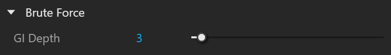

Brute force – Specifies direct computation for primary diffuse bounces. See the Brute Force Settings section for more information.
Light cache – Specifies the light cache for primary diffuse bounces. See the Light Cache Settings section for more information.
Secondary Rays – Specifies the GI method to use for secondary diffuse bounces.
None – No secondary bounces are computed. Use this option to produce skylit images without indirect color bleeding.
Brute force – Specifies direct computation for secondary diffuse bounces. See the Brute Force Settings section for more information.
Light cache – Specifies the light cache for secondary diffuse bounces. See the Light Cache Settings section for more information.

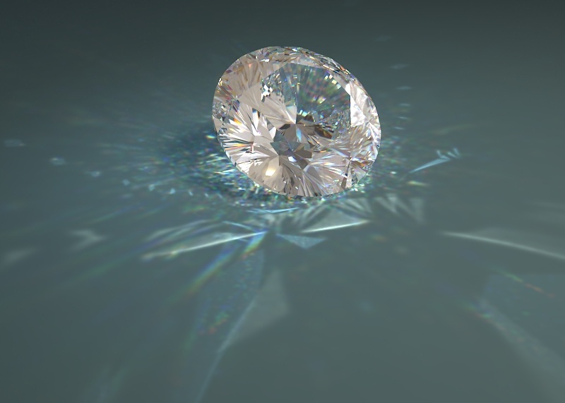

Caustics
V-Ray supports the rendering of caustics effects by using one of the following techniques: photon mapping or progressive.
The new Progressive caustics solver uses advanced sampling techniques, and is able to trace as many photons as required without suffering the memory constraints of traditional Photon Mapping techniques.
It is loosely based on two papers: one on Progressive Photon Mapping from Knaus and Zwicker, and another on Metropolis-guided caustics tracing from Šik and Krivánek.
The other method, Photon Mapping, is a two-pass technique.
The first pass consists of shooting light particles (photons) from the light sources in the scene, tracing them as they bounce around the scene, and recording the places where the photons hit the object surfaces.
The second pass is the final rendering, which is when the caustics are calculated by using density estimation techniques on the photon hits stored during the first pass.

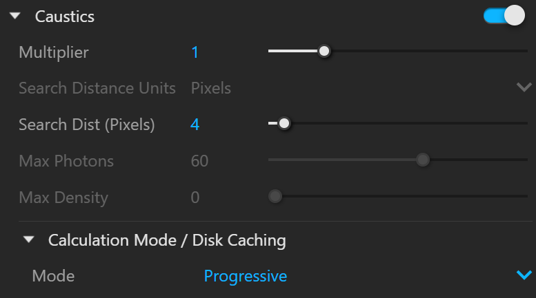

Caustics – Enables or disables rendering of caustics.
Progressive Caustics
Multiplier – Controls the strength of the caustics. It is global and applies to all light sources that generate caustics. Should a different multipliers for each light source be needed, the V-Ray properties of each light should be edited. Note: this multiplier is cumulative with the multipliers in the local light settings.
It should also be noted that changing multipliers, while useful for artistic purposes, will result in physically-inaccurate scenes.
Search Dist (Pixels) – Specifies the initial photon lookup radius in pixels. The Progressive mode works only in Pixels.

  • It is strongly recommended to set time limit when rendering with Progressive Caustics, rather than relying on Noise Threshold value only.
  • Lower the Shading Rate.
    Photons are cast for each camera ray, not for the secondary ones. The more camera rays are cast, the more photon passes are achieved.
    A value of 3 is fine if rendering with the rest of the scene, but a value of 1 could be used if rendering specific caustic passes (for example, a caustics pass scene prepared with the purpose of maximizing caustics' calculation speeds).

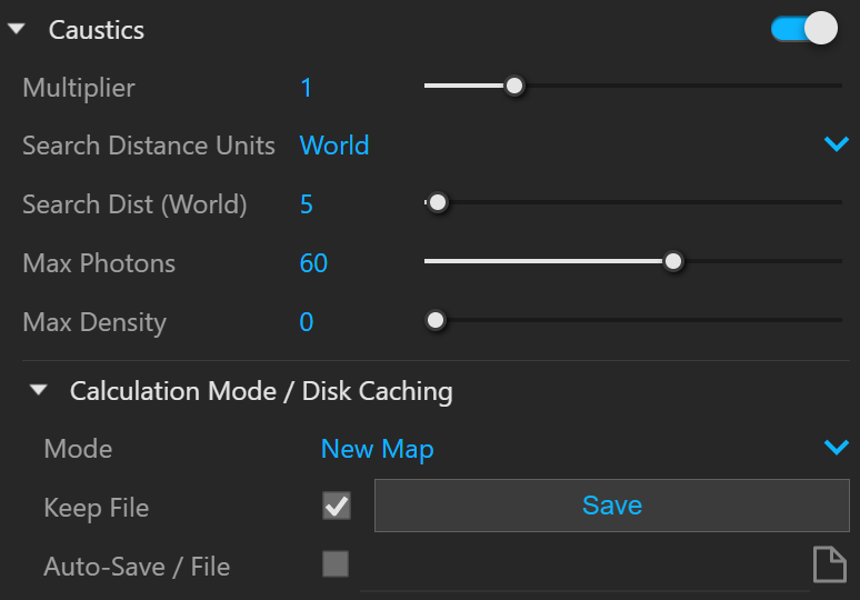

Photon Map Caustics
Multiplier – Controls the strength of the caustics. This parameter is global and applies to all light sources that generate caustics.
Search Distance Units – Determines in what units the Search distance parameter is specified - World units or Pixels.
Search Dist (World)/(Pixels) – When V-Ray renders the caustics effect at a given surface point, it searches for a number of photons on that surface in the area surrounding the shaded point (search area). The search area in fact is a circle with center the original photon and its radius is equal to the Search distance value. Smaller values produce sharper, but perhaps more noisy caustics; larger values produce smoother, but blurrier caustics.
Max Photons – Specifies the maximum number of photons that is considered when rendering the caustics effect on a surface. Smaller values cause fewer photons to be used and the caustics are sharper, but noisier. Larger values produce smoother, but blurrier caustics. The special value of 0 means that V-Ray uses all the photons that it can find inside the search area.
Max Density – Limits the resolution (and thus the memory) of the caustics photon map. Whenever V-Ray needs to store a new photon in the caustics photon map, it first checks if there are any other photons within a distance specified by Max density. If there is already a suitable photon in the map, V-Ray just adds the energy of the new photon to the one in the map. Otherwise, V-Ray stores the new photon in the photon map. Using this options allows you to shoot many photons (and thus get smoother results) while keeping the size of the caustics photon map manageable. This option is not supported by V-Ray GPU.
Calculation Mode/Disk Caching
Mode – Controls the mode of the irradiance map:
New map – When enabled, a new photon map will be generated. It will overwrite any previous photon map left over from previous rendering.
From file – When enabled, V-Ray will not compute the photon map but will load it from a file. Press the Browse button on the right to specify the file name.
Progressive – Uses advanced sampling techniques and is able to trace as many photons as required without suffering the memory constraints of traditional Photon Mapping techniques.
Keep File – When enabled V-Ray keeps the photon map in memory after the scene rendering has finished. When disabled, the map is deleted and the memory it took is freed. Enabling this option can be especially useful if you want to compute the photon map for a particular scene only once and then re-use it for further rendering.
Auto-Save File – When enabled, V-Ray automatically saves the caustics photon map to the provided file when rendering is completed. Specifies the file location where the caustics photon map will be saved after rendering.

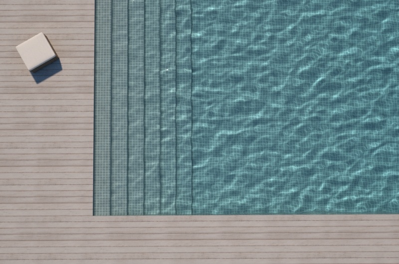

The first image to the right is rendered with the Light cache for both primary and secondary bounces, Fixed Filter type for the light cache, and Store direct light off. The second image in the center is rendered with the same light cache settings, but with global ambient occlusion enabled. The third image to the right is rendered without ambient occlusion, with Brute force GI engine for primary bounces, and the Light cache as a secondary engine with Nearest  Filter type. The render times include the time for calculating the light cache. Note how ambient occlusion can produce a feeling of a more detailed image, even though the result is not entirely correct.
Ambient occlusion is off - lighting is good, but there is a lack of detail
Ambient occlusion is on - details are much more defined
Brute force GI, no ambient occlusion - details are fine, but render times is longer.

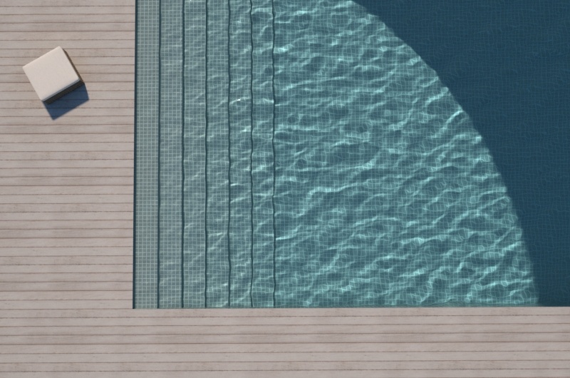

Progressive and Photon Map Caustics Examples
The example illustrates the Caustics parameters of the Progressive and Photon map caustics methods. The lights used in the scene are two V-Ray Spot Lights with different intensities and temperature. The scene is in millimeters.
